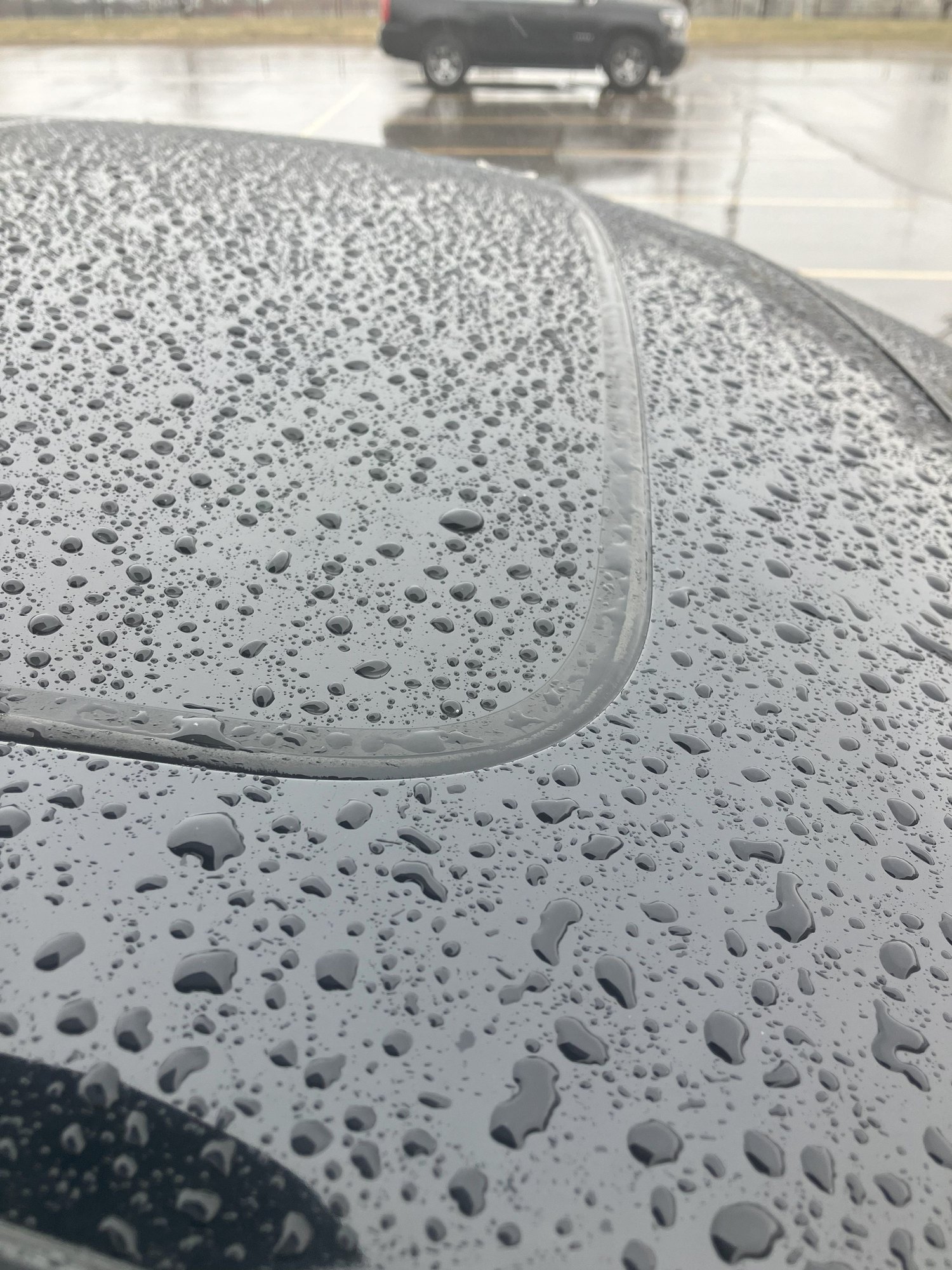

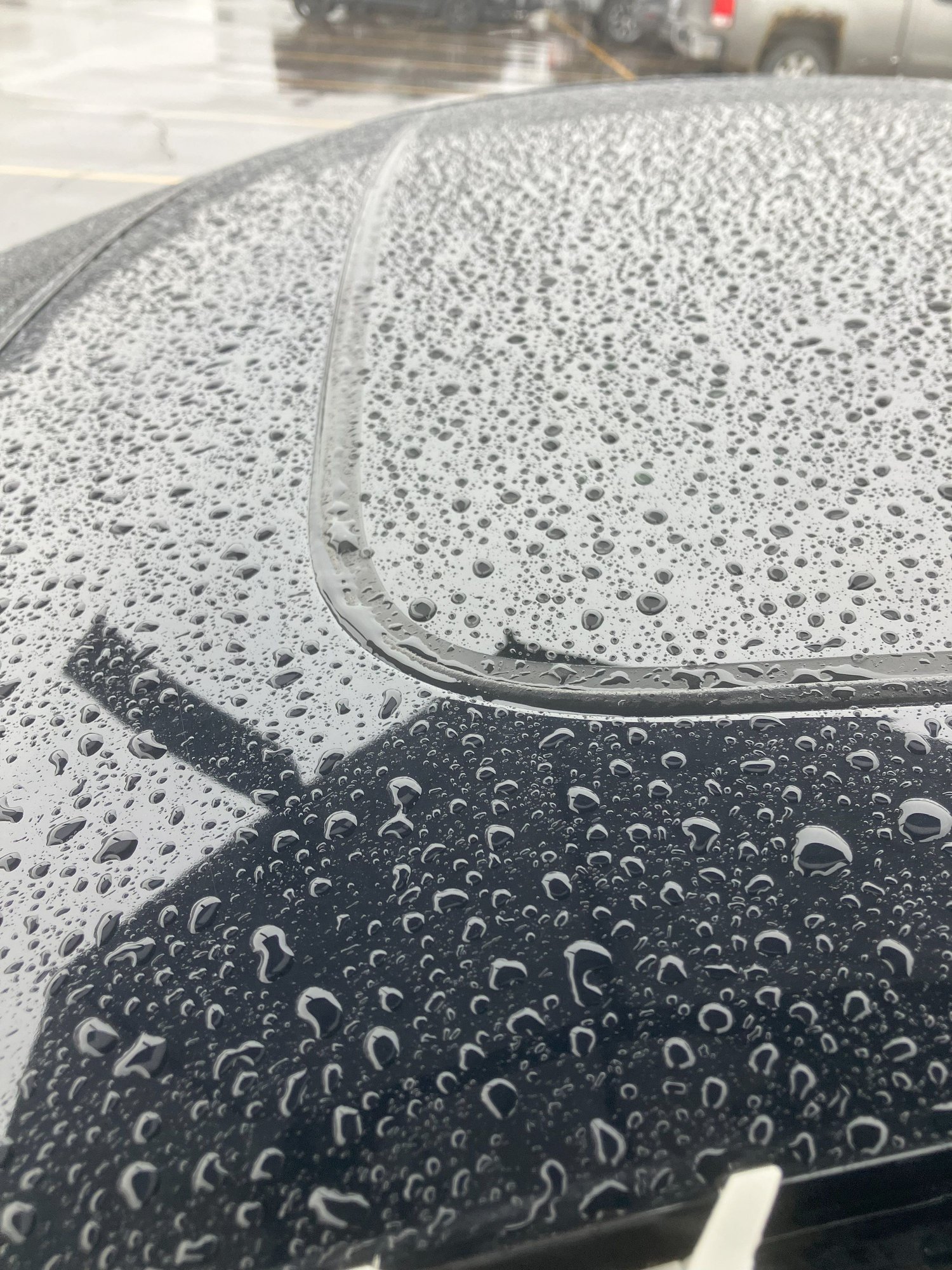

Yeah I thought about putting duck tape around the entire gasket of the sunroof itself before another rainy day. Another step was taking a small scrubber that can go into the drain hole and push it down with some welding rod
Driver side front
Driver side front
Passenger side front

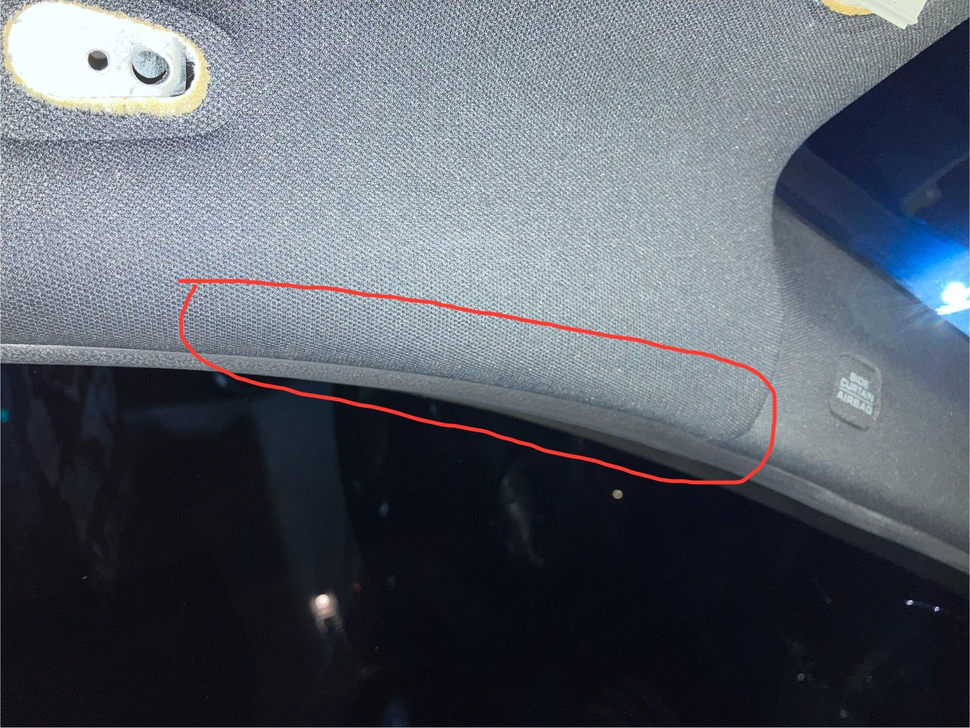

It would start essentially just below the grab handle as shown in the picture and stop at the crease where the headliner and A-pillar butt up to each other.
