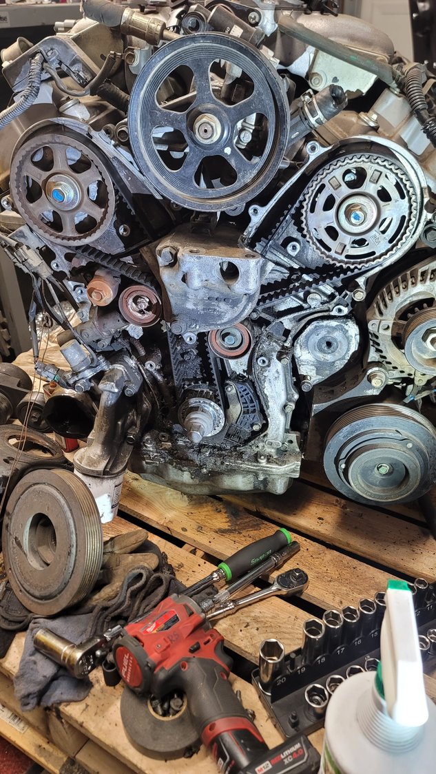

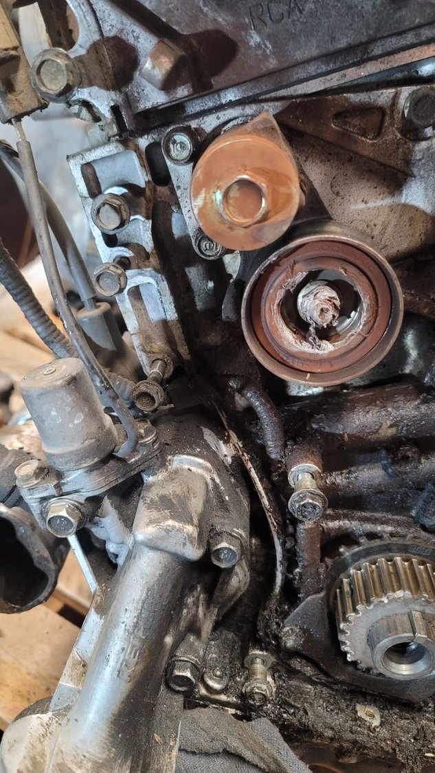

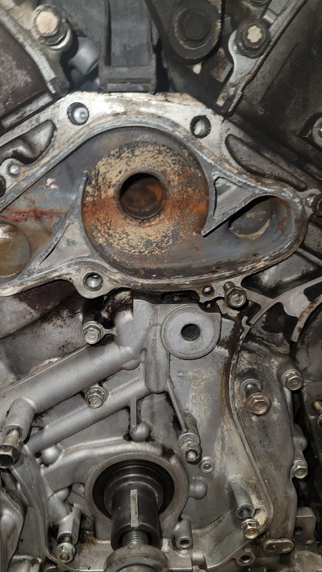

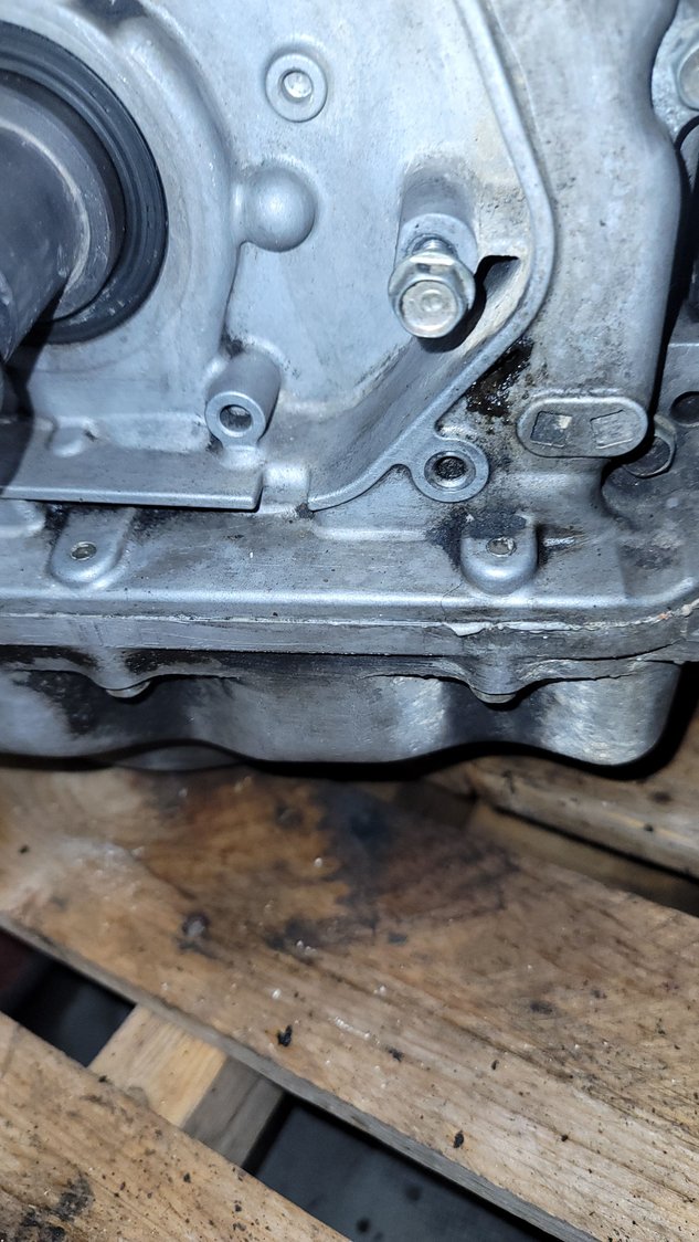

So I'm finally getting around to the swap but some things are worrying me as I dig into the engine to oil pump reseal, mains seals,and do tb/ wp. Behind the lower timing belt cover there was excessive sludge buildup and there was black permatex in a few spots around the timing cover notches/oil pan mating surface and around the head of a bolt on the lower rear block area.. What could cause sludge buildup and was the silicon just to try to hold back the oil from failed front crank seal? Finally peeled off the water pump to find nothing but water in it and the prop on the pump was rusted pretty good. Compression tested great when I bought it. Plugs looked very good and oil had just been changed before the dono
r car was wrecked. Am I wasting my time with this donor engine.

That thing has only 115k miles on it? Do the camshaft seals for sure. Looks like somebody was driving with oil leak for a pretty long time. My engine was leaking for oil pump for ~25k miles and couple years before I got motivated enough to fix it and it didn't look as bad.

Posts: 48,326
Likes: 9,181
Damn, that engine has seen better days... Is it just surface rust behind the water pump? I'm hesitant to suggest just taking a wire wheel to it..
