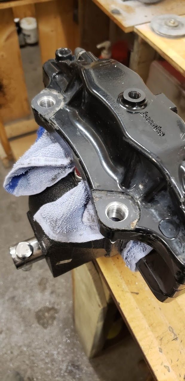

Threads replaced with timeserts. Ready for sanding and paint!

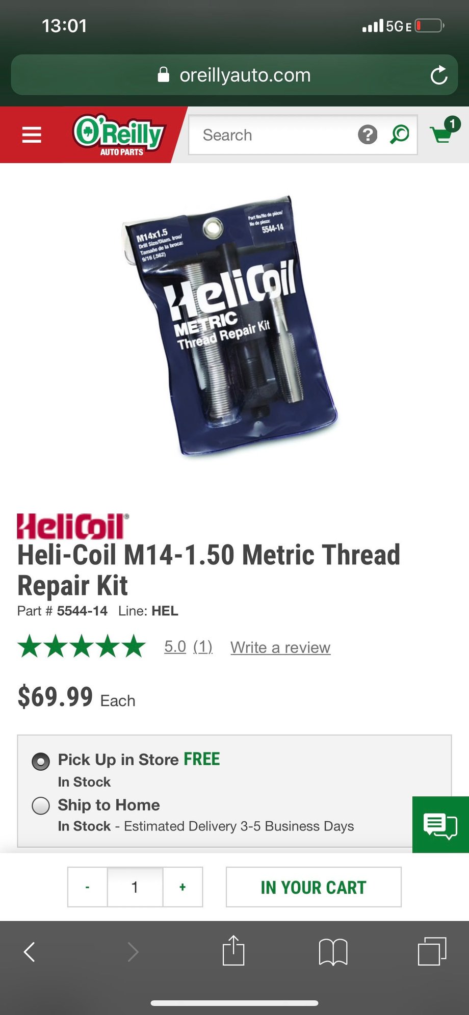

i will go timesert, but I don’t have place to service it and the kit cost 127.

if anyone has m14x1.5 timesert kit, im willing to buy

Here's a few kits for around half that
Amazon Amazon
https://www.threadtoolsupply.com/m14...epair-kit.html
https://www.threadtoolsupply.com/M14...epair-kit.html
https://www.threadtoolsupply.com/m14...air-m-kit.html (need tap and drill bit)
Before you order a kit make sure you measure the thread depth the inserts are generally sold in increments of 1/2 thread diameter or 6mm in your case. I think the helicoil kits are generally 1.5D but I'd definitely look it up before ordering if you go that route.
