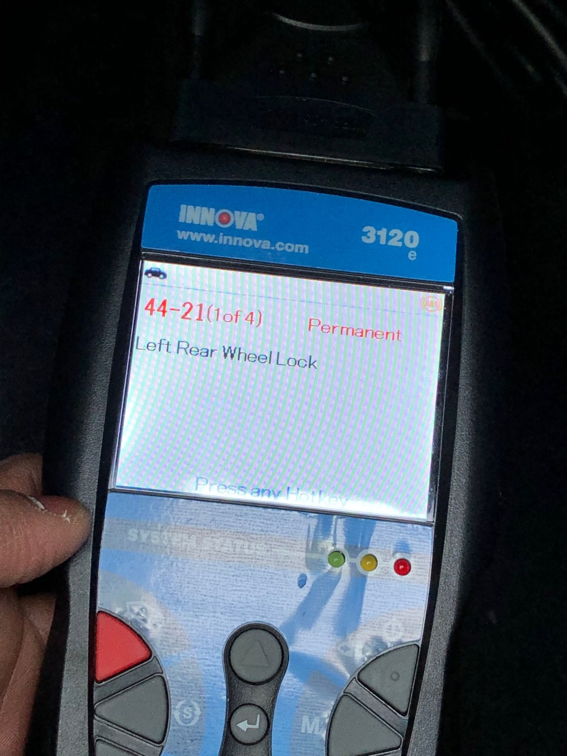

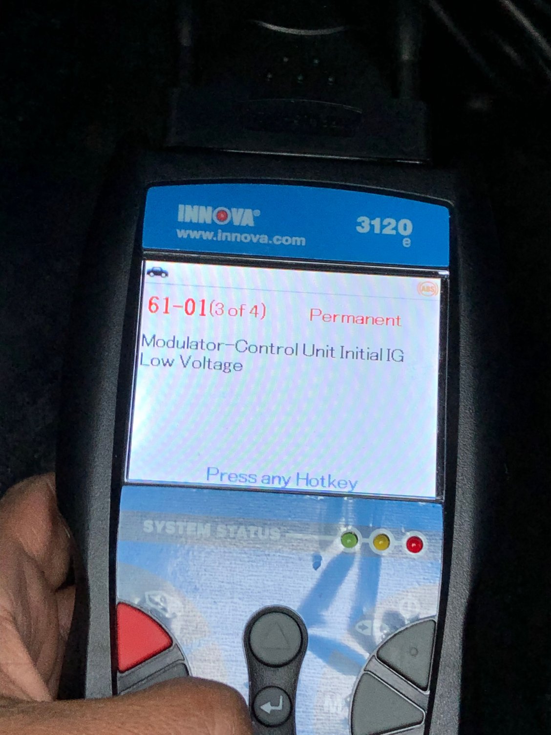

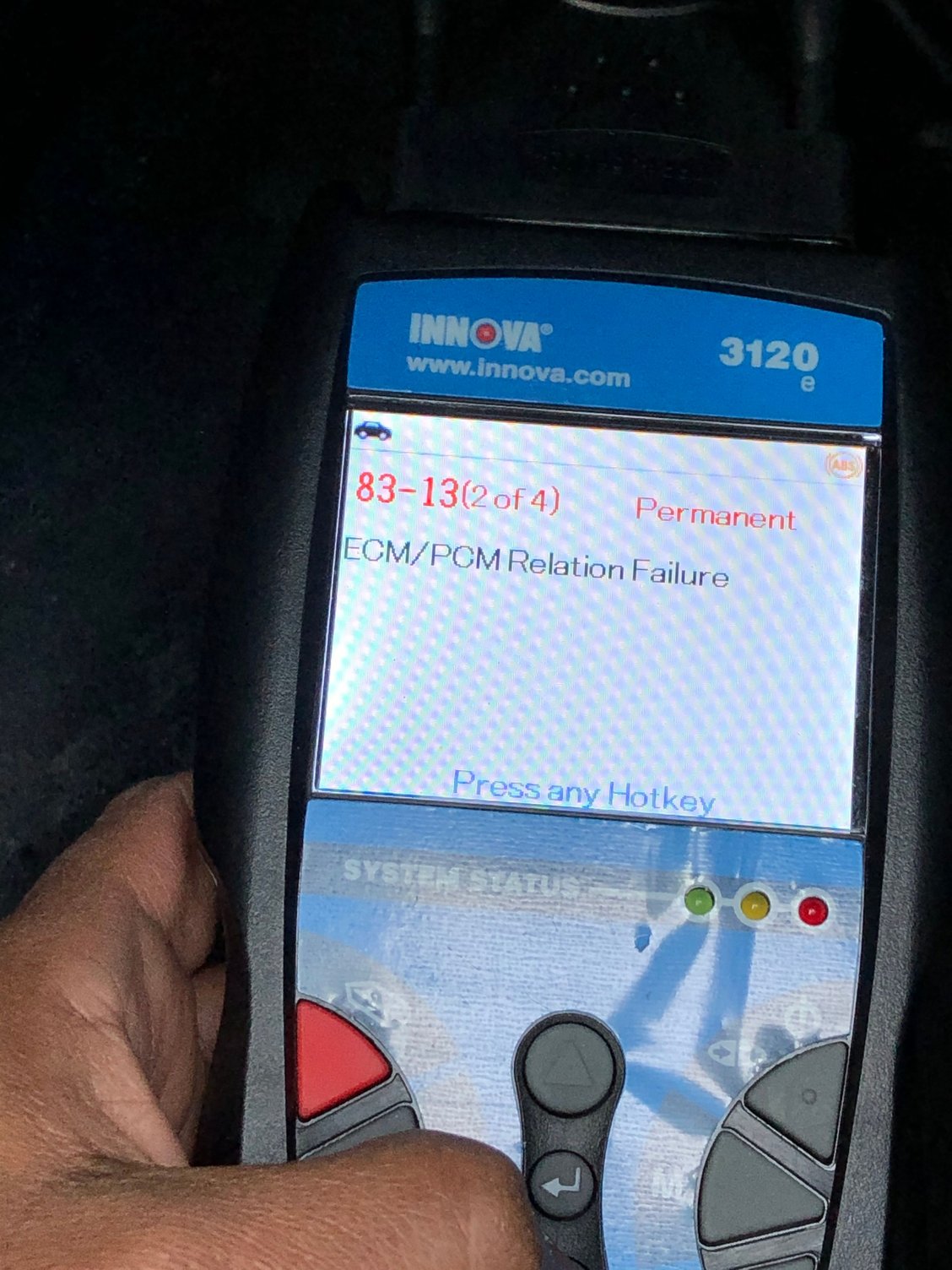

The other day while driving, vsa and ABS Lights popped up, then the car went into a deep struggle mode, not limp mode, worse than that. It lasted about 10 minutes then disappeared on its own.
I checked voltage at battery(2 different set of multimeters) and got good numbers, alternator monitor via obd2 pro scanner also reported everything to the alternator to be ok. But it reports battery as low voltage(11.82v), hows that so? Some bad wiring somewhere? No codes are stored in the ecu except for the following abs/dtc codes:
44-21: Left rear wheel lock(permanent)
83-13: ECM/PCM Relation failure(Permanent)
61-01: Modulator - Control Unit Initial IG Low voltage(permanent)
61-22: Modulator - Control Unit power source Low voltage(permanent)
ive always used the cheap obd2 scanner so didn’t even know there were some codes(dtc) not accessible unless you had a pro version. So I don’t know how long these codes have been there. I assume there’s some relationship to the failure I’ve seen and the codes. Any tips on where to start? Do I just go and swap out all the failures or is there some dependency here that’s causing these failures?

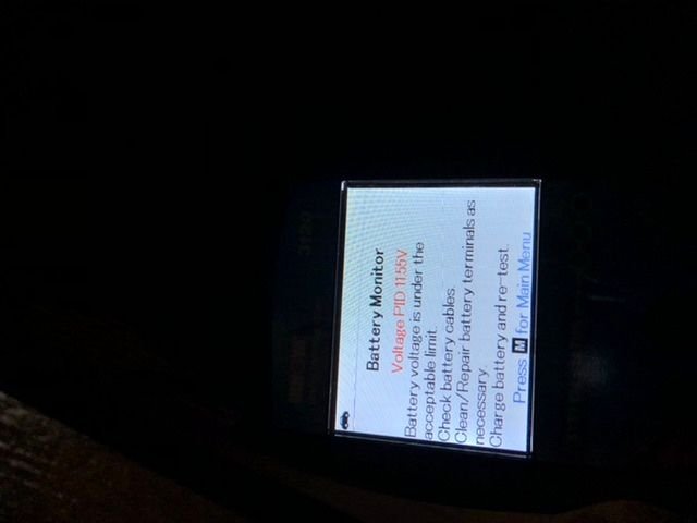

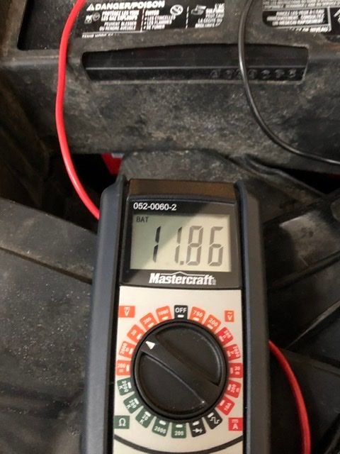

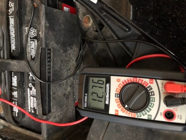

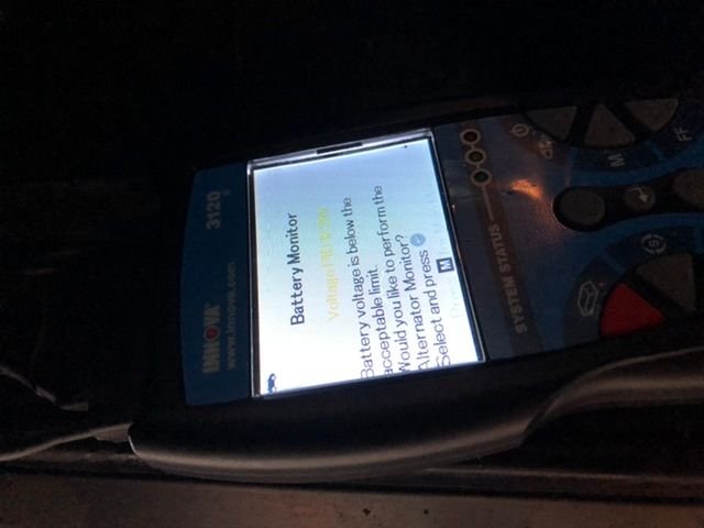

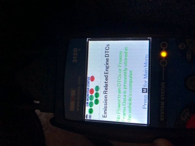

cables are clean at battery posts. Took some more pics. I disconnected my dashcam that was connected to the cigarette lighter port in the arm rest after my drive. That can’t draw power when car is off right? I also cleared the abs codes, hasn’t come back up yet. Will continue to monitor the situation. Btw I didn’t know how to check the power at the main fuse box. Do I have to go under the box or something?
Key is not in ignition
Ignition on position II for obd2 scanner
After a 10 min drive

I don't think it's either of those. Battery voltage while car is running = 15.25V. During start-up, it never dipped below 10.85V. Alternator test as per obd2 scanner passed w/o any issues either. I'm wondering if my dashcam could've been flakey and started eating up my power like the HLF module, but doubt that the cigarette port is even active after car shuts off...

Your battery is reading 12.8V then 11.8V after key on?
Edit: your getting 15.25V running? That is too high and may have damaged your battery. Voltage regulator may be bad and now you need to test the alternator and then most likely a new battery.
Old Jan 22, 2020 | 03:41 PM
jeeva86's Avatar
'08 TL-S 6MT
Joined: Dec 2010
Posts: 319
From: Ottawa
yea, 12.8V ish when car was off, but at times i seen it as low as 12.25 as well, so it seems to be a bit random, is that normal? 11.8V with key in on position, but not engine running, obd2 scanner picks up battery voltage at 11.55 ish at that time. Everything seems to be running ok though since Sunday, no codes, no sluggish-ness. It's a costco battery, so I can swap it out w/o issues, but want to be certain before I go through that hassle in this cold!
