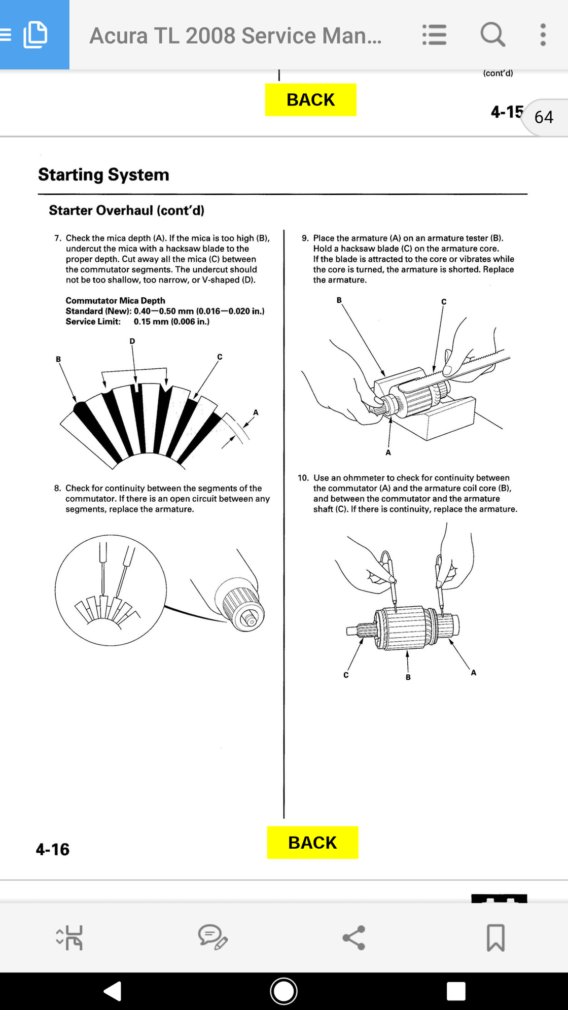

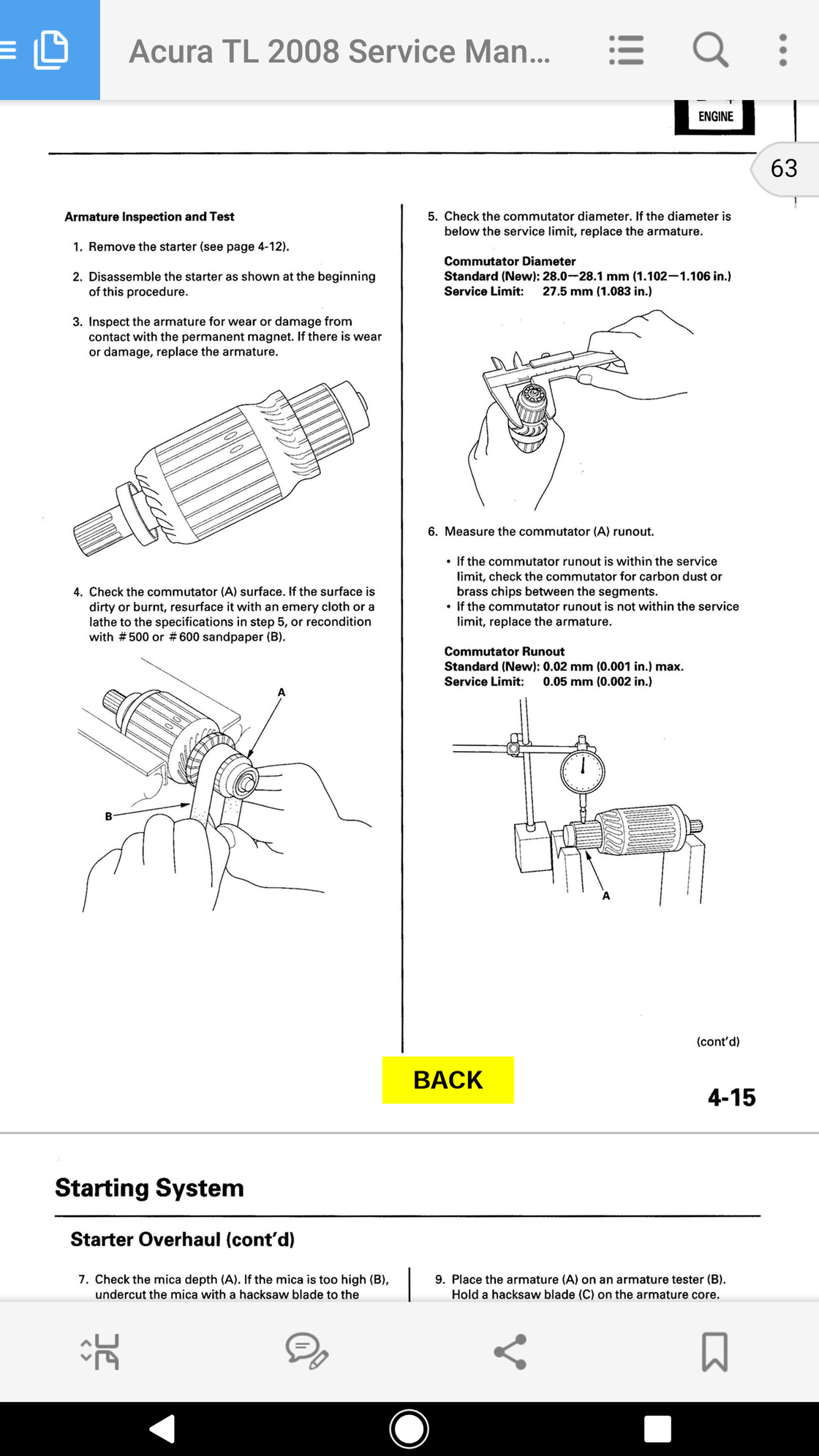

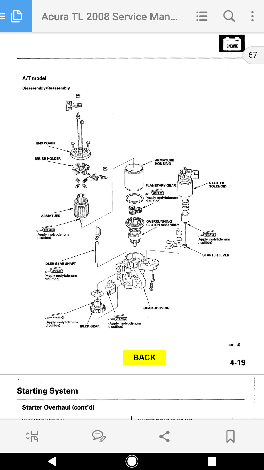

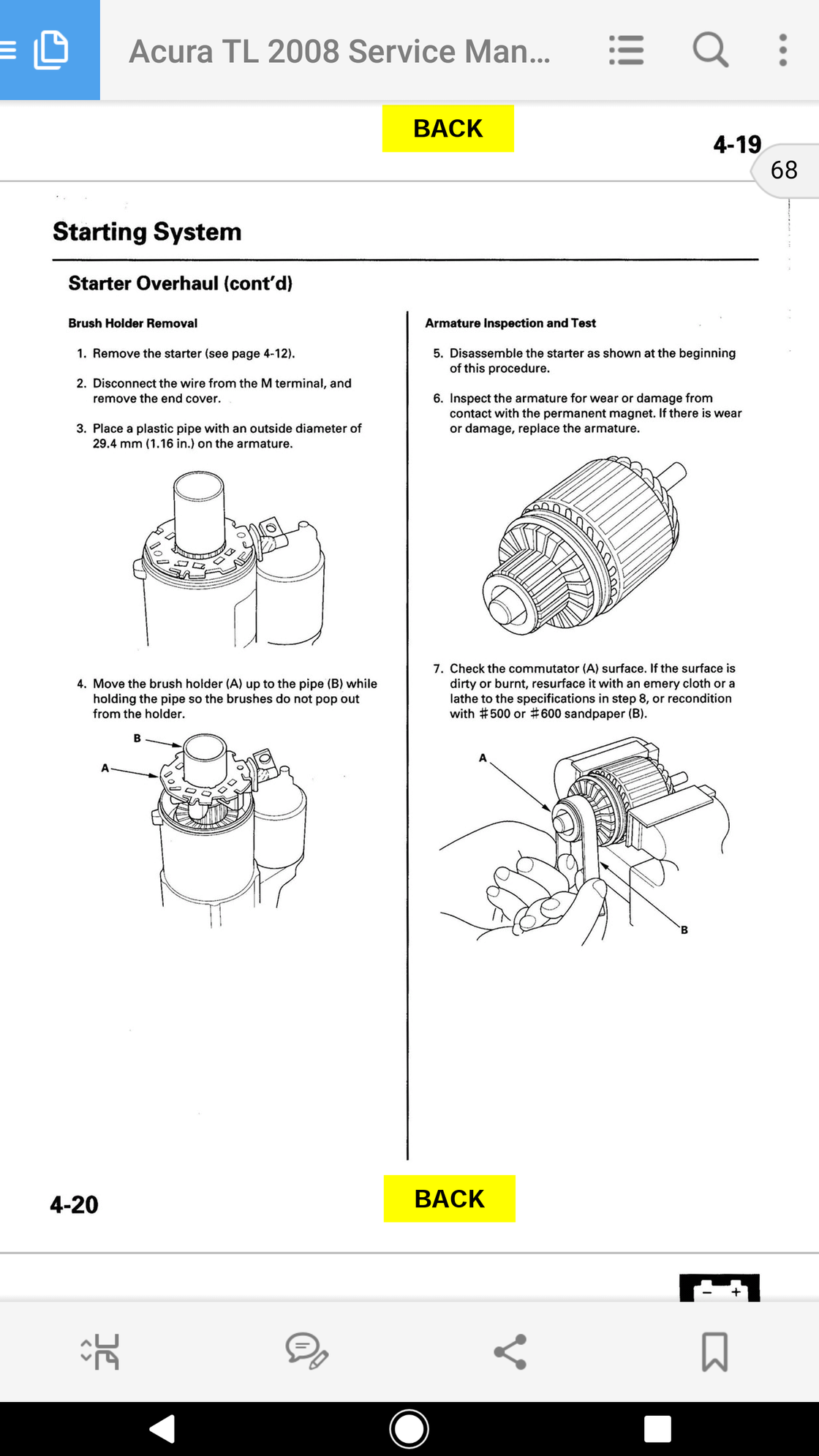

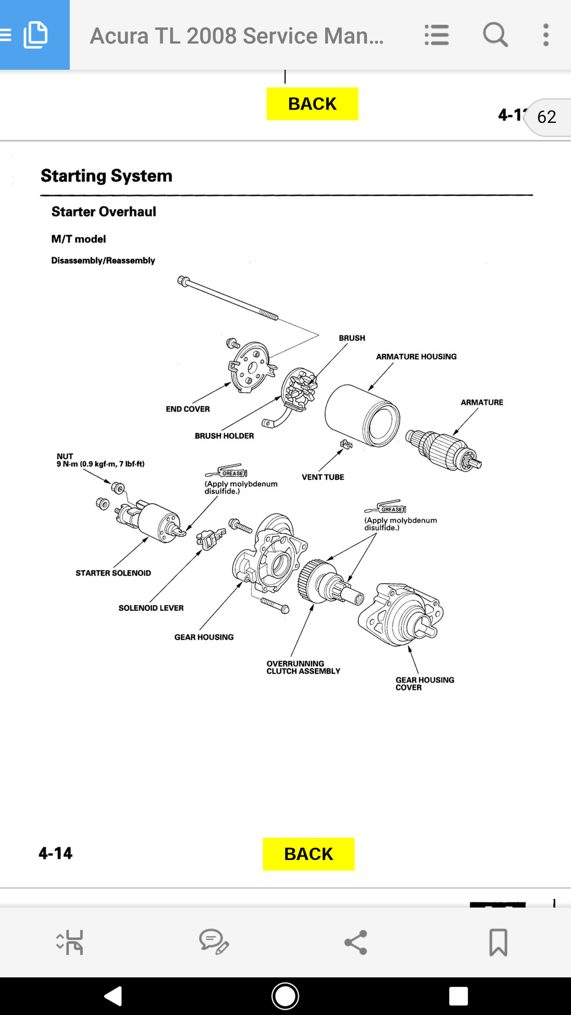

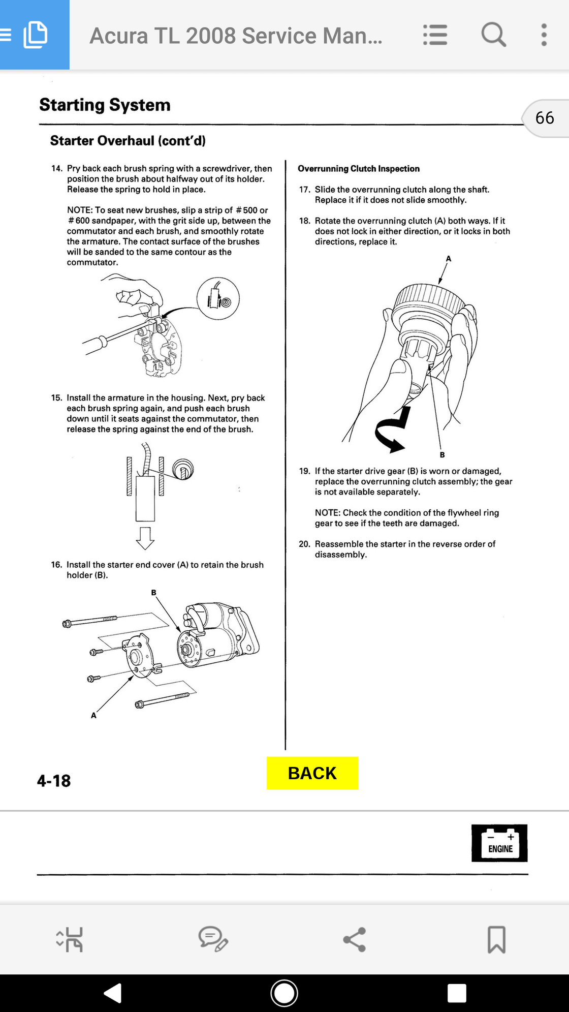

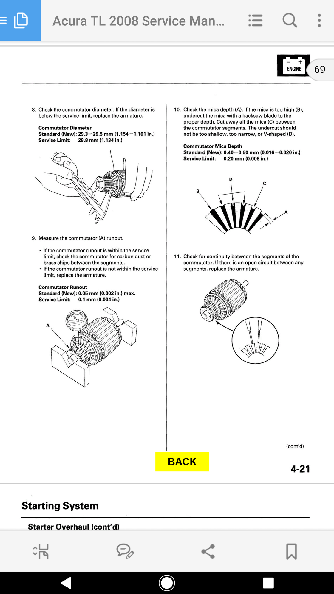

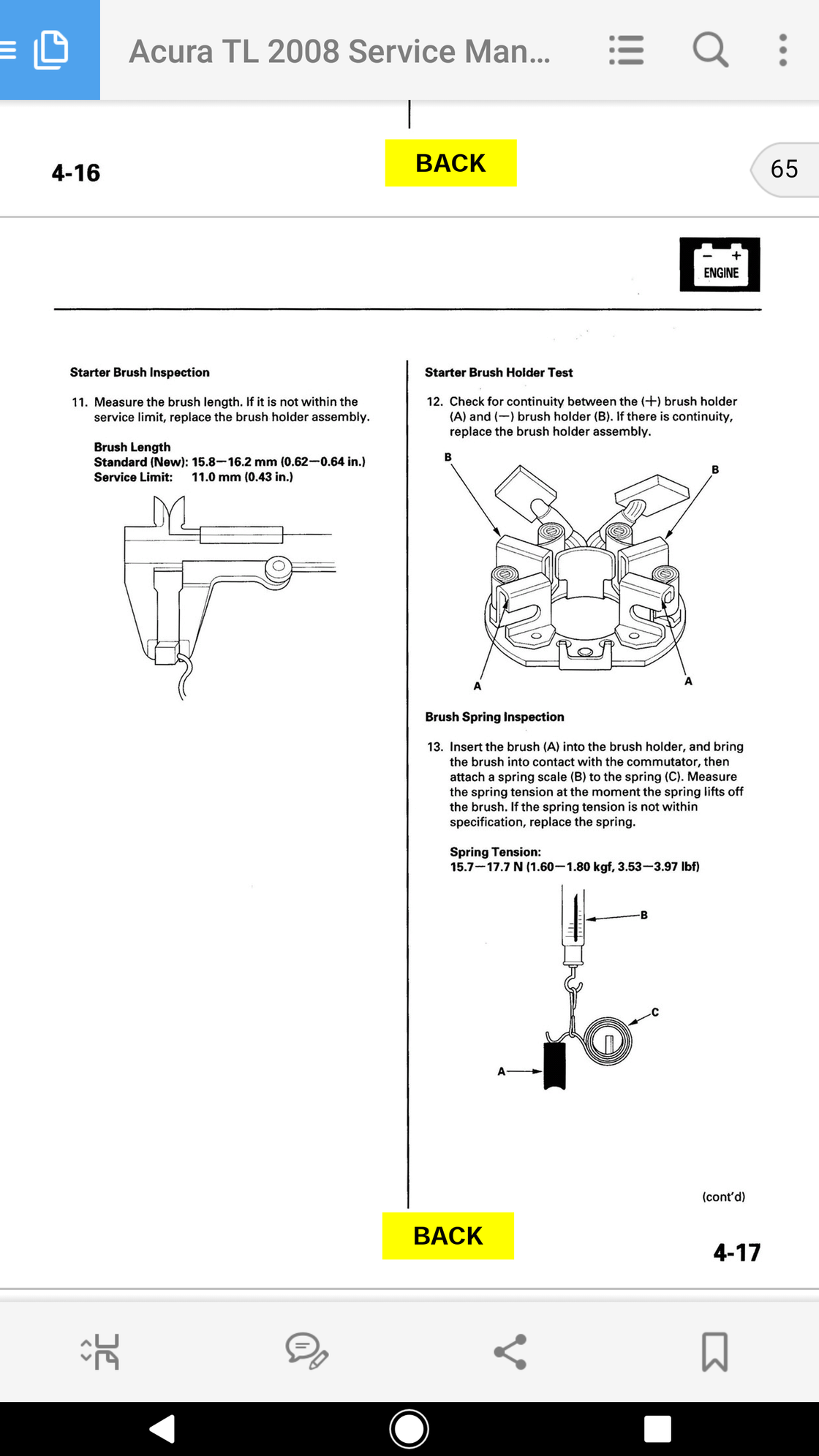

That's what I found in the manual, one if for MT, one for AT
Spoiler

Wow, that's awesome! Looks like I'm stuck at removing the armature housing, there seems to be nothing holding it, and yet it wouldn't budge.
