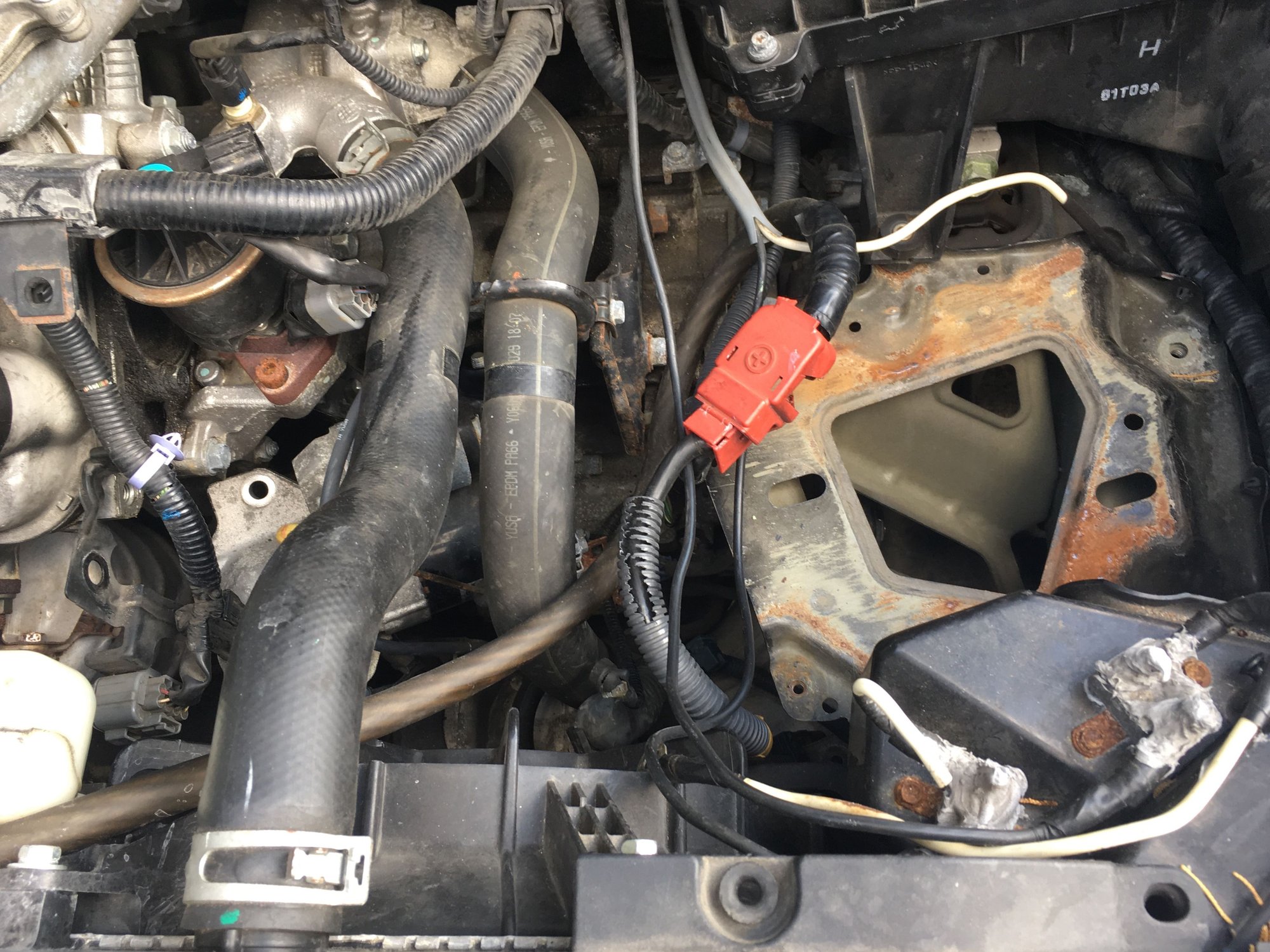

Remove battery negative cable.
Remove battery.
Locate the starter and clean the area around the opening. I don't think it matters a lot but I got some dirt fallen in when I was pulling the starter and that's when I realized ohhhh.....

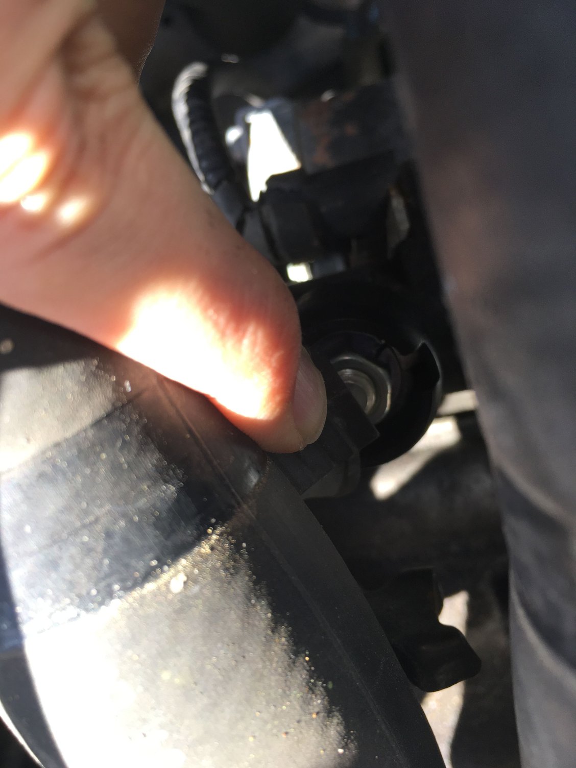

Once battery is out of the way, remove this clip. I lifted the thin tab toward right(in the picture), out of the notch. Clip A in service manual.
How I used a flathead to pry the clip out the rusted steel mounting bracket out toward the driver side of the car. I had one hand holding the locking tab up while prying.

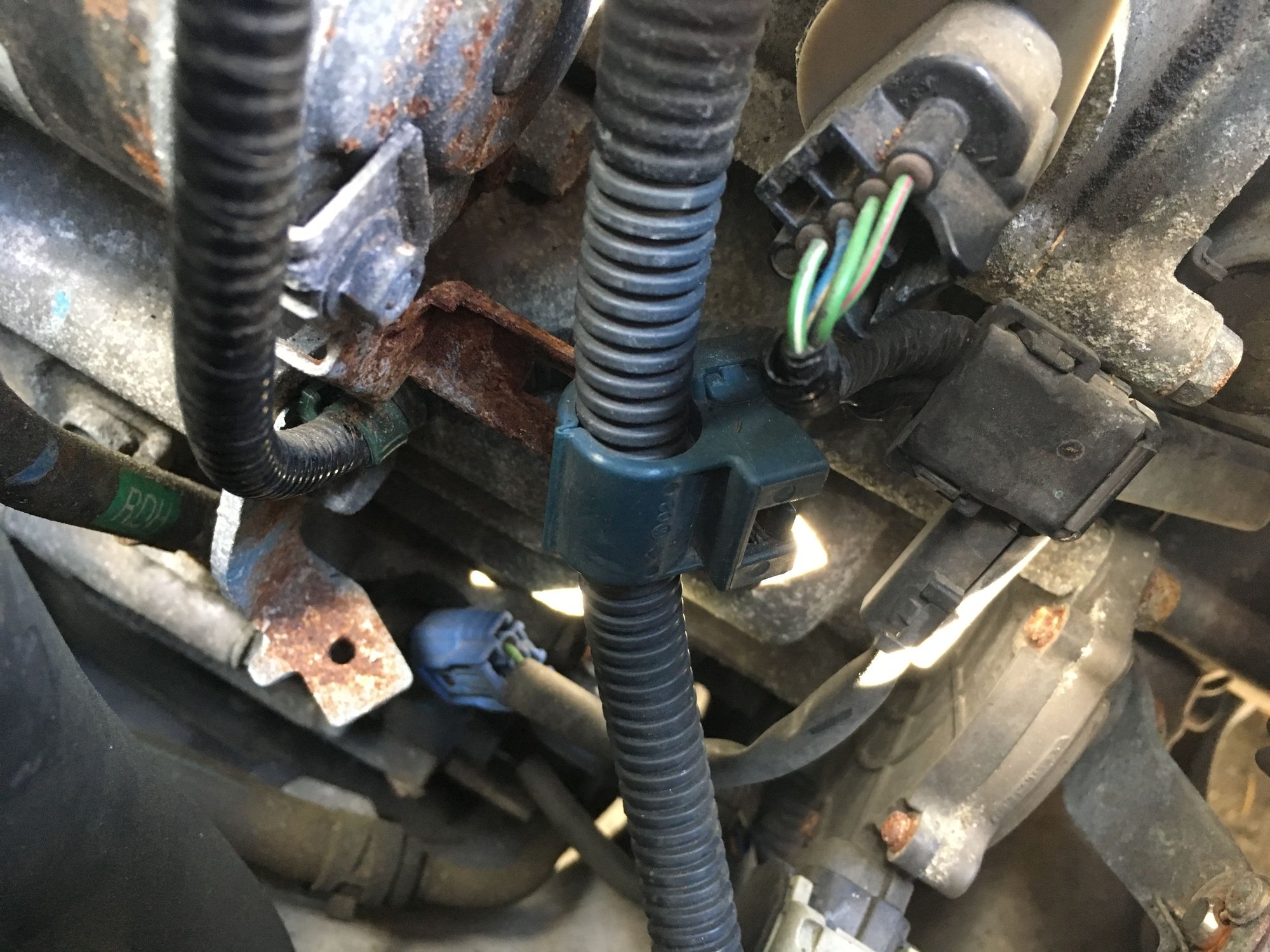

And pull this out. I used vise grip but it came out so easy I think it was designed to be removed without tools. Clip C in service manual.

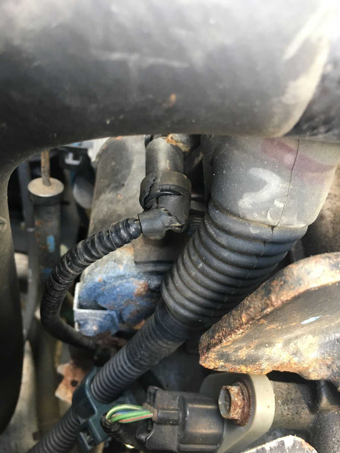

Remove the platic piece holding the coolant hoses. You can see the impression made by the holder and dirt.
Remove this 12mm nut. Now you can push the coolant hose to the side when it gets in the way. It will release the cable that is held by the turquoise clip. This is the part B in service manual

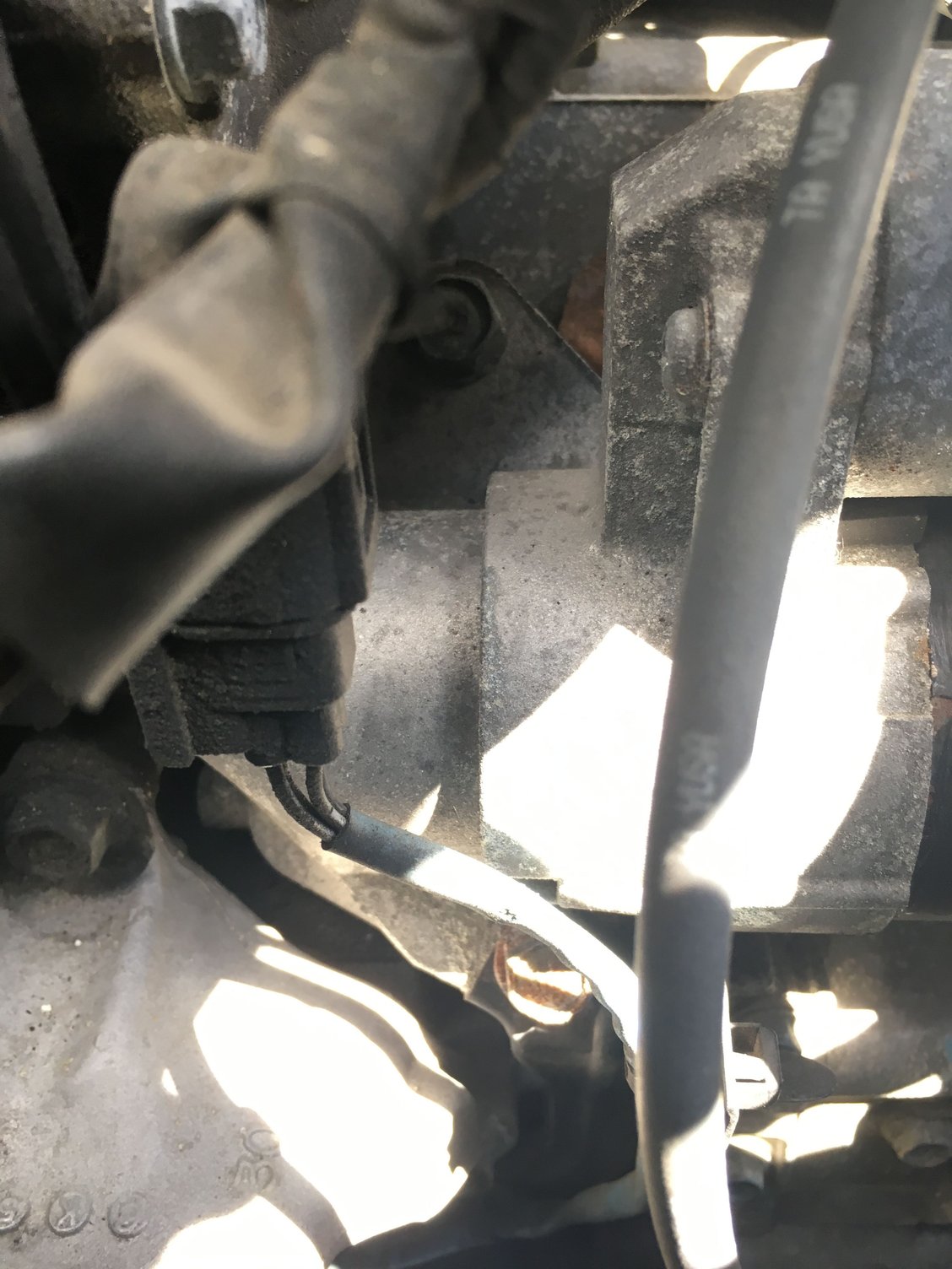

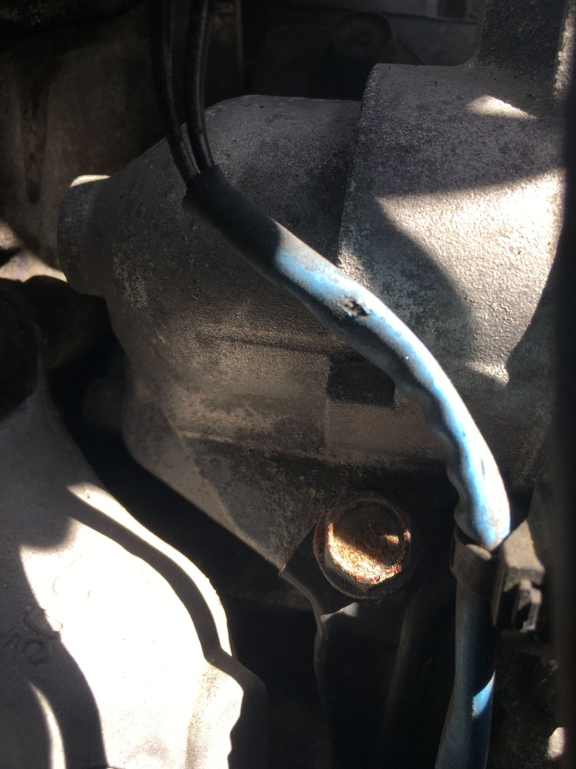

Time for the two starter bolts. One on the top doesn't look too bad but bottom one's rusted for some reason.
Closeup of the lower starter bolt

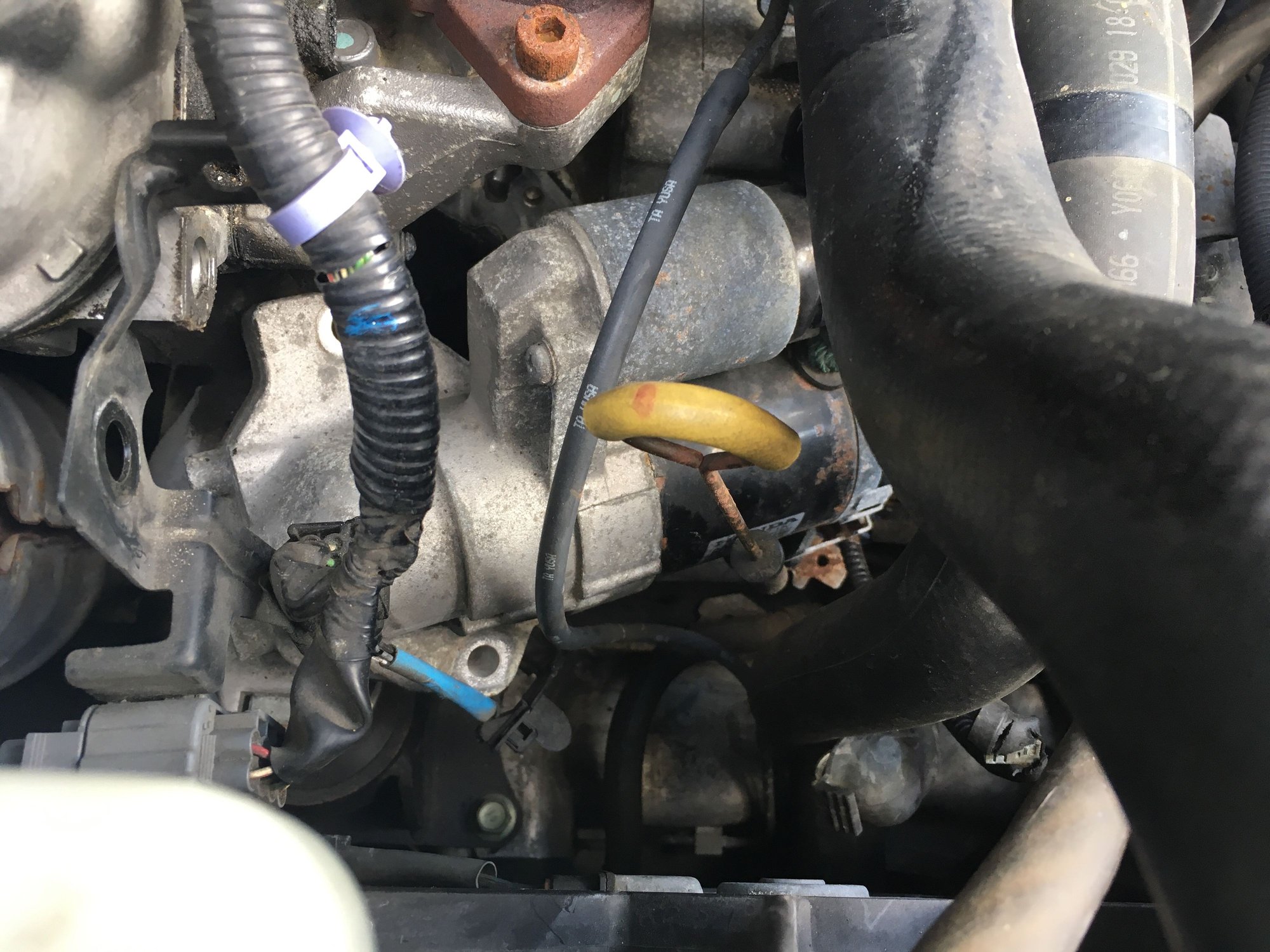

Here you see the purple clip to be removed and transmission dipstick blocking the way. So these 2 gotta go before your starter can come out right out the top.
I got some dirt in so clean the area before you undo those 2 bolts holding the starter. There is a gasket I believe can be reused since it's metal and why do they even have a "starter gasket" wtf ..
Bye now
