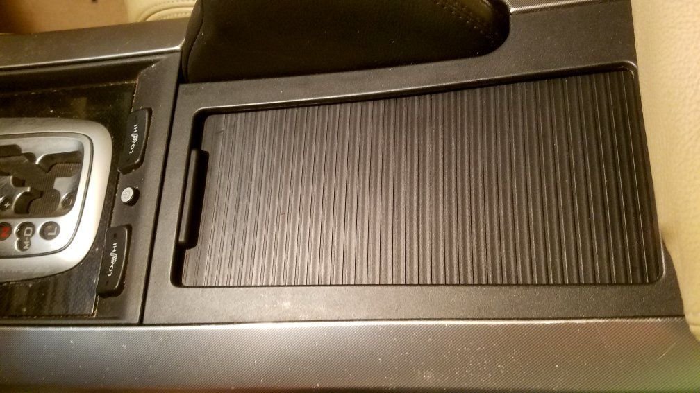

I bought this to try.. And it works well enough for a post..
05-09 Range Rover Sport Center Console Cover
https://www.ebay.com/itm/374655405154
Summary:

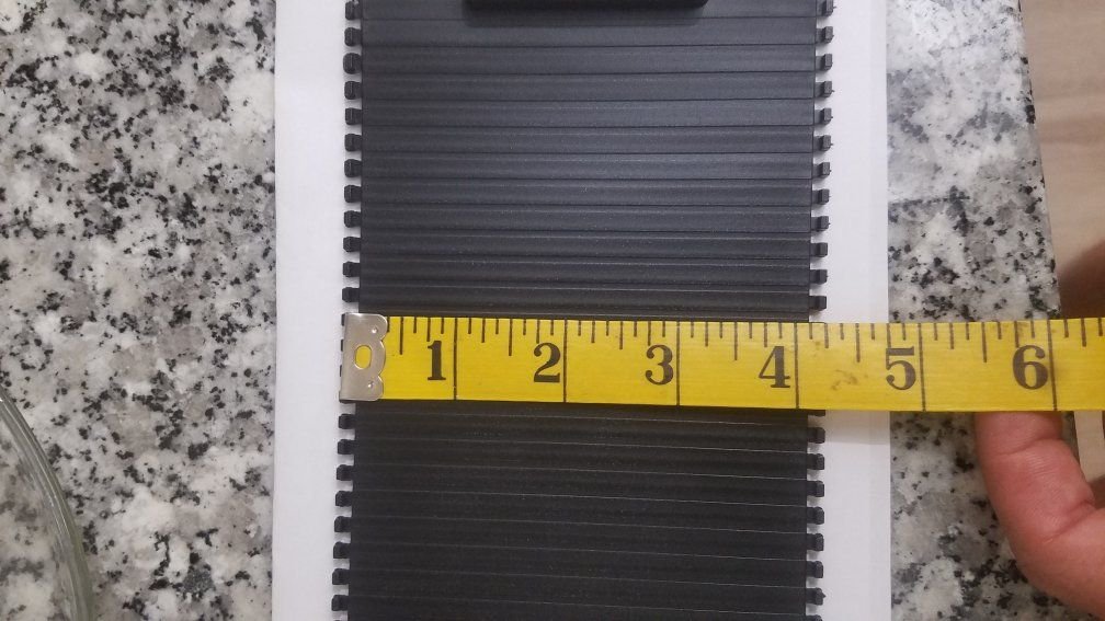

Width is as close as you can get to Acura OEM
Length is slightly too long so I cutoff 2 of the "rails" on the end, but 3 would have been better .. Either way it is good enough
My only compleaint is the Handle is too short. So when the cover is closed, it is difficult to slide back..
Either way, I would rather have this install than Nothing.. I like using the cover as a shelf, and it looks better closed.
Also the new one is a bit more flimpsy, but its not too bad. And if it was more ridged, then I might not have been able to BEND it to get it installed.
It is only $21 and really easy to install. But I did actually have to remove the cup holder because there was part of the OLD cover stuck in the back of the cup holder. So I had to remove it to pull out the old debris. Otherwise, I could have installed it without removing the cup holder..
But You dont have to dimantle the whole center console. Even the Aluminum rails, I only lifted near the cup holder and left them mounted by the Navi, at the top.

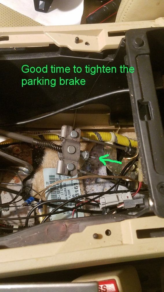

So I did this in about an hour! Plus I also tightened my parking brake in that time.. So I did it fast.

I emailed 2 people and asked for the dimensions. And the range rover was close to what I measured.

Now that I have the slider, I’m going to attempt this…I was wondering about tightening the parking brake though…is tightening it turning the bolt to the right? How much do you need to tighten (how many turns)? The reason I ask is that the cable for the parking brake broke about a year ago and had my mechanic replace it. However, ever since then when I park on a grade and use the parking brake, it doesn’t seem to hold the car in place like it used to. Would tightening this bolt fix this issue, or is there an issue with the brakes themselves being worn?

I would start with the parking brake shoe inside the rotor. There is a sprocket looking thing that needs to rotate to full tight, when you reinstall the rotor and cannot turn it... Then loosen the sprocket just to the point the rotor turns freely. Do all that with the parking brake lever down.
Then tighten the parking cable to where it is taunted but not so tight it pulls on the brake shoes. Turn the nut whichever direction makes the cable tighter. Or shorter.. I don't remember which way but likely to the right..but you may not have to tighten that cable after you set the brake shoes. So do that first then check the brake lever to see if that does the trick .
And the only way I know to check if you need brake shoes is compare them with new ones.. but they do run thin anyway
