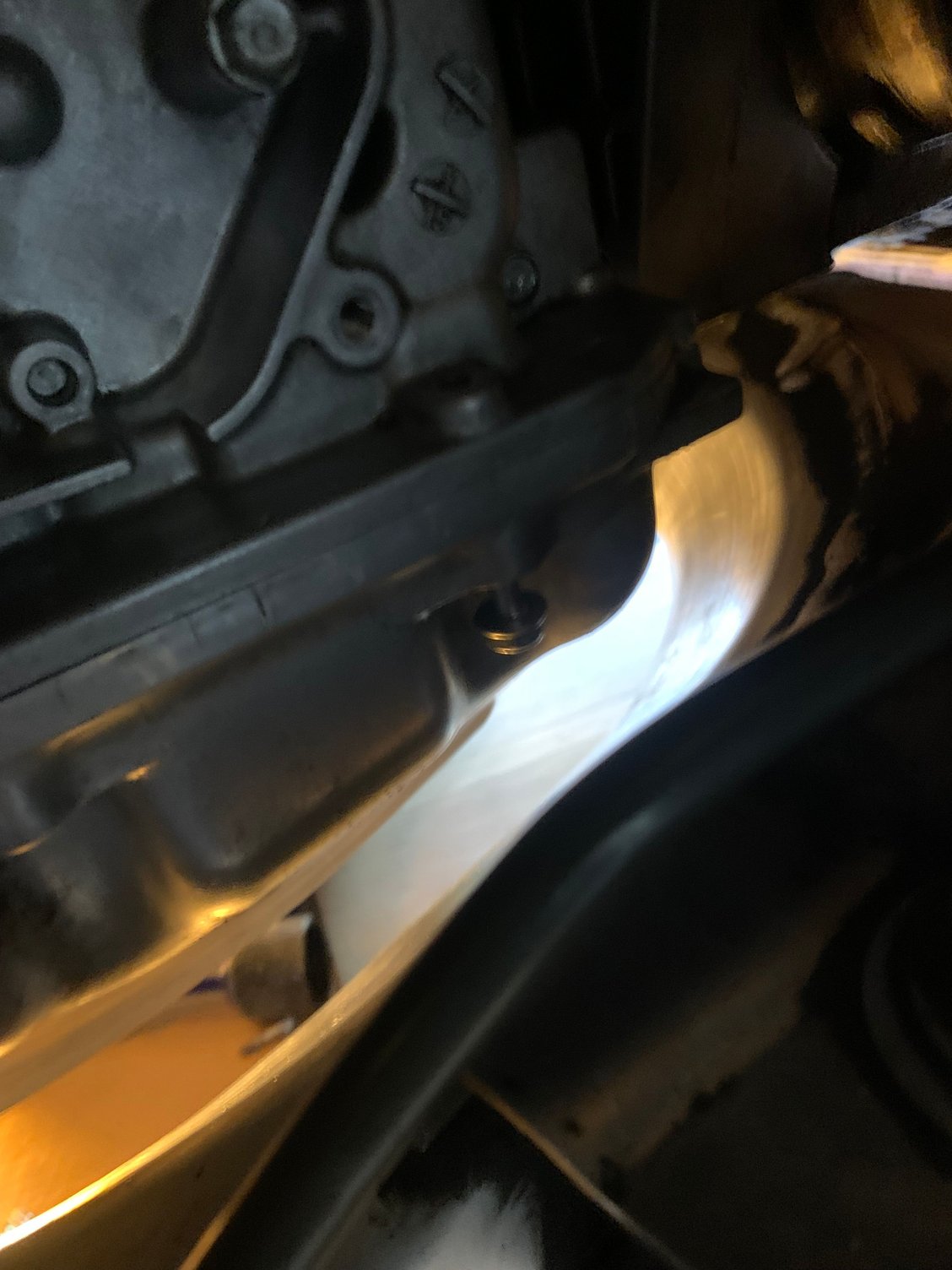

Practicing putting oil pan in place before i put hondabond on this thing. Some of these bolts seem nearly impossible to install. This corner one in particular i cant get a socket in there. What special wrench or tool do i need or what did u guys do to get this one in ? Can that hard line be pulled up without breaking the clip, and do u really have like 5 mins to get every bolt in place and torqued down?

i got it. That corner bolt took forever but oh well. Itll still be a bit before i add oil i have some other maintenance and repairs to do. Praying all is good cuz i dont wanna re-do this job lol

Yea you don't need to get 100% of all the bolts installed and torqued within the time window. At a minimum I would strive for 4 bolts in the corners within the window to ensure the pan is installed as evenly as possible to the block. Then after the 1st 4 bolts are installed, start going in between the two furthest bolts and working your way inwards.
I do remember that 1 bolt in particular being the biggest PITA. IIRC I was able to tighten that bolt with a 10mm box wrench, but since it was an angled wrench, I could only get like 20* of rotation before the wrench would hit the sub-frame, so needed to flip the wrench over 180*, tighten another 20*, etc.
MAYBE I jacked the engine up a tiny bit with a floor jack by whatever amount of play was in the motor mounts.

When I was doing my oil pump (that requires dropping the oil pan) I loosened the motor mounts and lifted the engine. I did couple of those on odyssey, pilot, mdx, accord, etc. without lifting engine using combination of 1/4 inch drive swivel sockets and flat wrenches. I'm guilty of lifting one engine by the oil pan, removing most of oil pan bolts and then putting it back the same way (so lifting the engine by the freshly sealed oil pan).
