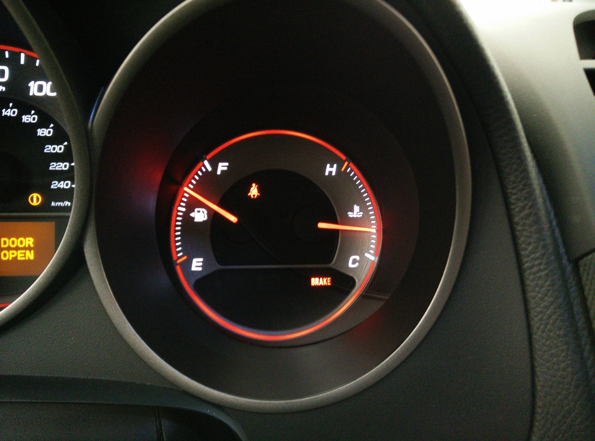

1st and foremost, the center console will get really hot when driving, more so when driving hard, and driving in the day. Before we get into "the air ducts run through there" conversation; i know. even when im running full ac, it still manages to get warm. i feel hot air rising up and out of the shift boot and ebrake boot. i am about to take the center console apart to see if i can narrow it down but i have done other checks before.
first thing i looked into was my cats. they didnt have the heat shield on them and i suspected heat was radiating into the firewall, and into the center console. so i replaced the with high flow cats and had them ceramic coated to keep heat down. initially i thought it helped, but today driving during the day, i discovered it didnt (at least not enough to notice).
second, checked for exhaust leaks. there doesn't seem to be any to speak of, when the car cools down i will recheck all the bolts from hfpc, rv6 jpipe, and rv6 td exhaust. but last time they all checked out fine.
third, i thought my car would be over heating.
the car runs relatively cool compared to my previous tls.
Operating Temp
so all and all im pretty stuck on this one guys. any suggestions would help.

As for the console, I don't have a decent answer for you (I've had my console opened and there's not a whole lot of heat sources I can detect except I have an AT, so that is a difference between the cars).
As for the temp gauge reading low, it could be a faulty thermostat (stuck open) or more likely either a defective sender to the dash gauge. The best way would be an OBDII reader that tells info about the car such as true temp of the coolant.

guys im semi stuck. under the hood it feels some what hot after a drive (15+ miles aka driving to work/home). the car does not appear to be over heating (gauge still stays at the 5th line).
would a faulty temp sensor contribute to this? i feel like since the thermostat is mechanical it shouldnt relate to it. when driving i can feel the hot air flowing through. at lower speeds it isnt too bad but most my driving is highway.
ive checked the firewall to see if there are any openings but i did not find anything that stuck out. the heat comes from just to the passenger side of the center console, basically around my ceramic coated hfpc.
i believe that the thermostat getting stuck half open, and the sensor reading low could be a combination to do this, but the car shows no symptoms of overheating (other than a hot engine bay after driving).
any input is appreciated, its such a weird issue, yet so annoying because the heat is a tad bit scary.

Can't help you with the heat in the console, but I've wondered the same about the temperature gauge. I bought my car with about 40k on the clock (now at 101k) and the gauge has always read the same as yours. Never once have i had any issue with overheating or using/leaking fluids.

hmm hopefully it just is what it is as far as the temperature gauge. if i have time im going to expose my cabin filter and see if im getting heat coming from there...
i wonder if my egt's are high, but the car seems to run pretty well. sure it being a little lean will give me alittle umph, with higher temps but this center console wind is hot.

update:
the engine temp is fine. it regulates itself perfect. fans come on for a minute, and idles good for another 5 or so, rinse wash repeat.

1) thermostat is normal for 08 tl-s.

glad you solved the heat issue, but what about the temp gauge? I know its definitely supposed to show higher than that

alot of 08 tl's show that 1/3 reading apparently, while 04-07 show 2/5's.
this is just what i have noticed on the forum in another thread i was looking at.
https://acurazine.com/forums/problem...8-tl-s-923643/
Old Jan 12, 2015 | 07:50 AM
^the temp gauge is not exact.
if you notice; there are no numbers to indicate exact temp.
just a range from cold to hot.
and should be looked at as a range.
so, if your temp gauge needle falls in-between HOT and COLD, your car is at optimum operating temperature.
If you want to be exact; hook up a bluetooth OBDII dongle and check the temp with an android or iOS app.
For as long as I've been driving, I was always taught that the temp gauge is a range.
it should always fall somewhere in the middle.
not too hot, not too cold. Just right.
if too cold; will fuck up your engine.
if too hot; will fuck up your engine.
so, as long as it falls in-between the two; youre good.

I don't think too cold will screw up the engine .. more screw up the efficiency and maybe run it a little rich..

I can vouch for the temp gauge. Mine stays at the same spot as yours and I've seen other 08 TL-S gauges and they all stay at 1/3rd so you should be fine there. Only way to check if there is an issue is plug in a reader on your OBD port and look at actual numbers but I'm pretty sure you are fine.
