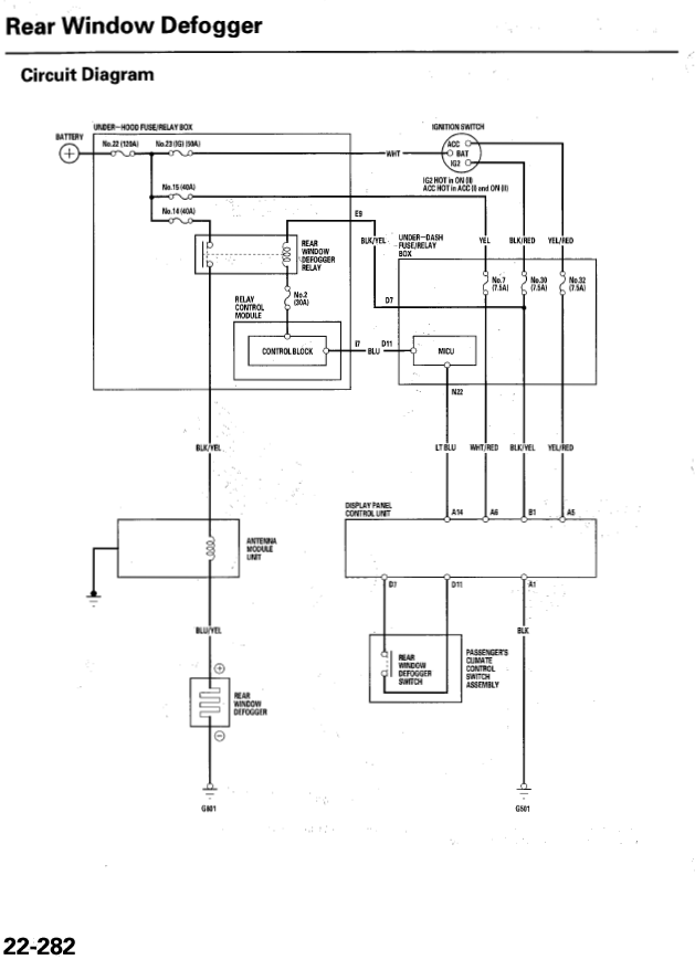

Here's the manual regarding defogger testing + relay testing.
