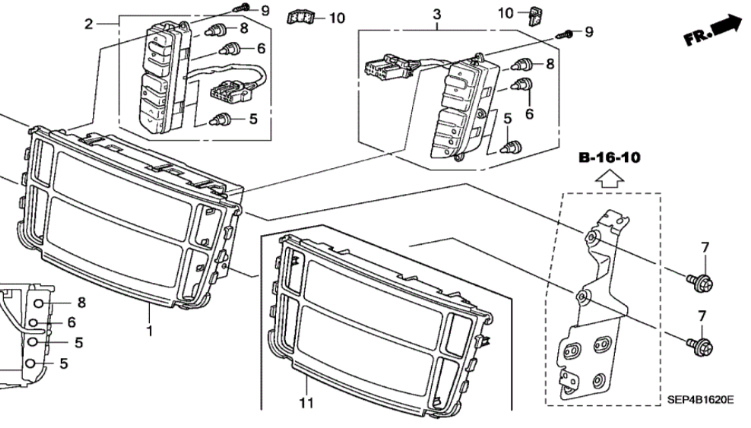

You might be looking at replacing the switch itself. #3 in the picture below.

Originally Posted by Tyrone503
Sorry OP, Did you ever get this figured out?
Are you referring to the orange light that turns when the switch is pressed?
This.
My navigation screen decided to end itself (pixelated pictures) so I bought a used nav screen off a member here and it came with the two button assemblies on the left and right of the screen (#2 & 3). Immediately after installing the entire unit, my rear defroster stopped working.
So I pulled everything back out, swapped just the right-hand side buttons (#3) which includes the defroster, and BAM. Rear defrost started working again.
Not saying this is 100% your problem, but if fuses are good...
