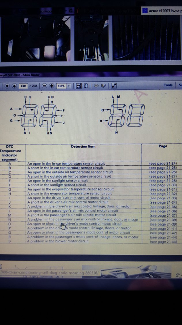

Letter n of the diagnostic diagram that has the 88. 88. Image on top. I just want to know where this part is located. If from the inside or outside. My car draws cool air from drivers side but not from passengers side.

I believe you forgot to post the diagram.

I baught the part but i cant seem to find out where this actuator is located i dismantled the glove compartment and all i see is 2 motors 1 is for the air modes which work fine for the passager . And anotherone that has 1 point moving arm that goes on the side of the blower

The issue in the car is that in the passager side there is a different temperature coming out of the vent than the driver side
