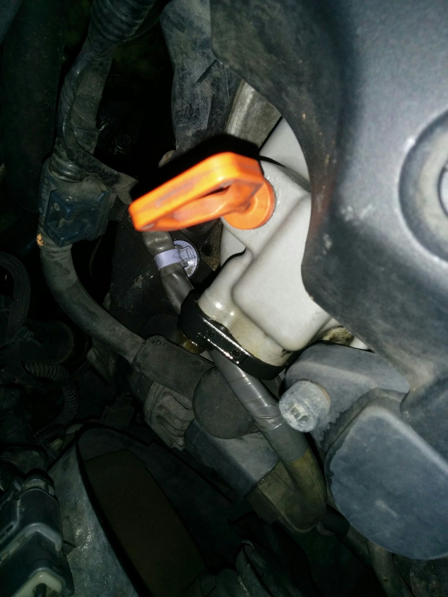

So guys the thing is i was cleaning my engine bay and yesterday i see some oil in the bolt.. As the oil gets warmer the oil start to smell like burned.. But there is no leaking in the floor just in the engine... Pictures will talk better..

Time for a valve cover gasket change, including the bolt sealing washers. Not a big deal if you don't get to it right away, it's not going to lose a lot of oil. Be careful with the valve cover bolts, they don't require much torque when installed.
Man thank you very much im very greatfull . i was so nervous. Can i do it in the next mainteinance (my oil life is in 50%)

yes you can do that. Its not a hard job at all. Basic tools will get it done.
Remove manifold top plate then remove the manifold and remove covers and replace all gaskets and bolt seals

Wouldn't hurt to replace the PCV valve too, less than $30 for that part.

can i do it in the next maintenance service ?? i usually use the oil life indicator for doing all services..

yes but since its leaking right now, you might as well get to it soon and change the oil afterwards
Thank you. Today im doing 60 miles on highway and tomorrow going to fix it.
