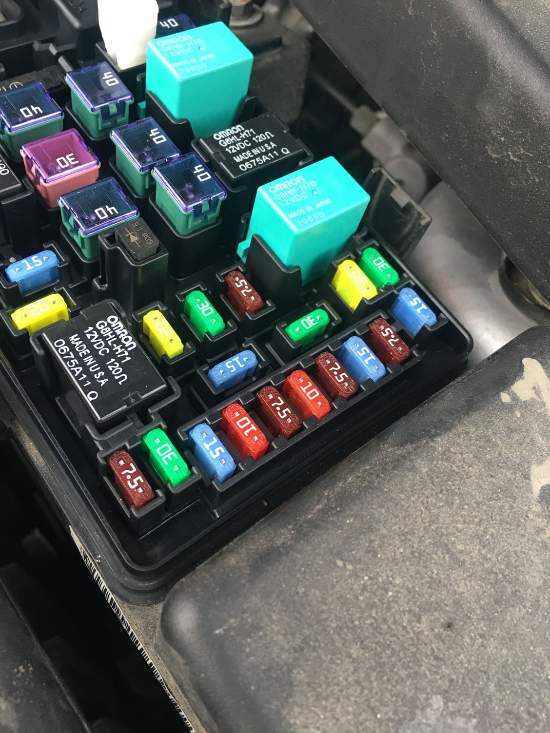

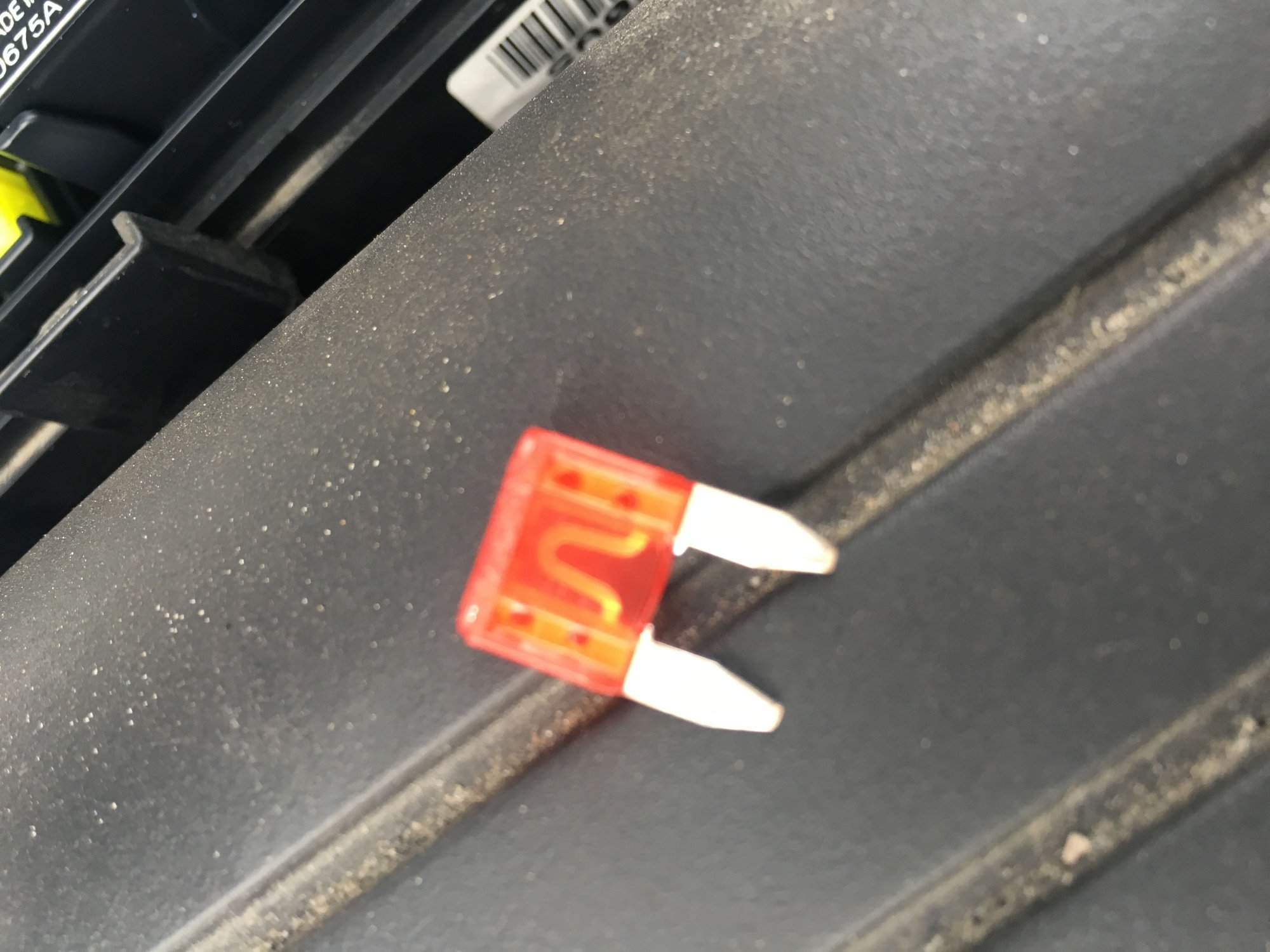

Where was the relay? I'm having a similar problem and I can not find the relay.
So which relay was it?
