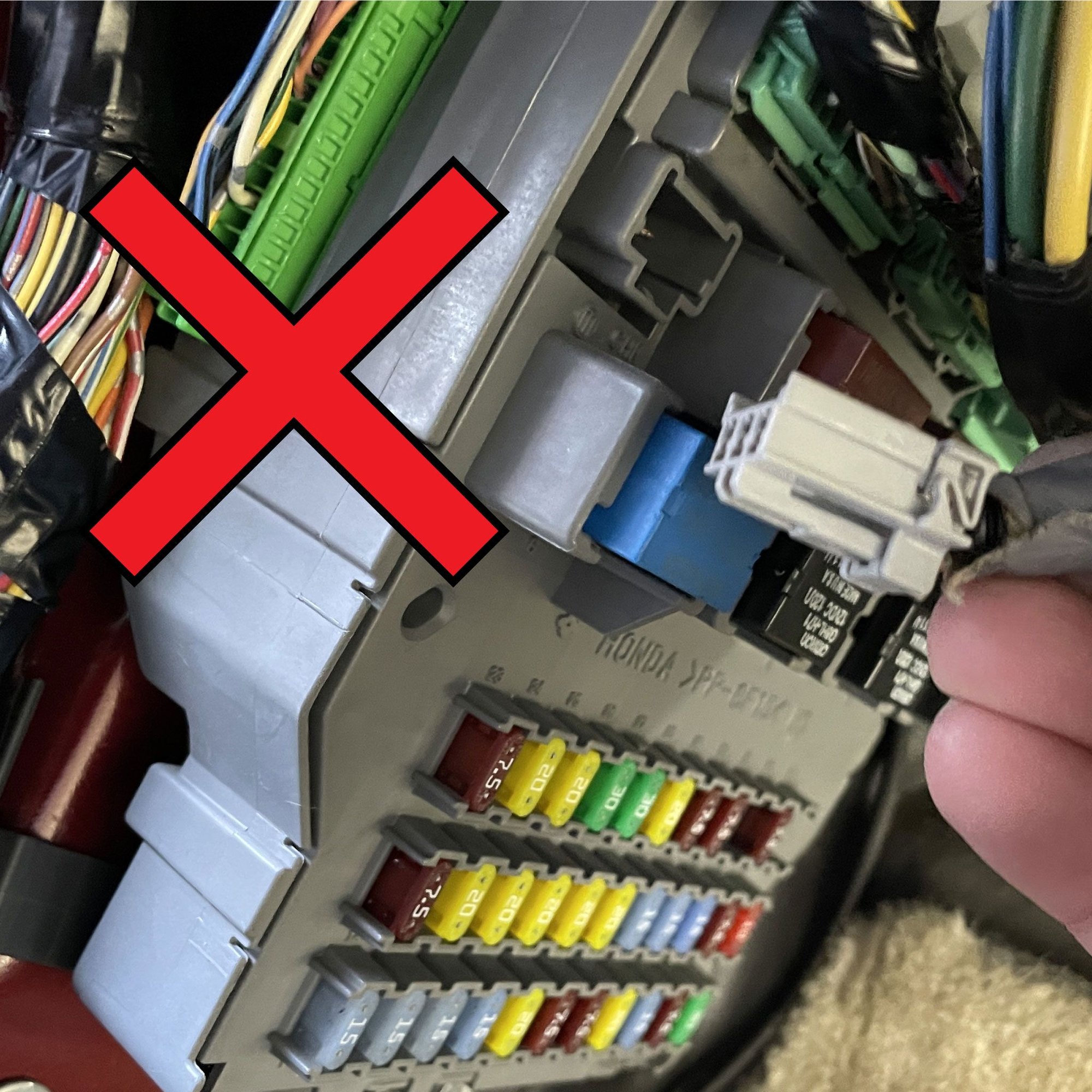

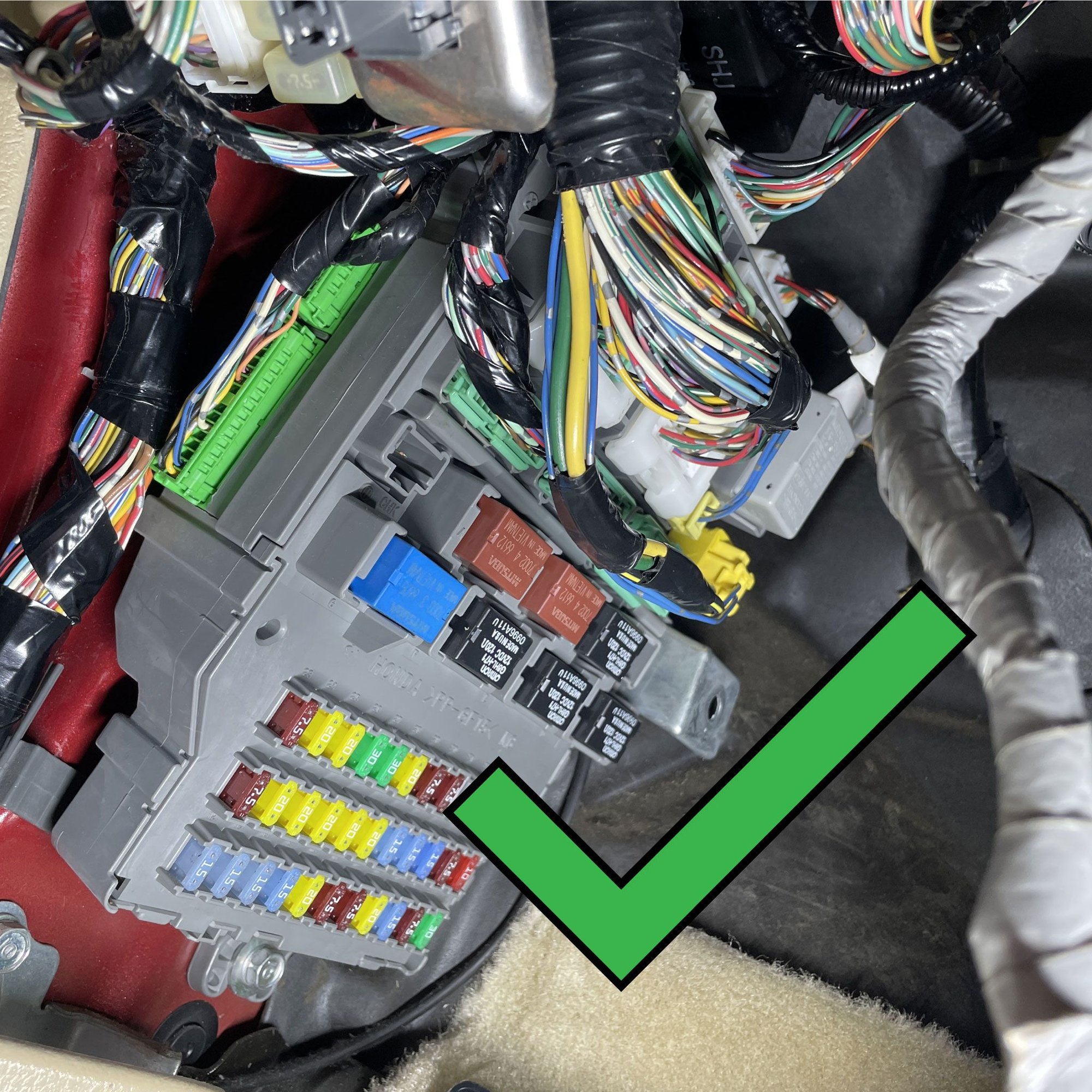

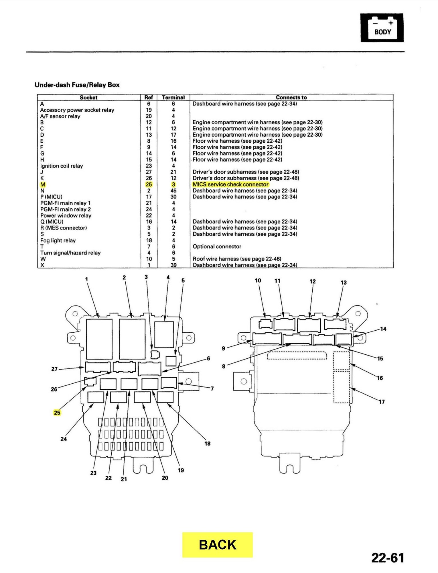

So this is now a PSA. On the under-dash fuse panel, there is a connector (called the MICS service check connector) that happens to match the driver's side footwell light connector. So when you're going all willy nilly connecting all of those loose wiring connectors up, don't plug anything into this socket.
