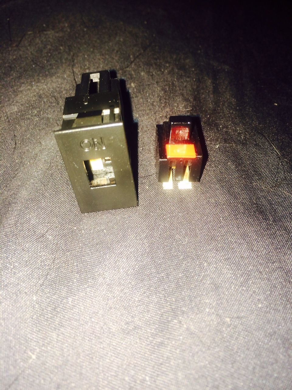

I just played around with the iSimple for the third time and messed up the main trunk switch putting the glovebox back together. I'm not sure how it happened but I ended up with the two pieces in the picture. If I recall correctly, this piece with the red on it is supposed to be inside the main switch, or am I mistaken? The thing is I have absolutely no idea how it popped out of it if that is the case, is there another piece I am missing that broke off? Any help/pics of what the main switch is supposed to look like would be appreciated.
If I end up not being able to get the piece back in, can I solder the back of the switch to close the circuit?

I can't help you with a picture now, but if you need to replace it, the part number is 35810-SEP-A01

If it popped out with the cover on, then you should be able to find out where it popped out from. If not, then carefully remove the cover w/o breaking the plastic tabs and place it back in. You don't need a picture to figure out how it goes together, look at the terminals, its an open and closed switch, just like a light switch.
