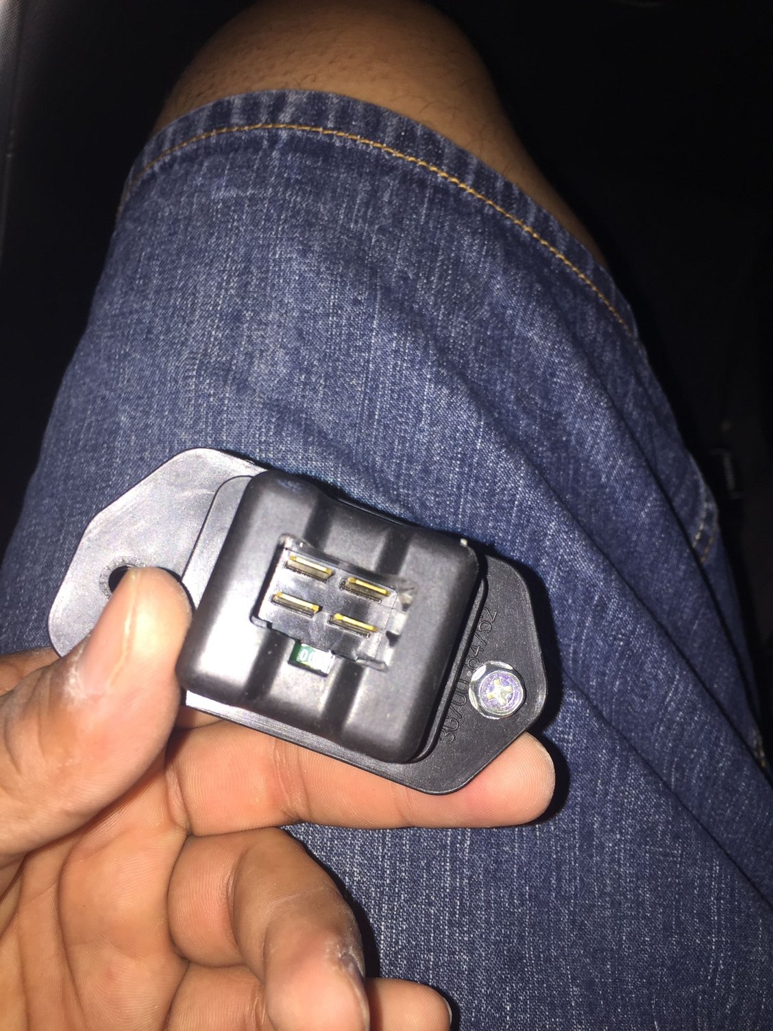

Originally Posted by Jackass
1.) Air coming out of vents - Sounds like the blower transistor died and needs to be replaced. Easy fix.
2.) Air noise from under hood - No idea. Belt, pulley, fan...need better description and what part of the engine bay.
does it look good or bad? Not sure? The cables and connecters look good still.
Old Apr 9, 2017 | 12:35 PM
Jackass's Avatar
Posts: 2,600
Likes: 630
From: KCMO Burbs
Don't think you can tell good/bad from an external view. Only way to tell is testing it or taking it apart to see if anything is burned. I never took mine apart, I just swapped it out. My symptoms weren't exactly the same as yours....my HVAC blower wouldn't come on half the time or would just stop. Others have issues with the blower always being on. Just depends on how it fails. Mine was failing open, while others have it fail closed.
