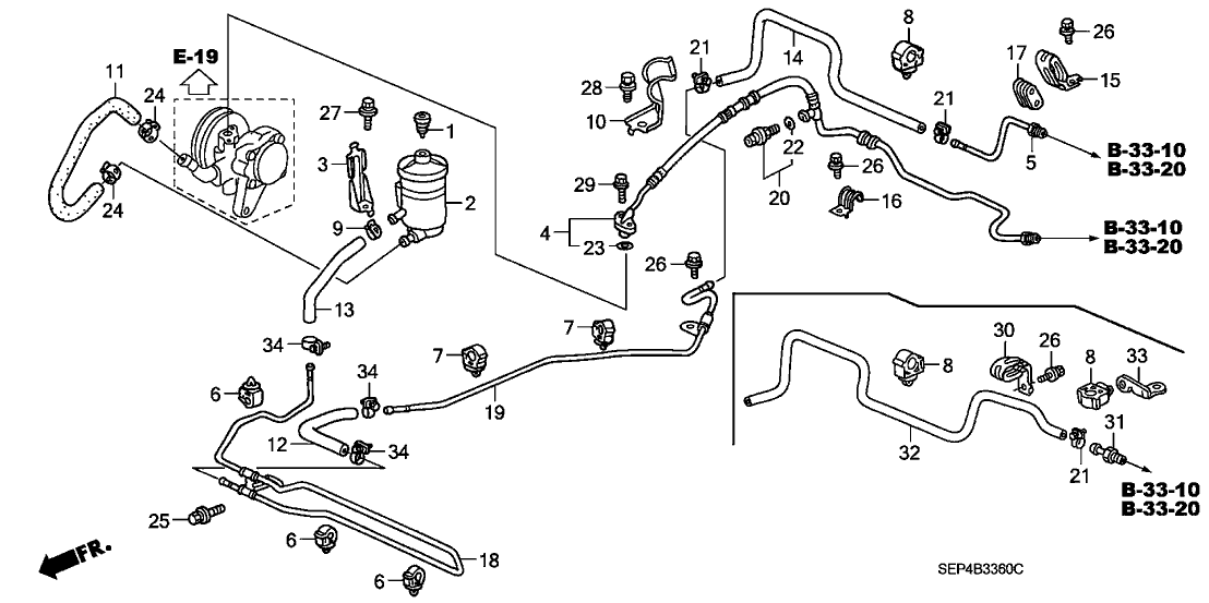

I believe its number 11
Acura Parts @ AcuraOEMparts.com - Genuine Acura OEM Parts from Delray Acura

Second what justn said. It happens often with the PS hoses because they're close to the motor. They crack or get misshaped as they dry and then seep oil if you ever move them. No leak is normal, no matter what you've seen on pictures around here.
What I imagine happened is they removed it for the PS fluid flush, replaced it with the clamp (it's only a spring clamp, cannot tighten it too much or too little) but since then it's been weeping fluid.
Edit: And yes, 11 seems about right justn!

Okay, so I'm probably going to get 11, I found it online through one of the vendors, but do you guys advise getting two new clamps as well? Where it says "24?"

Clamps rarely are the issue. You may need a new soft inlet hose. About $30 CDN
Old Jan 27, 2015 | 04:44 PM
clamps are re-usable
