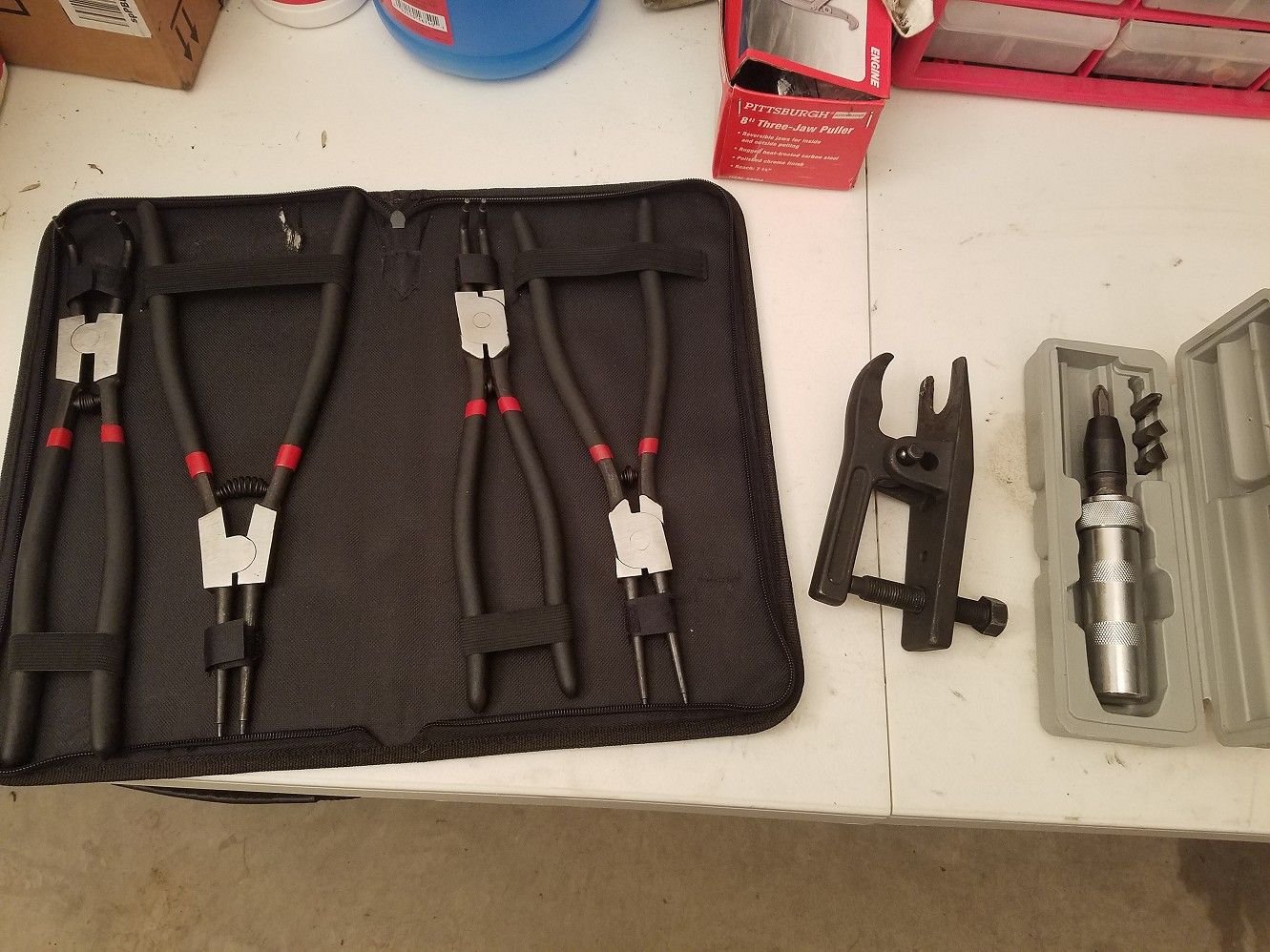

Finally Complete.
I finished the passenger side and the car steers like new. I didn't realize how bad it gets over the years until you replace worn ball joints; The steering wheel is dead on straight. I also put the Type-S springs on the car and firmed up the koni's by 1/4 turn, lowered the perch, and it rides much better too. Not to mention the rattle I fixed coming from the rear, it literally drives and handles a lot better and quieter. And I still have rear excessive toe out. When I fix that maybe it will be like a vette. haha Anyway, besides needing a stand alone 12 ton press (not 6 ton), as well as a C-clamp type portable press, these are items that will help the job go faster and smoother.
Portable 13" Internal / External Retaining Clips Snap Ring Circlip Pliers Set
Portable 13" Internal / External Retaining Clips Snap Ring Circlip Pliers Set | eBay
(they look overkill, but the smaller "handsize" snap ring pliers are NOT big enough. wont work)
3/4 in. Ball Joint Separator
3/4" Forged Ball Joint Separator

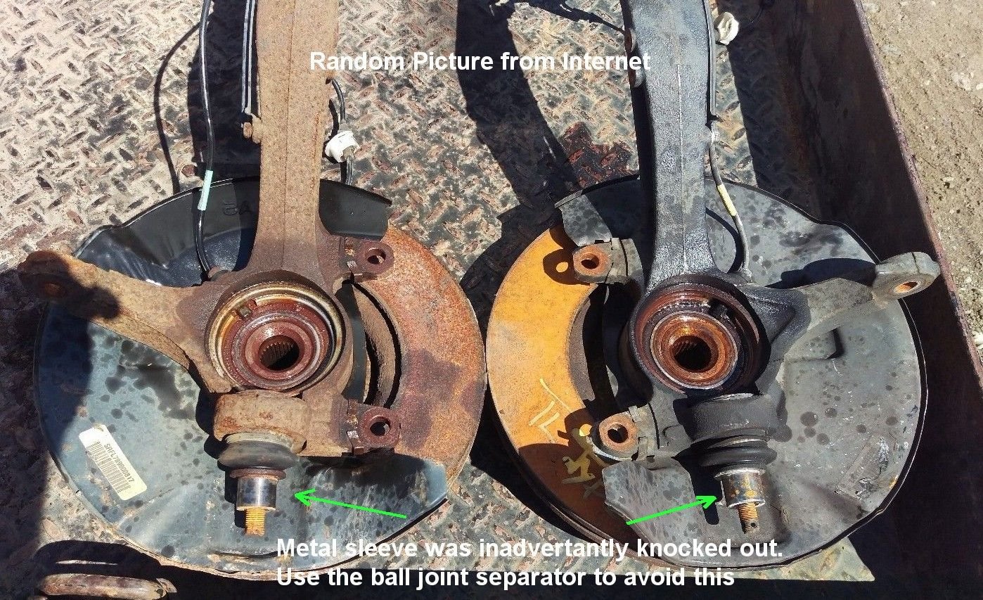

(This ball joint separator is a must have. Especially for the ball joint and to keep that "sleeve" in the lower control arm. This separator can be used on upper control arm, and tie rod end too. You gotta have this. By the way, this separator was just TINSY bit too narrow for the lower ball joint, so I just barely nicked out a little lip on the inside of the separate with a grinder and it fit around the ball joint. Important note: do not just half way install this Separator because if you intend on reusing that thing that you press out, it might damage the end of the threads. If it is not straight and flat at the bottom when you tighten it down, it can bend the tie rod end or just damage the threads. In either case, it will render that part useless because you can't get the NUT on it.. So be careful on parts that you want to re-install.
TEKTON 2905 3/8-Inch Drive Manual Hand Impact Driver Set, 7-Piece (I bought mine from (O'reilly's or Autozone)
Amazon Amazon
(This Tektron Screw remover is used for removing those Hub retaining screws. Just give it a hard whack and the nut is free. It takes a little bit to figure out how it works, but it works. The splash guard also has screws holding it on. So you can use it on that too. I never used Tektron, I got mine at O'reilly's or Autozone, but as you can see in the picture it looks very close to it).
