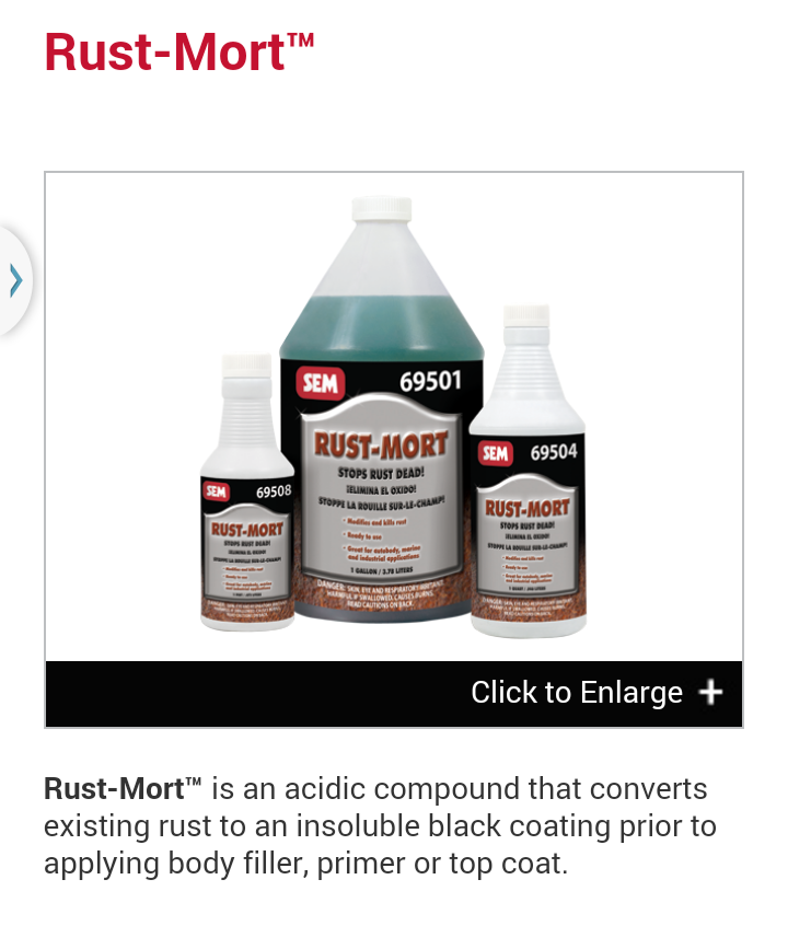

DIY
I don't think it's as bad as it looks.
1. Put the 3M paint stripper tool in a drill and grind all the rust off. The wheel will clean and condition the metal. Go slow at first untill you get the feel for it. You might need 2 rice cakes... lol
2. Use the sem rust coverter to neutralize the rust and convert it to something else. . Follow their instructions. Pick one.
3. Scuff the painted area back 2 to 3 inches with a gray 3M scuff pad.
4. Primer and seal the bare metal/converted rust. Or use a sealer that can be use on bare metal. The sealer is important... it's water proof where primer is not.
5. Top coat... paint.
