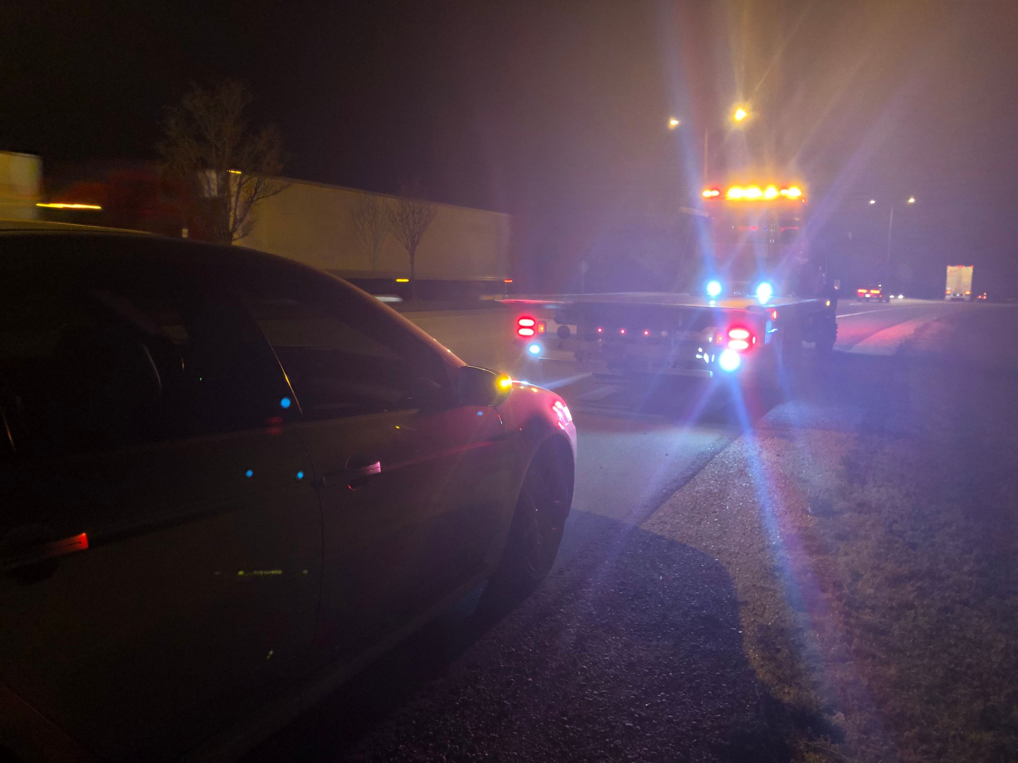

I bought my 2008 TL-S AT last month and I think I just killed the transmission. I decided to speed off from a stop light. (Not even WOT). It got stuck in 2nd gear, which it did the week before. I heard a loud clunk coming from the transmission area. I tried to shift it in to neutral and back into drive no luck. Currently can not shift into reverse or park. When I’m in neutral and have the parking brake on it alerts as if I’m in drive to turn off the brake. Also when I put manual gear mode it goes right to 3rd. Regardless of gear the transmission is pretty much disconnected from the engine.
I’m waiting on a tow to a well reviewed transmission shop. wish me luck I’ll need it.
