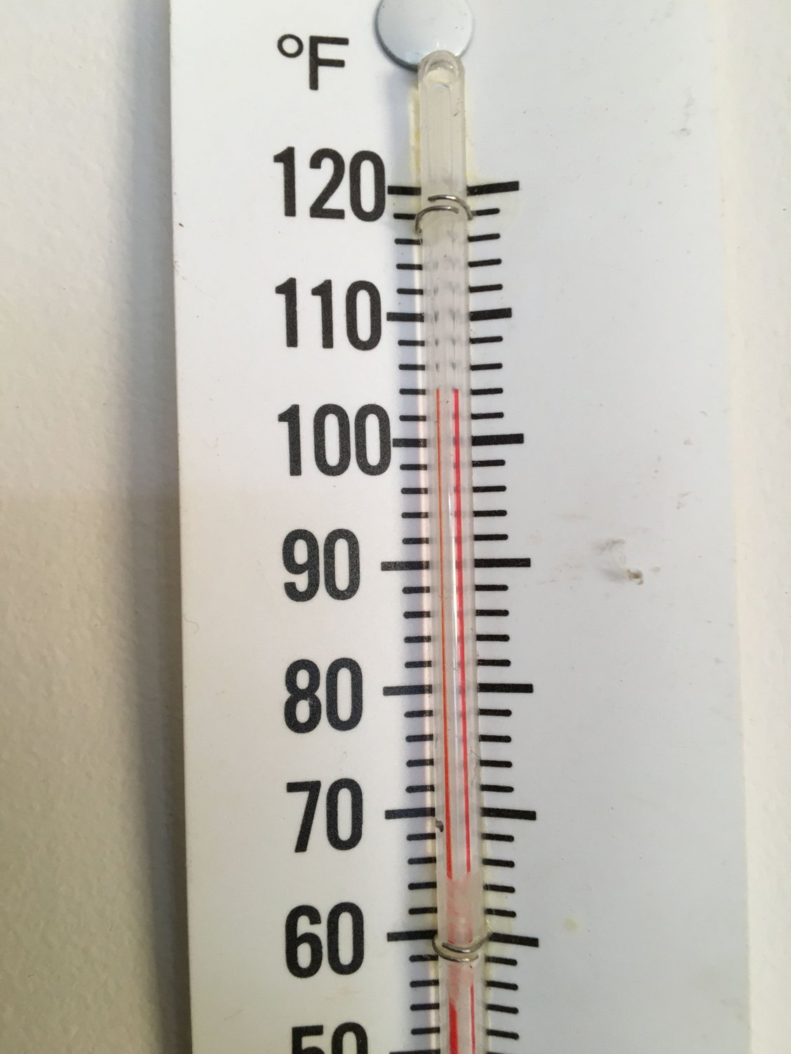

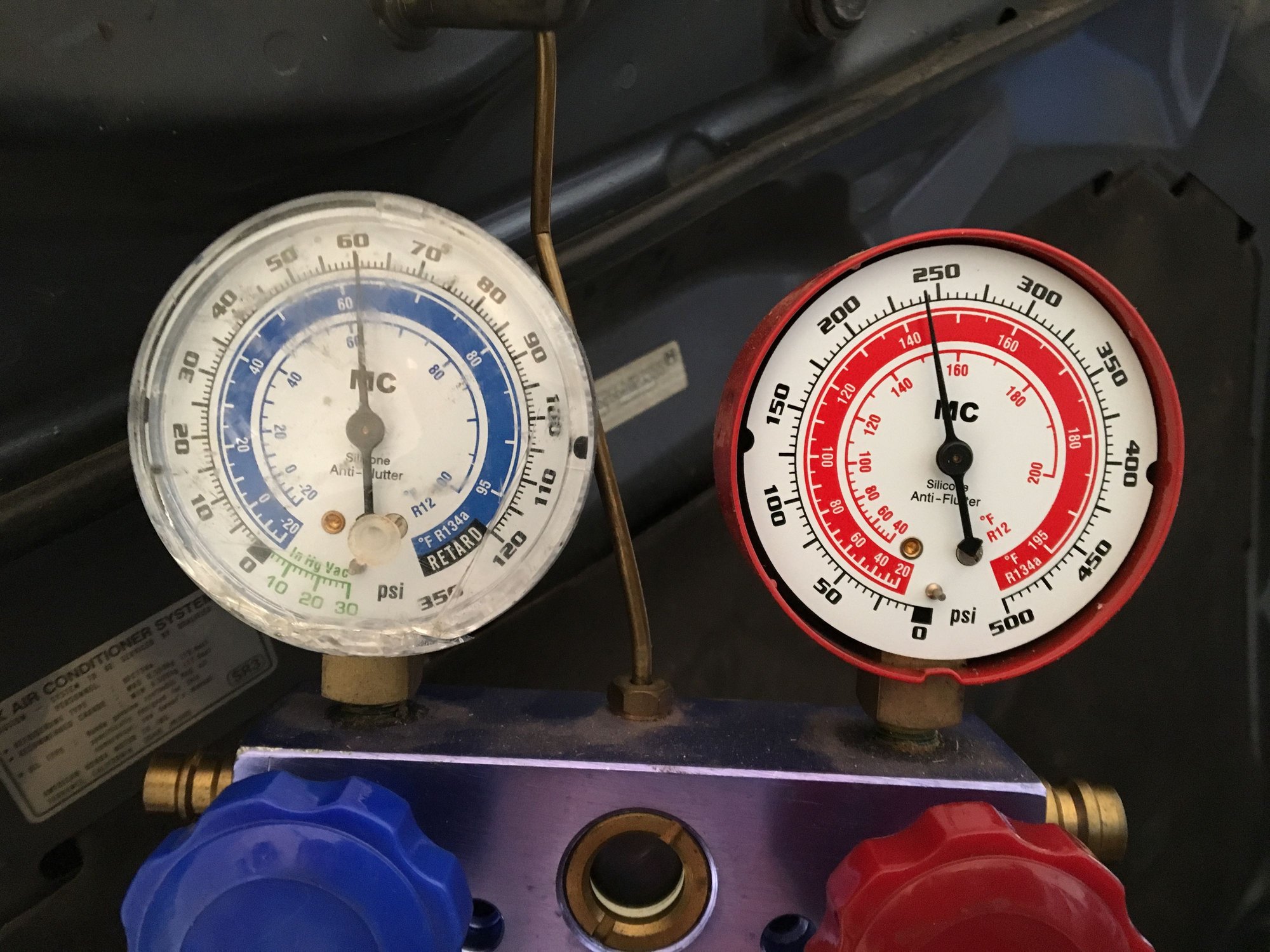

As you might image, its been pretty hot this summer and the A/C isn't keeping up at all. I hooked up the diagnostic gauges, ran a fan in front of the car, turned on the A/C, and put the temperature to LO. At operating temperature the thermometer registered 70 degrees, but eventually crept up to 72. At 104 degrees, the gauges read 60 on the low side and about 250 on the high side. Any thoughts on what may be the issue here? Your feedback is appreciated.

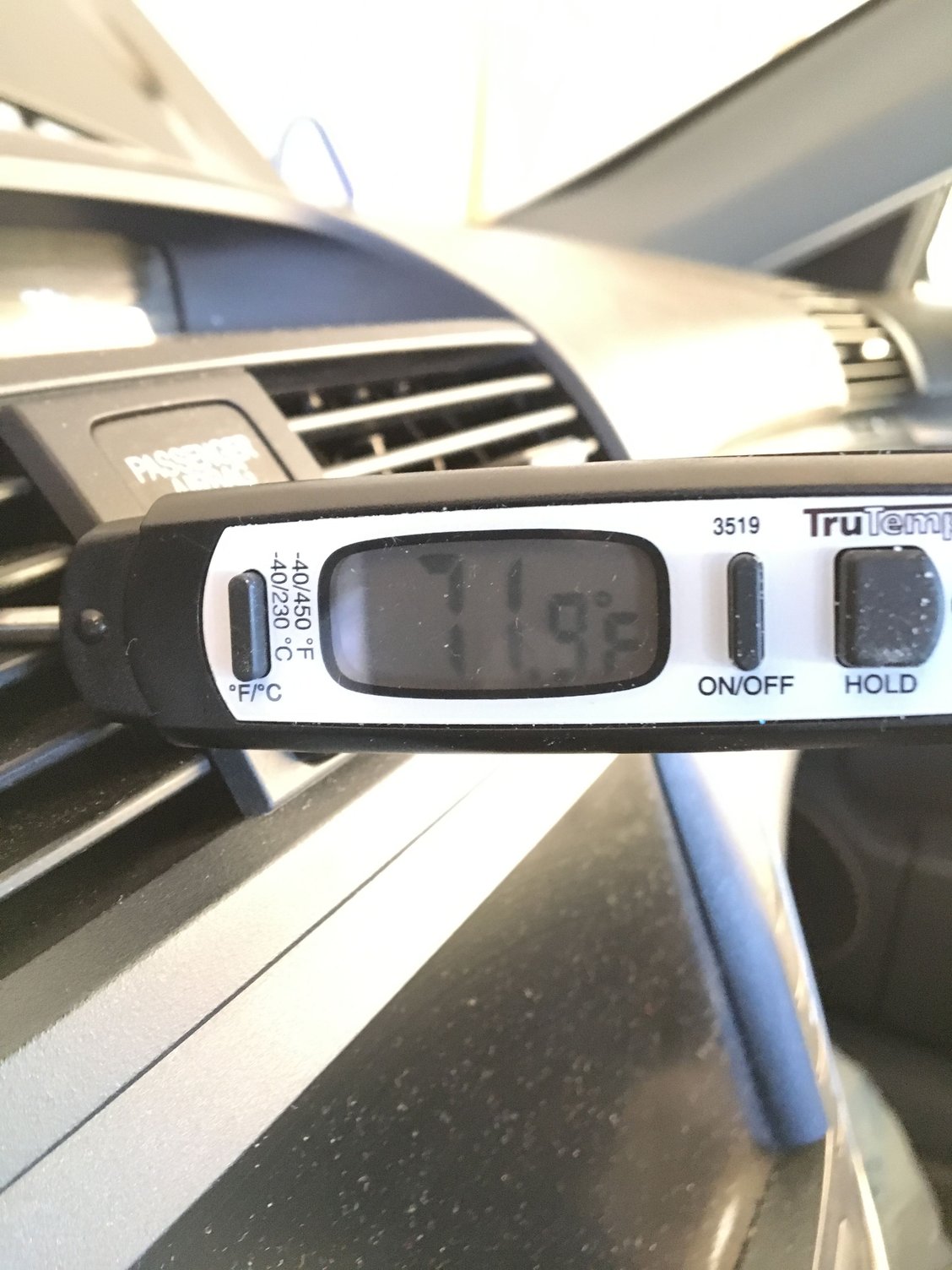

What's the temperature of the air coming out of the vents? You may want to clean the condenser and change the cabin air filter.

Ambient temp at the time.
Vent temp.
Gauge measurements.
The temperature coming out if the vents, while climate control was set to LO and set for the middle vents, was between 70-72 degrees.

Low side too high. High side normal @ 2x ambient temp +50-258 PSI
Suction Pressure Abnormally High:
1-Low pressure hose and check joint are cooler than the temp around evaporator-
Expansion valve opened too long
2-Suction pressure is lowered when condenser cooled by water-
Excessive refrigerant in system
3-High and low pressure are equalized as soon as the compressor is stopped, and both fluctuate while running-
Faulty gasket
Faulty high pressure valve
Foreign particle stuck in high pressure valve

So is this to say that one of these three is the issue, or is it numbered in order of liklihood.

From the Acura service manual, reasons listed, not in order of likelihood.
