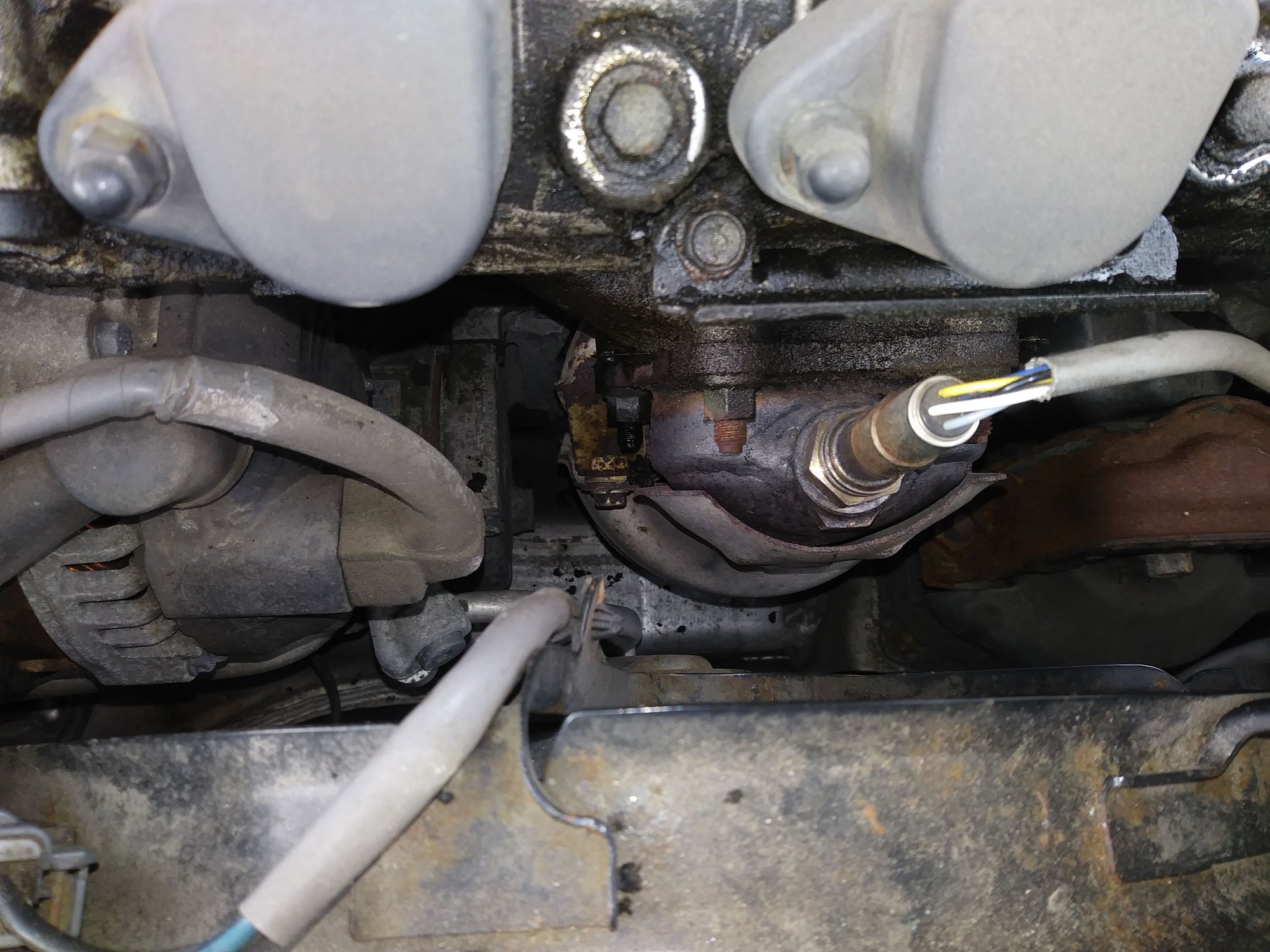

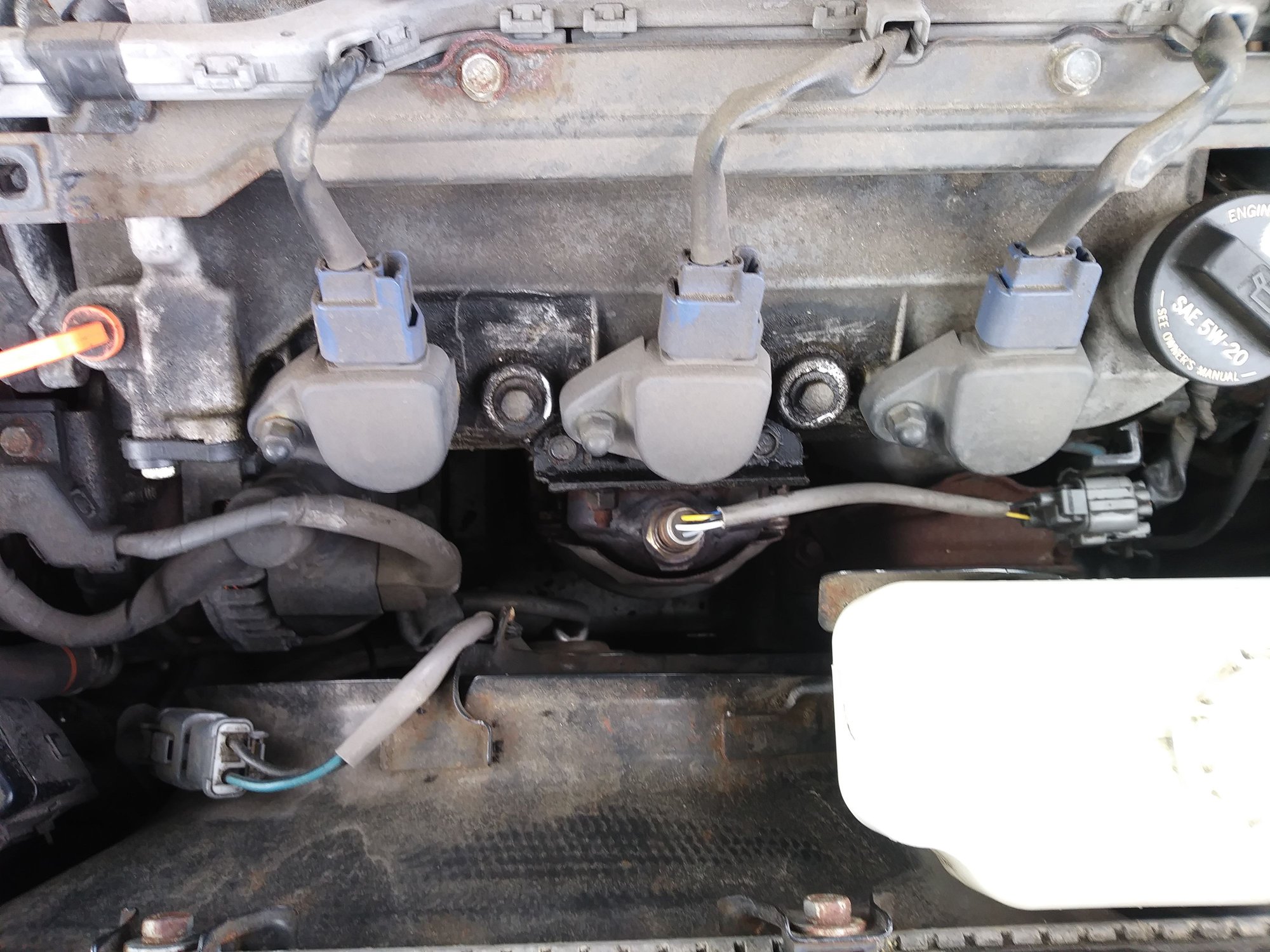

I did see lots of dried oil around coils and cat gasket. Wondering if this is something related to exhaust smell or normal for 2007. Smell is definitely exhaust smell that goes away after reaching temp. Spraying soapy water of spot with blower in exhaust doesnt produce any noticeable bubbles.

Replace valve cover gaskets. That's probably what you're smelling.

I think you maybe right. What are your thoughts on Blue Devil Oil Stop. Im trying to avoid a major repair on the car and have been reading some good reviews on it. Some not so good either though
