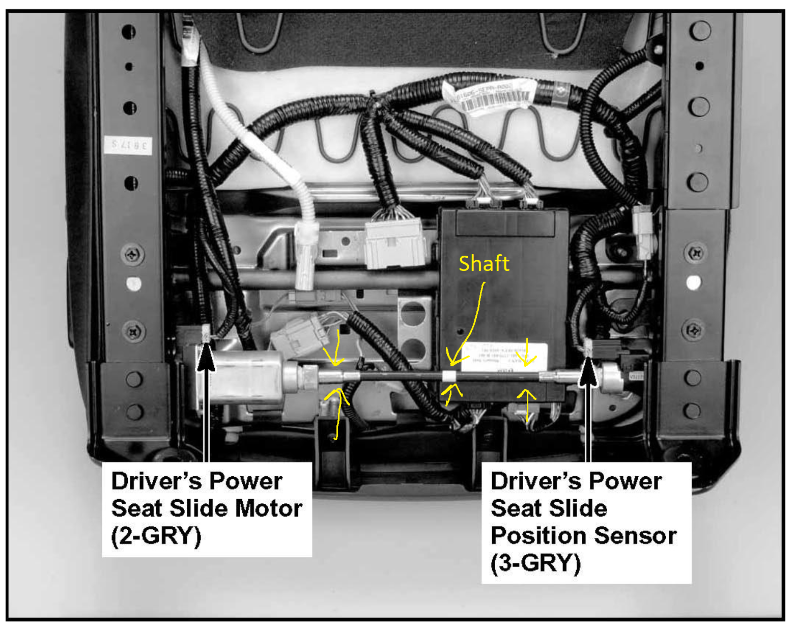

Hey guys, I'm currently having a problem with my powered seat where if I try moving forward, the driverseat ends up veering to the right (the left side is getting powered while the right side isnt.) I figured out that seat connecter was not properly installed, and that the wire itself was looking pretty worn out so I bought a new one. I got the new one in my hands now but I'm having a bit of a hard time installing it and was wondering if maybe anyone could give me some tips or advice on installing it. Big thanks.

There's only one motor for sliding function. It has shaft coming out of it that goes to the other rail. Maybe this shaft is broken? Or there's something wrong with the rail.
You can simply unbolt the seat. It's held by 4, maybe 14mm head bolts. Then you can swing the hole seat backward getting good access to underneath without disconnecting any wires.

Thanks, ill take a look tomorrow when I get home from work, and yeah its really the shaft im having a hard time installing.
