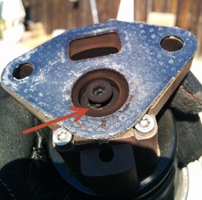

follow up to the thread. egr value had a dislodged carbon particle keeping it open. I cleaned it and let hope no more problems occur afterwards. I want to thank the community for their input and knowledge base. - Mod you can close out this thread.
gary_v advice pointed me to this page which helped :
https://acurazine.com/forums/problem...-p0404-694497/
what I found:
