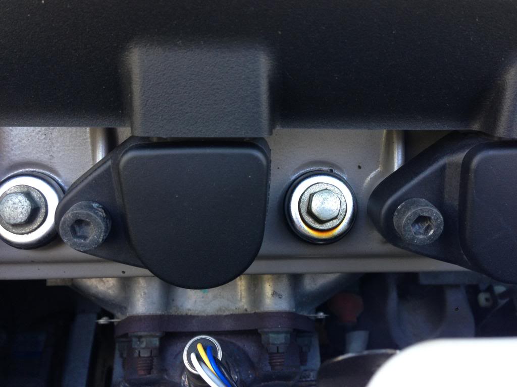

Thread jack! Just cause there is no point in me starting a new thread
Originally Posted by I hate cars
If it's not bad enough to drip and you don't have to add oil, it's probably not worth fixing. I had seals that showed the beginning of weeping when the car had 10,000 miles on it and 100,000 miles later are still barely damp, never a drip or even what I would call wet yet the dealer made it sound like I had this huge leak that had to be fixed right away.
I was cleaning my engine bay yesterday and came across a little leak, and not sure what I should do
I'm thinking that I either:
A. Ignore it
B. Change the washer and maybe bolt as well?
C. ?????

Looks to be hardly an issue at this point. I'd wipe it clean and watch it for a while. If it continues to leak, you could retorque the bolt, but be very careful!! It's very easy to snap those valve cover bolts. The torque spec is only 8.7 ft-lbs. If the bolt happens to bottom out before reaching 8.7 ft-lbs, stop!! You can also replace the bolt/washer assembly.
Thanks! Just wanted to make sure it wasn't an issue like "OMG YOUR ENGINE WILL ASPLODE!!!!" or something along those lines

Bringing this topic back on course since I have a slight oil leak. I see small spots on my garage floor but the dipstick level is good whenever I check it. I am suspecting the rear main seal might be the culprit. Has anyone tried stop leak products on the TL? I tried lucas in my prelude a couple years ago and IIRC it worked for the most part. Any input is appreciated, thanks.
http://www.lucasoil.com/products/dis...%20Stop%20Leak
