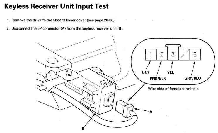

I need help finding instructions and diagrams on how to replace 2008 acura tl keyless entry receiver module, part number: 38385-sep-a01. I've looked over the interwebs and couldn't find anything. It could be my search skills suck.

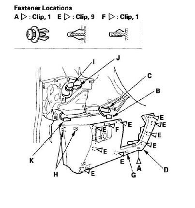

Get yourself the service manual:
https://acurazine.com/forums/3g-tl-p.../#post16101585
It's somewhere left from the radio / center console.

I recommend you unbolt the metal bracket and then un-clip it to make it easier. It's in a tight space.
