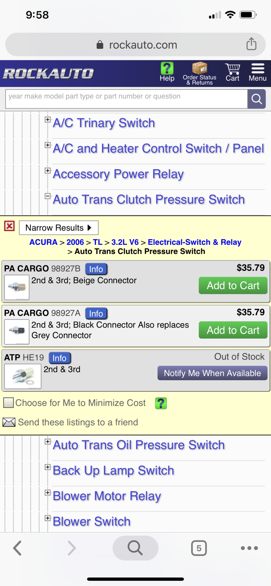

Posts: 4
Is it this part here?
Old Sep 19, 2019 | 02:29 PM
Posts: 48,312
https://acurazine.com/forums/third-g...2006-a-729149/
I'd recommend going OEM> DIY and parts list in master thread above.
