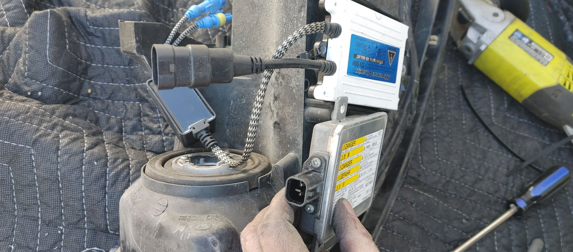

Old Mar 9, 2025 | 09:30 PM
blaze2051's Avatar
Joined: May 2015
Posts: 11
So I finally got a chance to troubleshoot the low beams today, the oem ballast were getting 12v, I did notice that if I disconnected the bulb and turn on the headlights it would make a crackling noise. I then disconnected the driver side ballast, and no more noise, but the passenger side still shutoff. I had these leds on my oem ballast for 1-2months without issues. I also noticed that while the headlights turned off, within 1mins, it smelled like burnt electronics. both headlights. I suspect that both ignitors are going bad, since i could turn them back on again after a fews seconds of them being off, I dont have to time to order new ignitors, and I do have spare aftermarket ballast and ignitors on hand so that went that route. So far aftermarket works fine.
