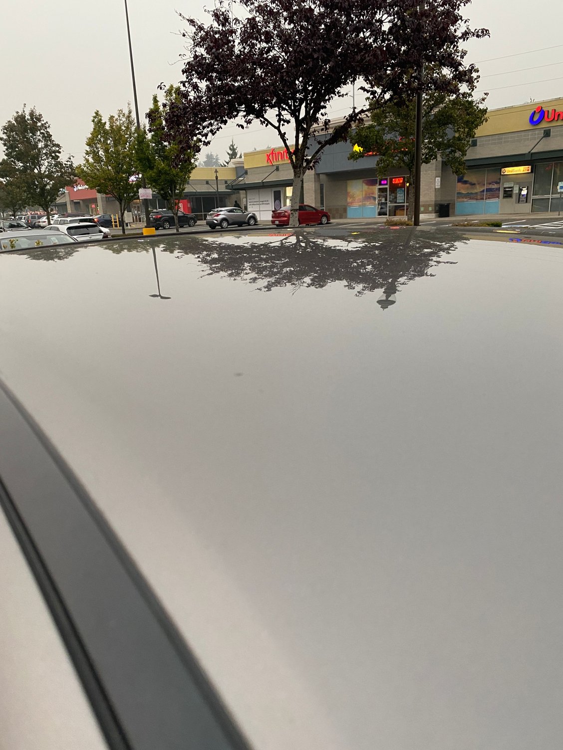

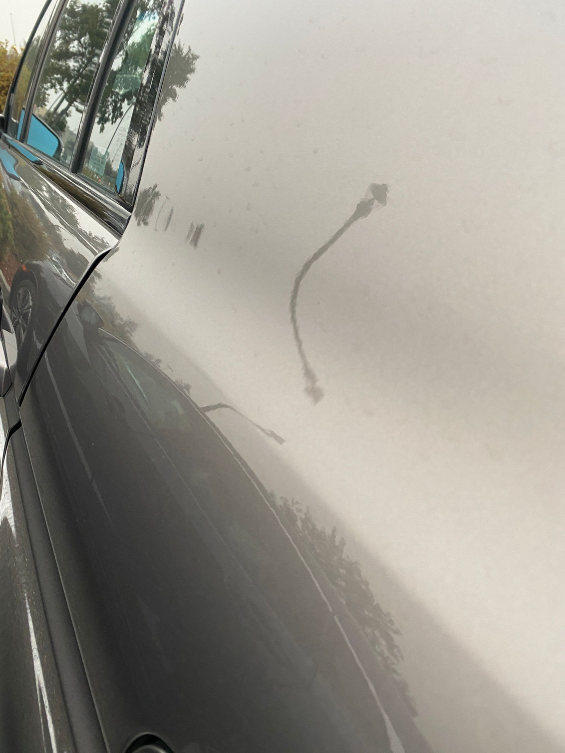

I tried cleaning tree sap of my car and used the green side of a kitchen sponge. I didn't think it would do this kind of damage fml...can I polish this out? I did some research and it seems only clear coat was damaged as the scratches aren't hard but really soft. The paint basically just lost its "gloss". Any help is appreciated

You could probably get away with doing a 2 step, compound and polish, with a DA and a cutting and polishing pad.
Some may be inclined to tell you about wet sanding.

I would try compound and polish to see if it can still come back, but it looks like you might have rubbed through the clear coat.

I could be buff out, but after that you will have minimal clear coat left.

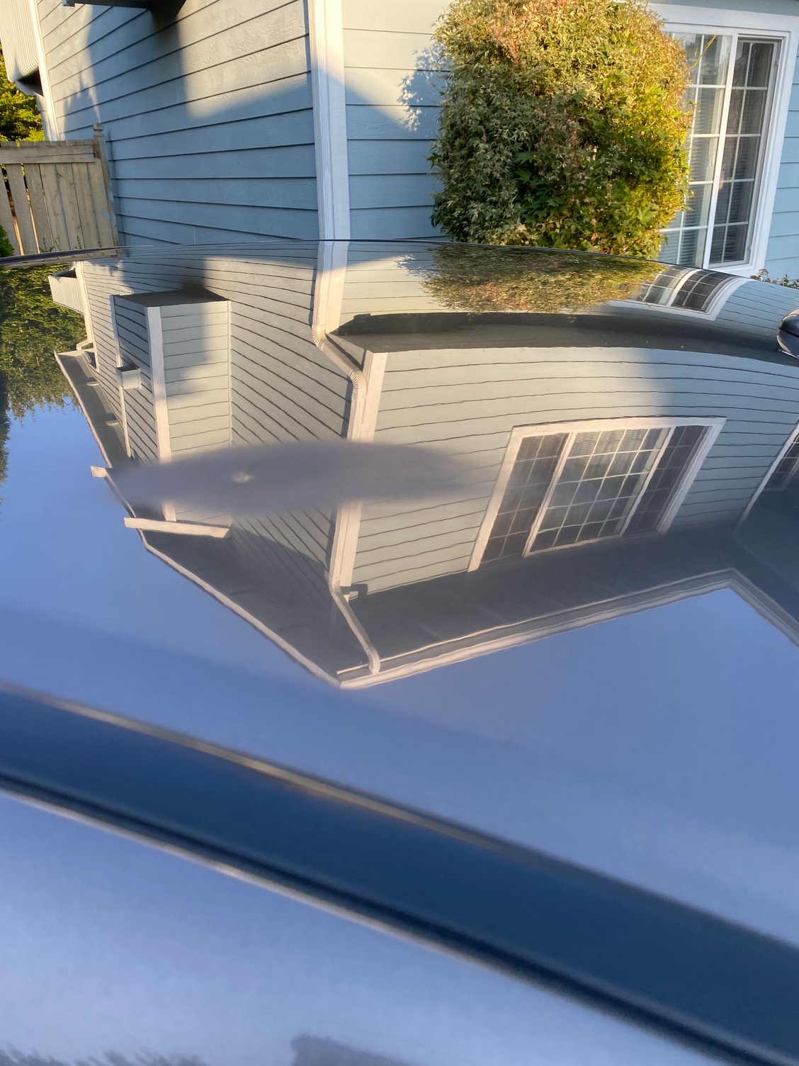

I fixed the scratches, just in case someone does what I did and wants to fix it: wet sanding with 1500 and then 3000 sandpaper and then buffing with compound. Scratches are completely gone.
Tried using some polish and meguiars scratch remover but those didn't help at all. The scratch remover masked the scratches slightly but that was it.

Done. Was going to do so, just needed to get to my computer. Doesn't even look like the same car lol, dang I'm surprised at the results looking at the pictures now...scratches are gone, looks like just a tiny spot left from the sap on the roof and even then barely noticeable.
