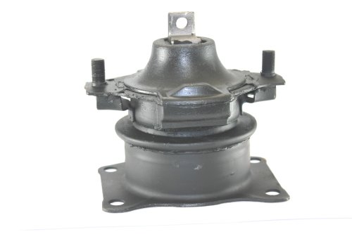

Old 07-03-2015, 03:11 PM
Life Connoisseur
MonkeyTrucker's Avatar
Join Date: Sep 2012
Posts: 715
Received 131 Likes on 96 Posts
Could you guys help me out a bit further, I've decided to do all the mounts, transmission and engine, whether needed or not. Passenger side is easy to ascertain the part. For the front and rear engine mounts, are you replacing an entire unit or just the rubber? Same for transmission mounts. Can anyone that's replaced their mounts identify what I need at the very least for the engine and transmission.
Are the front and rear engine mounts actually part #8 and #12 above? Again, #11 is easy to identify as the passenger mount, the others not so much. Are you replacing other pieces along with the rubber? Are #14 and #10 rubber too that should be replaced?
Are #15, #16, #17 the only pieces required to replace the transmission mounts? Should #18 be replaced as well?
Figured as good a time as any when I put on HFPC and a new J-Pipe in the coming weeks. I'll likely make a DIY, didn't see any in the garage for engine/transmission mounts. Becoming more relevant as our cars age.
How about those vacuum hoses, why, how, and what purpose do these play with mounts? Can't say I've seen vacuum hoses attached to mounts before, what is at work here?
Thanks in advance!
Picture and part #s came from this link.
Thanks in advance!
This is the front mount as an example:
http://ecx.images-amazon.com/images/I/31RFctNsDEL.jpg
If you google "[your year] acura tl front motor mount" you will get a bunch of results which will show you what the part is that you are replacing. Do that for all of the mounts to get an idea of the parts are.
There are three engine mounts (Front, passenger side, rear) and three transmission mounts (upper and two lower).
There are a number of great threads here that go over replacing the motor mounts which were very helpful. They include pictures and explanations of what you will have to remove to get to the mounts.
If you've decided to replace the mounts I would say your next decision is whether to replace them with OEM or after market such as XLR8 or Innovative mounts. I would google "XLR8 motor mount acurazine" and read through the numerous threads to help you decide which way to go. Hope this helps!

zubi23's Avatar

so front are more common than rear?

Originally Posted by zubi23
okay cool, I'll look up engine mounts on see if theres a DIY for it.
Anything else I should look into?
yup since the weight up front therefore it take a beating.

Anyone have advice on how to fix a slight thud/creaking in the rear of the car? The creaking sounds like its coming from the rear deck. I had all 3 motor mounts replaced about 2 months ago, as well as my compliance bushings. This fixed my front suspension tremendously, but the rear...when going over speed bumps, it's a little harsh
Depends what the problem is. Jack the back and try to turn your back wheels from side to side and see if they are solid or they move a little. Could be some component of the suspension but if it is that, you should be able, if your careful, to hear if the noise comes from the right or left side
Best way to diagnose is to take out the rear seat and the rear deck cover and have another person drive while you stick foam and hold/tap pieces to reproduce the rattle. Also it could be the springs if they need some slight lubrication. White lithium grease works well!
Also check your sway bar rear end links, the bushing mounts (these can be torn with a upgraded swaybar and require welding back on).
Also jack up the rear and look for excessive play in the rear wheels.
cust0mx (07-10-2015)

Okay I replaced the sway bar end links, and I still feel the "thud" everytime I go over a bump. I guess next up are those motor mounts.
I am going to mention that replacing the sway bar, the car feels better when turning, and hopefully I can do the motor mounts and my car will be like new. But first I have to fix my oil leak.
how were the sway bar bushings? Those cause a thump when the car twists if they are loose!
the end links are really easy to replace. Make sure you use tons of PB blaster. Use an allen key on the inside of the bolt and a cresent/box wrench on the bolt to undo it. You may need to apply heat to help it break free.

I just did the same thing and was trying to fix the vibration and thump. Ended up doing the front and side engine mount, upper transmission mount, both compliance bushing, new tires, and Tein drop. The car feels very good again, I just need to do the rear mount and it should be factory fresh again. Here is the kicker, everything was covered under my factory extended warranty so it helped the wallet out so i could do the drop and AME wheels/tires.
that's sweet! i wish i knew about these problems before I hit 100k miles.
