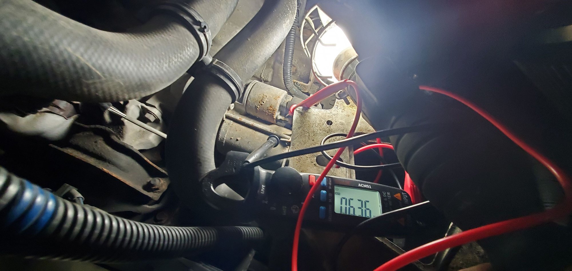

Ok finally had a chance to look things over. Retesting batt engine off I got 12.3v today. Started car ran ac heat ect ect retested batt held 14.1 to 14.3 depending on ac on or off. Watched carsNtoys youtube vid on Acura tl no start and tried to test starter solenoid. He was testing continuity on an "s" terminal on the solenoid and then other lead right on body of armature and he had continuity. My starter didn't seem to have the same "s" terminal. But In the same location mine had an s shaped metal connector behind the bolt so I tested from there and was not getting a beep, showing numbers does that mean I have a bad connection somewhere or bad starter solenoid? Will attach pics of my "s" terminal ect. Thanks!
My s terminal that i tested from.
Tried to check continuity of starter solenoid, open short or bad test location?
