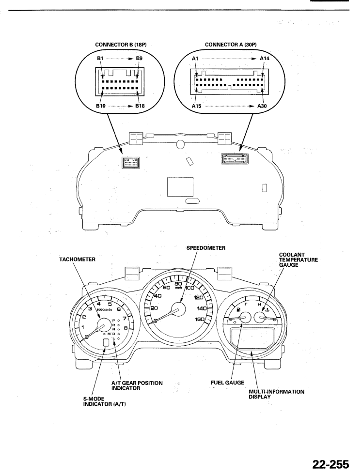

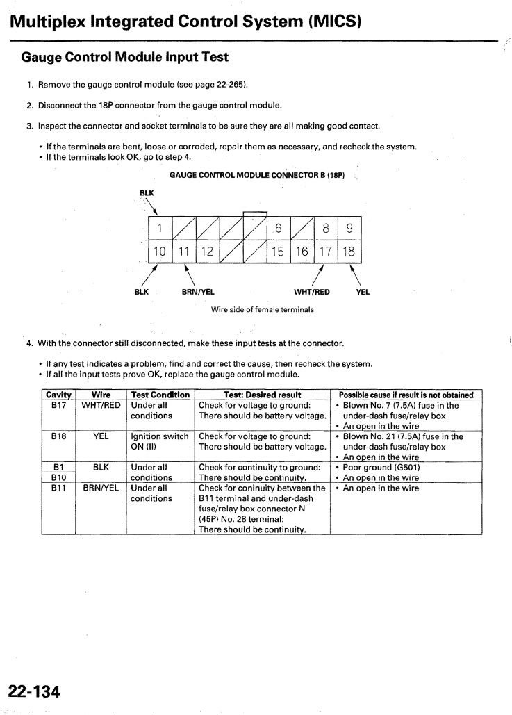

If you want to diagnose the problem yourself I would start by getting service manual. You will also need a multimeter and maybe a test light. Oh and basic tools to take interior apart.
And yes, installing radio or any other modifications might damaged the system. So is water dripping on MICU from clogged moon roof drain tube. So is many other things.
But if all of the interior lights went out at the same time, including radio and window switches, it's either
- Micu went bad - It's build-in to under dash fuse box
- Gauge cluster went bad
- Broken wire, badly shorted bulb, etc.
Powerful scanner, that can retrieve body codes, might be helpful to diagnose which part exactly went bad. Car might had set some codes. Not very likely, but if you happened to have access to one, check that first.
And why I say gauge cluster? Well
Here's very basic test for power and ground for gauge cluster. But I doubt any of those is bad.
Can't really find anything useful. Hard to test as Micu and Gauge cluster communicate with "B-Can" which is basically ones and zeros - multimeter will do no good here.
