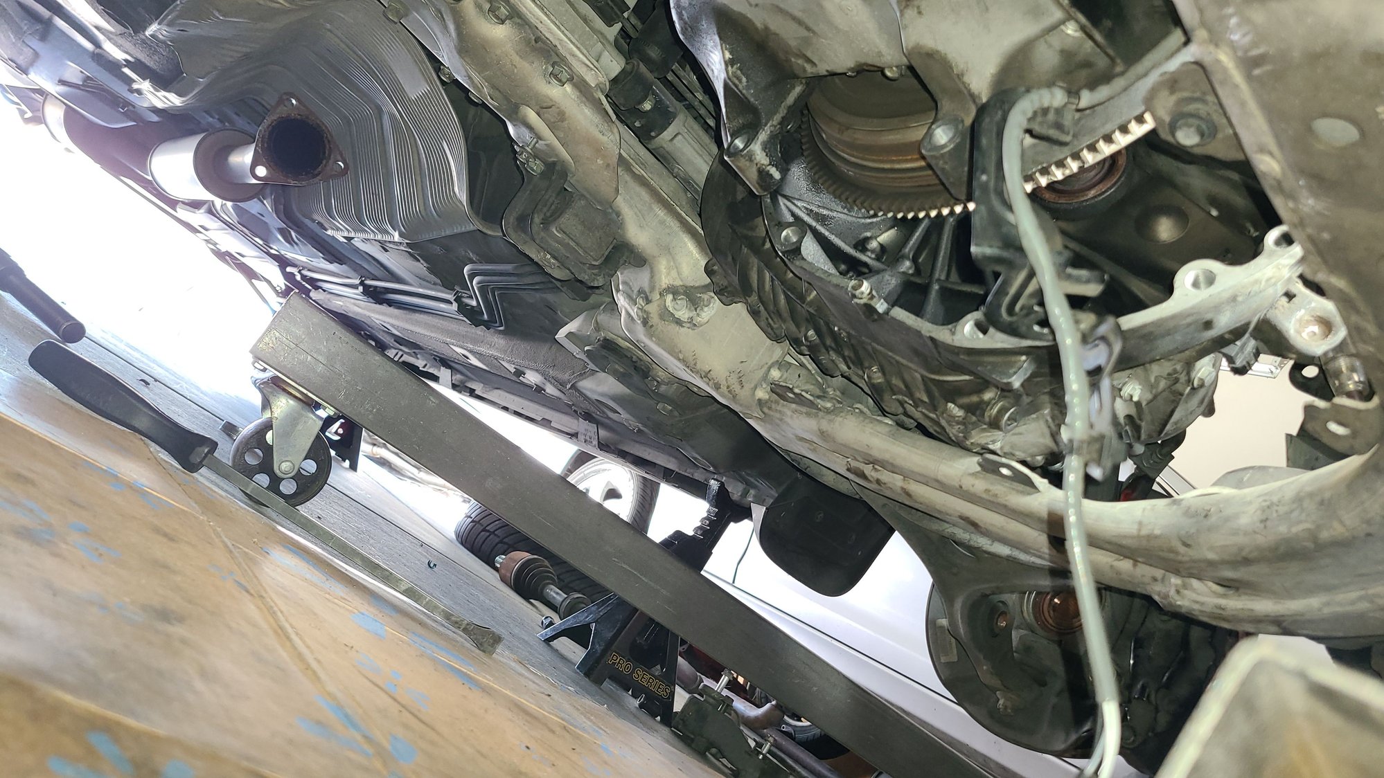

Originally Posted by Acura TL Builder
I would like to see a video of this done in 8.5 hours.
lol, its definitely not an easy job. especially if you dont have the 4 point eng brace and attachment.
Just a bit on me, former ASE certified technician with a degree in automotive technology. I have to say Gen 2 Acura's were way easier to work on.
Did a new Flywheel. plressure plate and clutch on CLS Type S in maybe 6hrs. Tried the no subframe removal this weekend on TLS type S and was able to remove, and place new clutch with some wrestling. But having such a hard time finding enough room to get the trans back in line...
To add to it, I'm doing this myself on jack stands not a lift. so, yeah its a pain.
subframe is still in
underside with subframe in

Cool to see someone else try the 'Brotha' method.
@Acura TL Builder I think has done at least two, maybe three now?

Going to do my third soon. Glad to see you trying the maneuver!
There are a few ways to tackle it. On way to line it up is to put in the alignment tool(after already cropping it). Then use the flywheel turner tool as you tighten the pressure plate to the flywheel utilizing the starter hole.
Tighten the bolts on the pressure plate, then completely tape off the area of the alignment tool, and cut it into two pieces. Then Carefully remove the masking tape and coverings. This is only if you aren’t able to get the main shaft out of the way of the pressure plate hole(which requires getting the tranny in the correct position.

I got a good tip from some machine shop guys at my work about lining the trans back up to the engine (AFTER I finished my clutch job ); use a couple pieces of threaded rod (maybe 2 pieces, ~4" in length, obviously metric thread) threaded into the engine block. Essentially using them as alignment studs.
