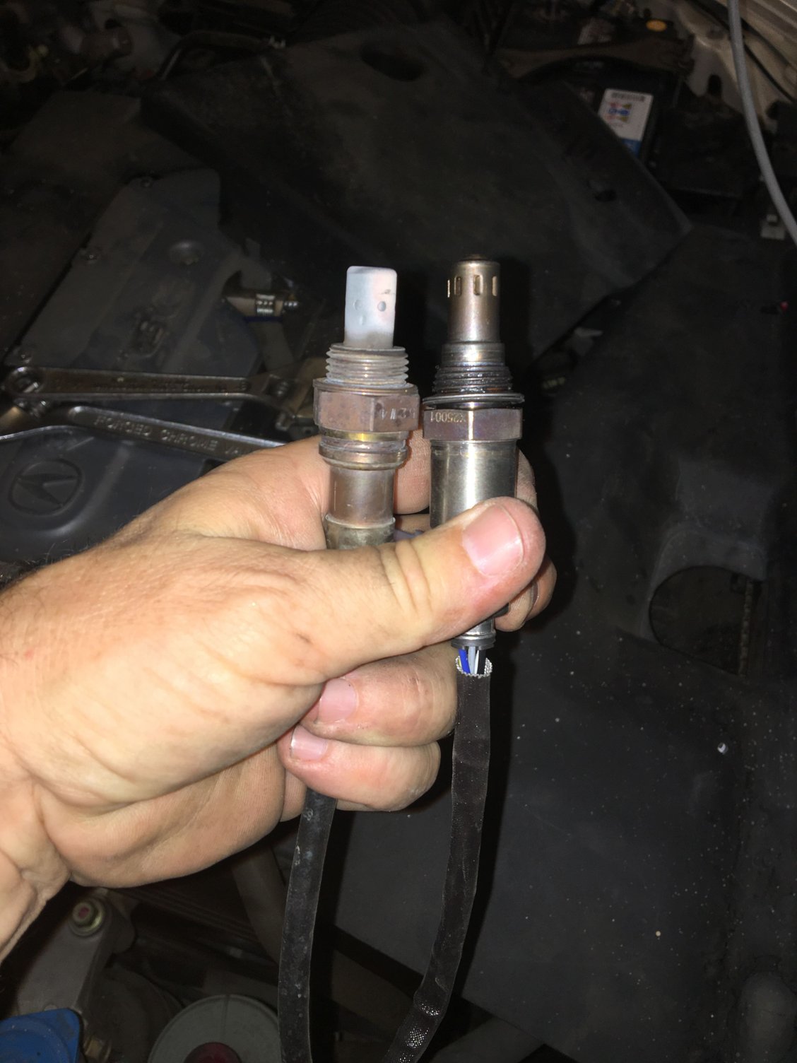

Old Jul 6, 2017 | 10:24 AM
TLalpogon's Avatar
5th Gear
Joined: Jun 2008
Posts: 5
Well the Chief auto dude said o2 sensor on right was the correct part, but they sure don't look the same. Made him go through everything in Acurazine even and double check on part for P2243 code it threw. Installed it anyway and so far 15 min of running and CEL light stayed off so I'll wait for engine to cool down and put everything back on then. Hope it's a win for DIY on our 05 TL with 115k miles!
