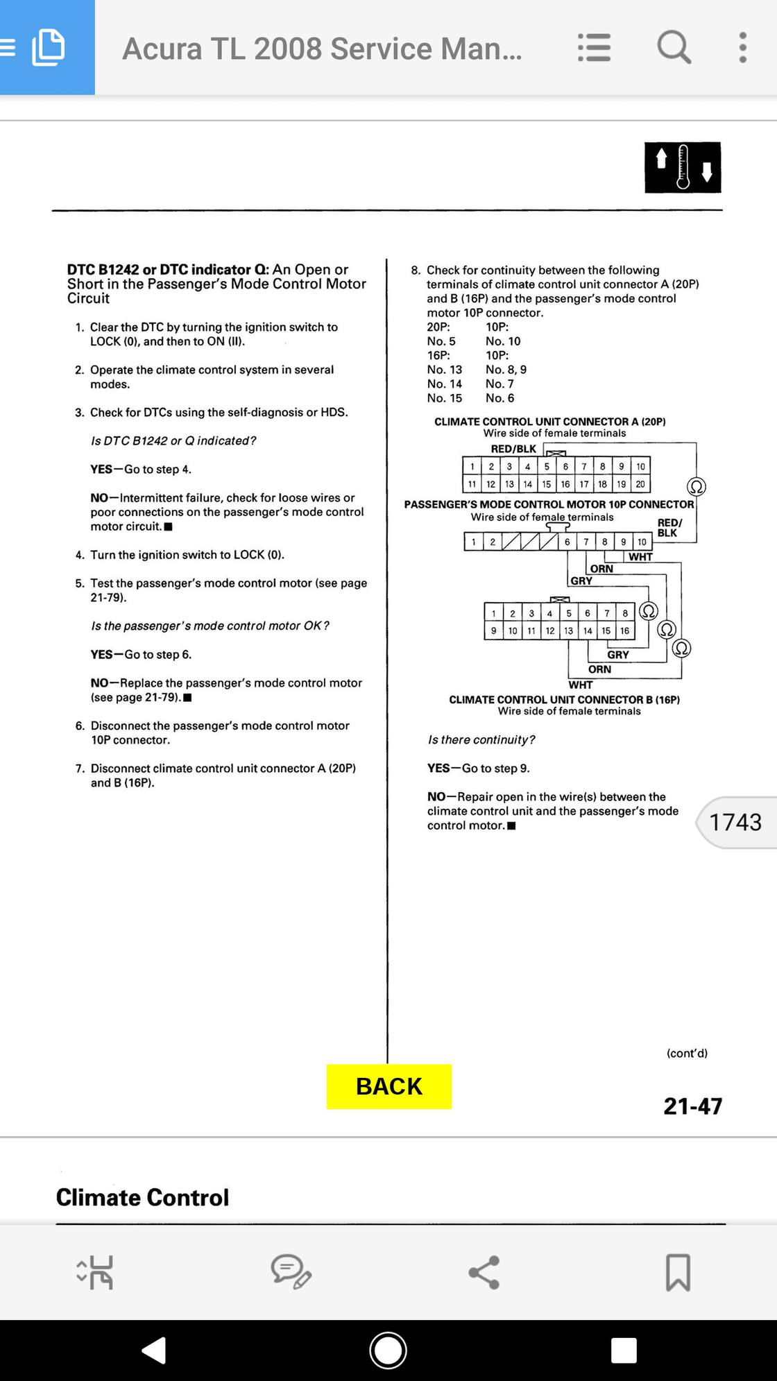

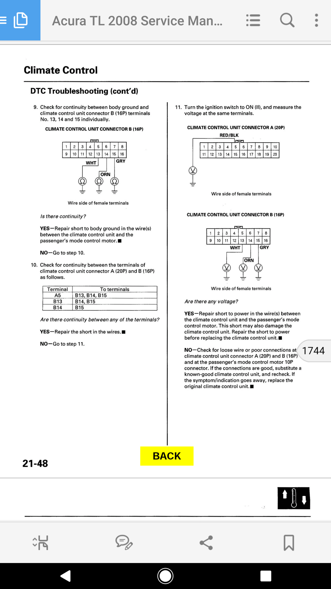

DTC (Temperature Indicator Segment)
Detection Item
A
An open in the in-car temperature sensor circuit
B
A short in the in-car temperature sensor circuit
C
An open in the outside air temperature sensor circuit
D
A short in the outside air temperature sensor circuit
E
An open in the sunlight sensor circuit
F
A short in the sunlight sensor circuit
G
An open in the evaporator temperature sensor circuit
H
A short in the evaporator temperature sensor circuit
I
An open in the driver's air mix control motor circuit
J
A short in the driver's air mix control motor circuit
K
A problem in the driver's air mix control linkage, door, or motor
L
An open in the passenger's air mix control motor circuit
M
A short in the passenger's air mix control motor circuit
N
A problem in the passenger's air mix control linkage, door, or motor
O
An open or short in the driver's mode control motor circuit
P
A problem in the driver's mode control linkage, doors, or motor
Q
An open or short in the passenger's mode control motor circuit
R
A problem in the passenger's mode control linkage, doors, or motor
S
A problem in the blower motor circuit
