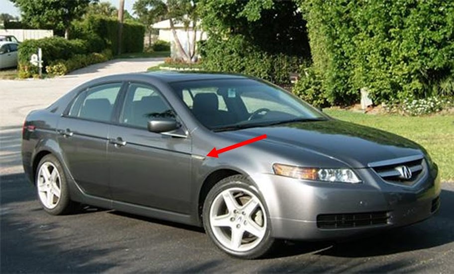

Hi All-
Can somebody tell me how to access this light. Is it accessed through the wheel well or does it pop out some how?
Old Nov 10, 2010 | 01:00 PM
it does pop out.
in order to do that, you have to go through the wheel well.

Ugh .. I hate those damn plastic clip thingies.
Is the bulb supposed to be "orange" or clear? (I cant see a tinted lens but maybe there is one on the back ?)
Old Nov 10, 2010 | 01:28 PM
the fronts are tinted, but the bulb is orange.
the rears are red, and the bulb is red.
Damn it- Guy sold me clear bulbs... Have to go back...
Thanks for the info !
Old Nov 10, 2010 | 02:05 PM
what kind of bulbs did you get? who sold you?
I think its a whole assembly. you have to buy the whole side marker.
thats what I did any way.

^^This. They are LED and need to be replaced as a unit, unless you want to DIY and cut them up to insert an LED module.
More good info :-)
The guy = AutoZone Or where ever I stopped the other night...
Old Nov 11, 2010 | 09:35 AM
^okay, dont listen to him.
its a whole assembly. called side markers.
you can go to ebay, and purchase OEM side markers or DEPO side markers.
I purchased DEPO, a little fitment issue, but nothing sand paper couldnt take care of.
