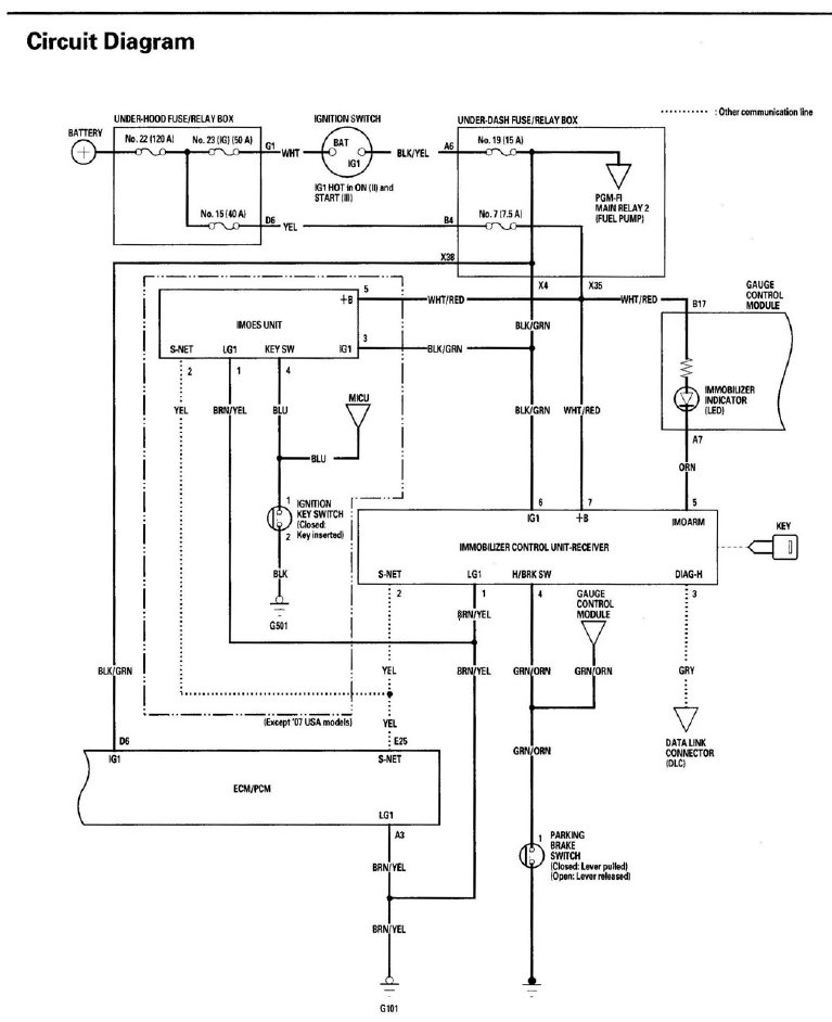

Of course you did check ALL fuses and they are ALL good, right? Take a second look at under-dash #7 (7.5A) and #19 (15A) and make sure that you have power on those fuses when ignition is ON (test light).

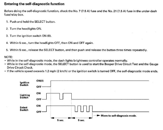

There is a possibility that LED just failed. Do the gauge test, this light should (not sure) come on during that test. Otherwise we will dig deeper into immobilizer schematics.

How about gauge cluster test?

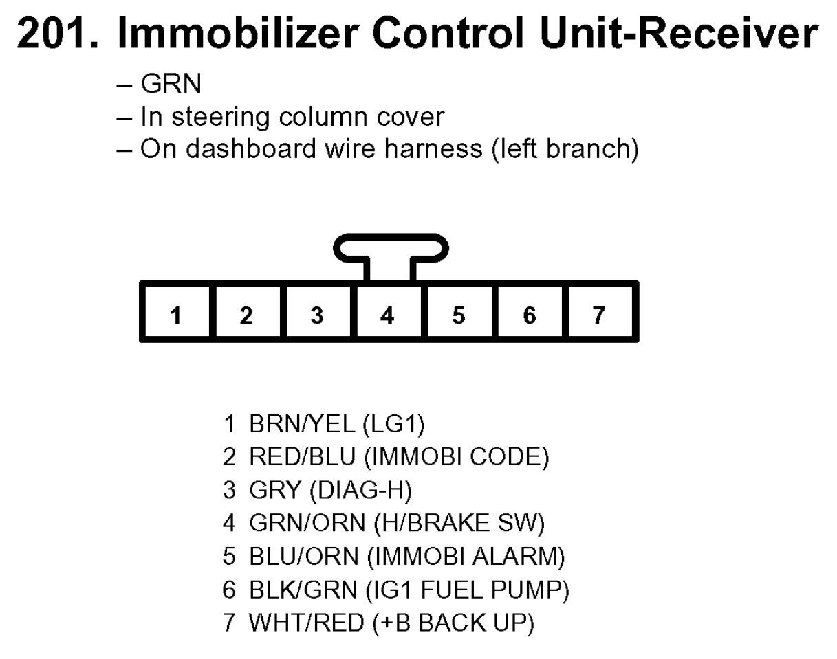

If you want to proceed with diagnostics of immobilizer then checking power and ground is second step. First step would be checking if there is communication with it, but you need good scan tool. Refer to the table and schematics from my previous posts. (IG1 and LG1 and +B)

Turns out there was no voltage between the 7 pin and the related fuse, all he did was remove and re-plug in the connector and presto, we have ignition!
A loose connection.
