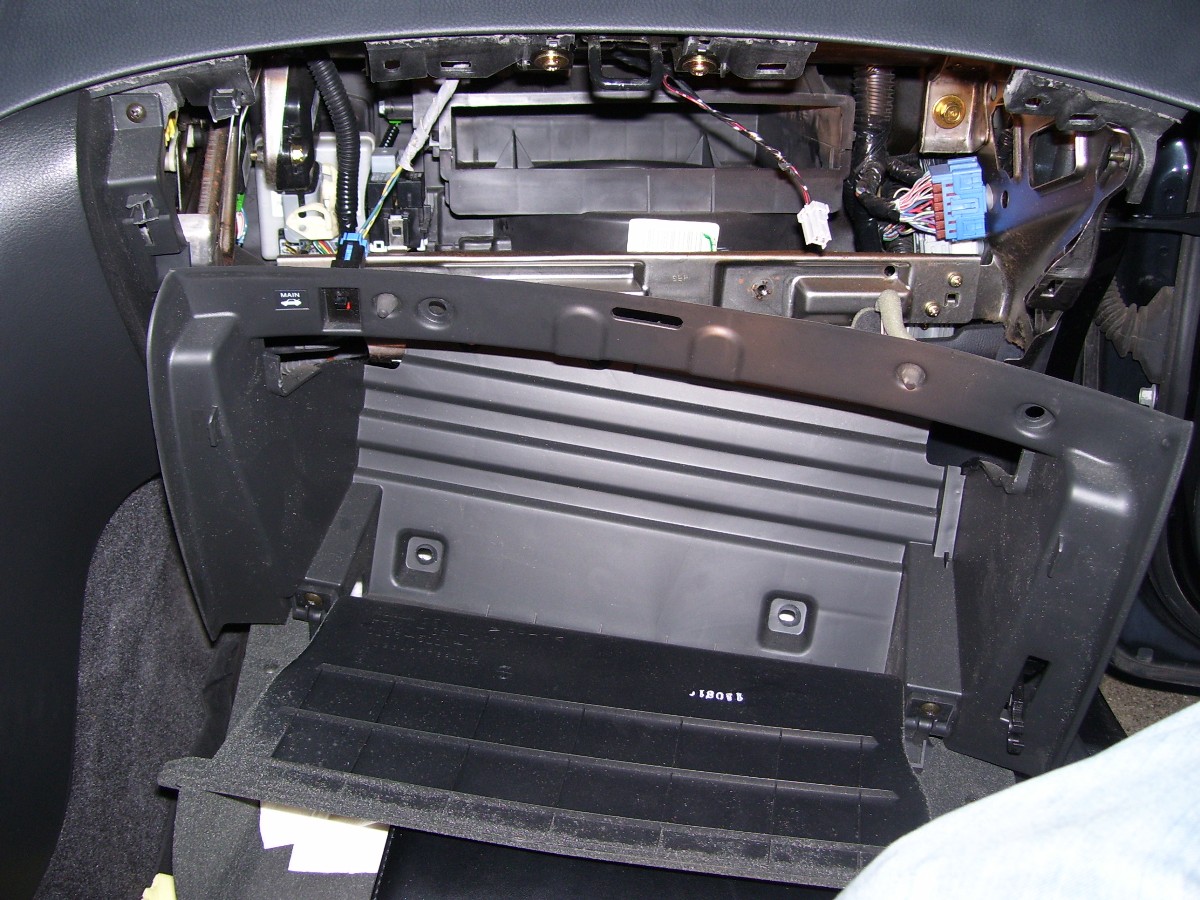

Agree. Probably needs changed anyway. Very easy to do. 10min job
I believe their is a youtube video on it.

^ If you're mechanically inclined, this job is a breeze. Just remember that when you get to the step where you have to pull the final piece off before you access the filter, there are two black clips.
To take of the one right, you need to push the center inward for the clip to free itself, then use a flat head or something to take it out.
The clip on the left has no center pin and can be taken out with some persuasion.
Also when you are putting everything back together. Make sure and get the bottom lined up first then make your way upward making sure every clip and tab are seated in their rightful place, then put the glove box on. There is a DIY in the garage. GL

Thanks so much! appriciate the feedback. I will search for the DIY...the video i saw for 06 didn't seem horrible..just seemed like it was easy to break those clips that you talked about.
