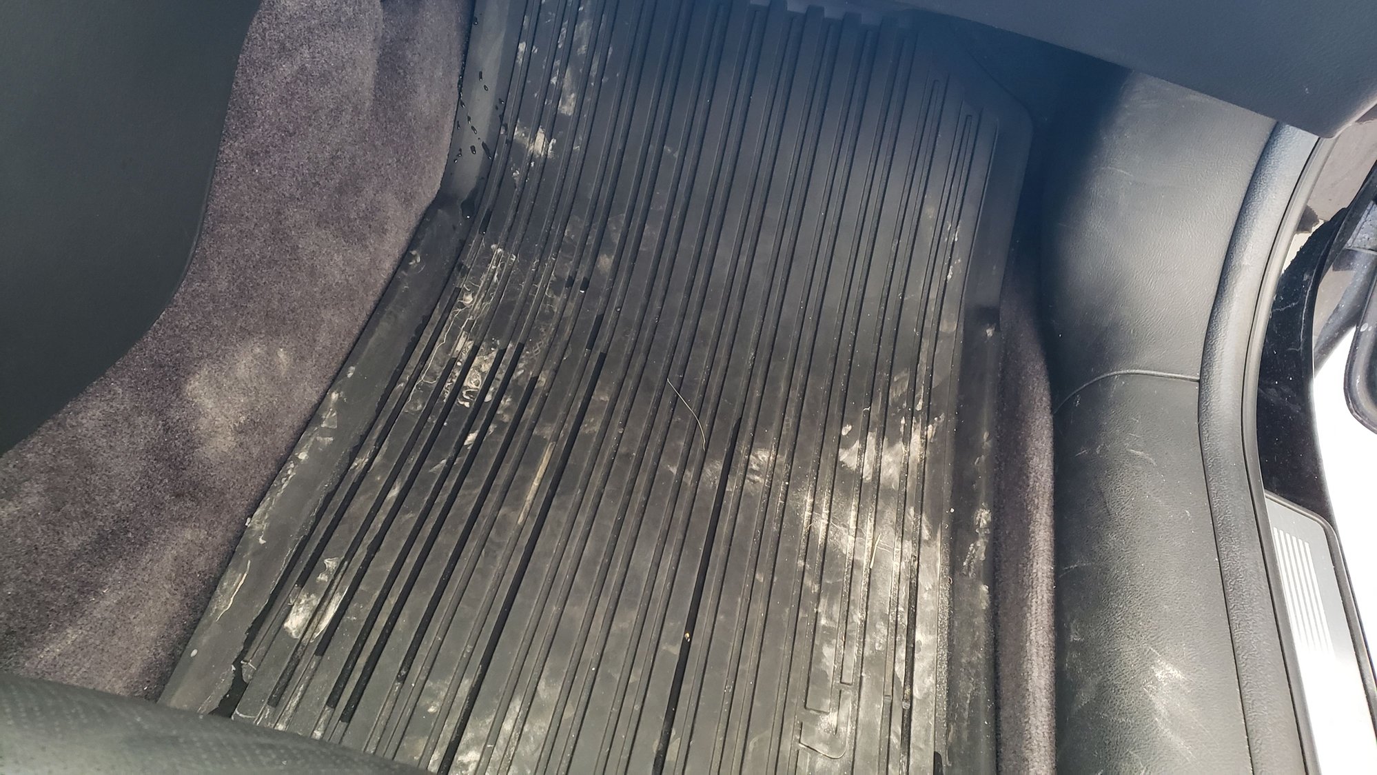

Hey guys! Back again lol. This 2007 TL, particularly on super hot and humid days, will leak water onto the passenger side floor. I had an import guy work on it all day yesterday. Camera up the tube, blow out the tub right there, no luck. I've included some pics if that helps. It's been doing it since I got it two years ago, no issues so far but I'd hate to fry my PCM over it. Not sure what to do, if anything, since I"m sure that whatever fix is involved will likely necessitate ripping out the whole dash.

Thank you for the diagram! Unfortunately, the leak is not connected with rain. I can trigger it, as long as it's hot and humid enough, by having the AC on with the amount of drop into the being directly correlated to how cold I have the AC set. So, I'm wondering if while installing the windshield they clogged another drain line? Though, I see on the diagram that there's only one drain line. That would indicate to me that something ahead of the drain line on my car is cracked or something. I will keep you guys updated. Idk why I always get the TL's with the strange and hard to figure out problems lmfao. Maybe my Evaporator Core is cracked or the hoses aren't properly connected or something? What's the ticket on replacing that? $1000? Is there anything else I should have done while the dash is ripped apart?
