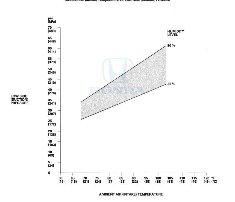

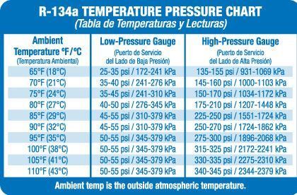

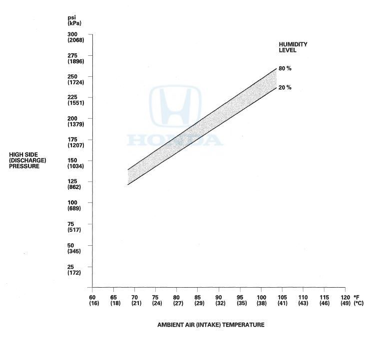

Try cleaning the condenser. It's a little tricky with the bumper cover in the way but you should be able to at lease rinse it off with a garden hose. Spray through the grill as best you can and if you're able to reach it or have a narrow brush, you can try to scrub it a bit. I've used one of those long narrow snow removal brushes that you stick in your trunk to wipe it down a bit. A little dishsoap may help with whatever buildup there is. If the condenser isn't adequately cooling the refrigerant, nothing else will matter. Also check that both of your fans are running at full speed with the AC is on.
When you're measuring temp with the thermometer, check to see if the compressor is continuously running. Open all windows, turn on outside air (not recirculate) and full fan/AC. If the compressor kicks off when the air isn't at least 45F, then I'd bet you have too much or too little refrigerant. It may kick off for just a moment, especially if the ambient temp isn't at least 85F or so. But it should be running most of the time and shouldn't be kicking off unless the temp falls around 45F or less. If the mechanic referenced a generic pressure table or graph when he refilled, he may have overfilled it. Honda AC systems seem to spec the AC system a bit lower than the generic spec sheet.
For example, if the ambient temp is 90F when the system is tested, most generic tables will tell you the low should be around 50psi and the high around 250-275psi. However, the Honda/Acura service manual states only 35 - 40psi for the low and about 175 - 200psi for the high.
When I measured mine last summer I filled it to the generic specs which resulted in the compressor continually kicking on and off due to the overfilled system, alternating between about 50F - 55F. That will happen if the pressure is too high to avoid damage to the compressor. Then I found the actual spec from Honda after which it blew at a steady 40F.
Generic Chart:
Honda service manual charts:
If you feel comfortable with it, you can purchase an AC manifold gauge set from somewhere like Harbor Freight and test it yourself. It's pretty easy with tutorials on Youtube. If not, and you've tried everything else, take it back to the mechanic and ask them to remeasure the pressure and assure it's at the Honda specs.
