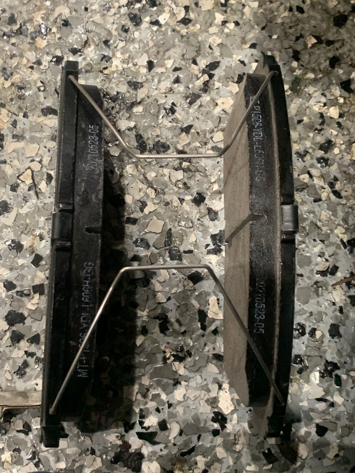

When the pads were replaced did the pad springs get replaced or even put back in? They help keep the brakes from sticking by applying outward pressure on the pads. If you’re unsure what I’m talking about they look like this.

Is it possible for brake pad springs to look different than that? I do not have OEM calipers. Pad springs are not mentioned anywhere on my maintenance records and I can't see any wires in the caliper assembly, but they could be obscured. I don't have the skill to take apart the caliper to get a better look.

I may have given you bad information. First the proper nomenclature is drag reduction clips. Second, the pads I just pulled off had these clips and the new ones came with them as well. But after reading your response it got me thinking that I don’t remember them being on my last TL. So I went and looked at the OEM IPB for the TL brakes and I don’t see them listed anywhere. Which more than likely means these are not put on factory brakes and are instead an aftermarket thing. So getting a set of pads like this that have drag reduction clips may help but its probably not the root cause of your issue. Sorry I couldn’t be of more help.

I appreciate your help. Like you said, drag reduction clips might help, and anything that can extend the time between calipers crapping themselves is fantastic. I'll see if I can get the all the calipers serviced, drag reduction clips installed, and all the rotors resurfaced. Maybe the rotors are all warped and have just been hammering the calipers the entire time. I've gone through far more calipers than brake pads- something's not right here.

My TL doesnt have any spring like this..
