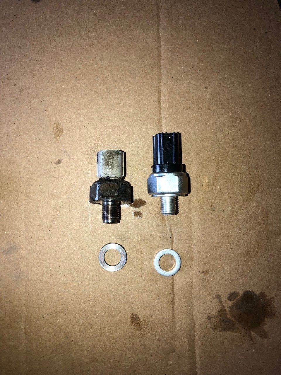

So, I just completed this today and now have a blinking green "D" light when I put the car in drive. Dangit, what did I use the wrong parts or something?There are tons of threads, regarding new and revised part numbers, so it got to be tad confusing. I used the following parts for replacement:
Third gear pressure switch: 28610-RKE-004
Fourth gear pressure switch: 28600-RKE-004
Here is the old third gear pressure switch (on left) with the new third gear pressure switch (on right):
Here is the old fourth gear pressure switch (on left) with the new fourth gear pressure switch (on right):
Does anyone have any advice on this? I only drove the car around the block and came right back. I am not going anywhere with it until I know what's going on. Any help would be appreciated.

I just took everything apart again and went through my steps. Me, being the stupid idiot I am, forgot to re-clip the top connector on the third gear pressure switch. Problem solved!
