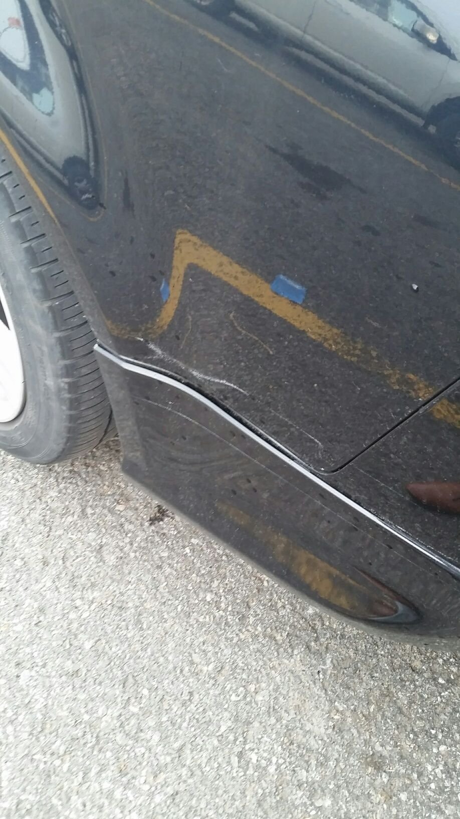

Just installed the A-spec kit on my car, i have a problem with the rear one... its not sticking on the sides where the double sided tape is... took it back to my mechanic and he added 1 inch wide tape there.... its better, but still not closing the gap.
I'm afraid dirt, snow, salt will accumulate there.
Any tricks to fix that? Crazy glue?

well maybe "ugly" is a bit strong... but I feel the mufflers now stick to far inside...
Anyhow, here's the pics of the gaps. They are on each side

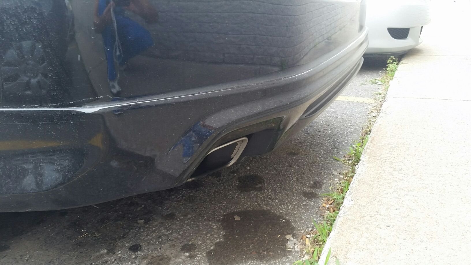

here I thought it was a huge gap
Picture of the exhaust
he has like 3 threads/post on the same subject.
each time, i tell him to use a sticky adhesive.
close that motherfucker up with sticky adhesive like 3M tape, OP!!!!!!!!!!!!!

I don't know what your mechanic used, but head to Canadian tire and buy 3M Automotive strength molding/mounting tape and make sure the area is cleaned well to ensure proper adhesion. If it's dirty and dusty, the 3M tape won't stick.
It will close up that small gap easily. Make sure you apply the tape along the very top of the A-Spec lip.

kit wasn't mounted properly, it's a tad to low (it should be level with the edge of the 1/4 panel). Remove the tape, clean the area and reapply 3M Tape 2-3 inches wide. Use the good tape that'll hold over 50 lbs!

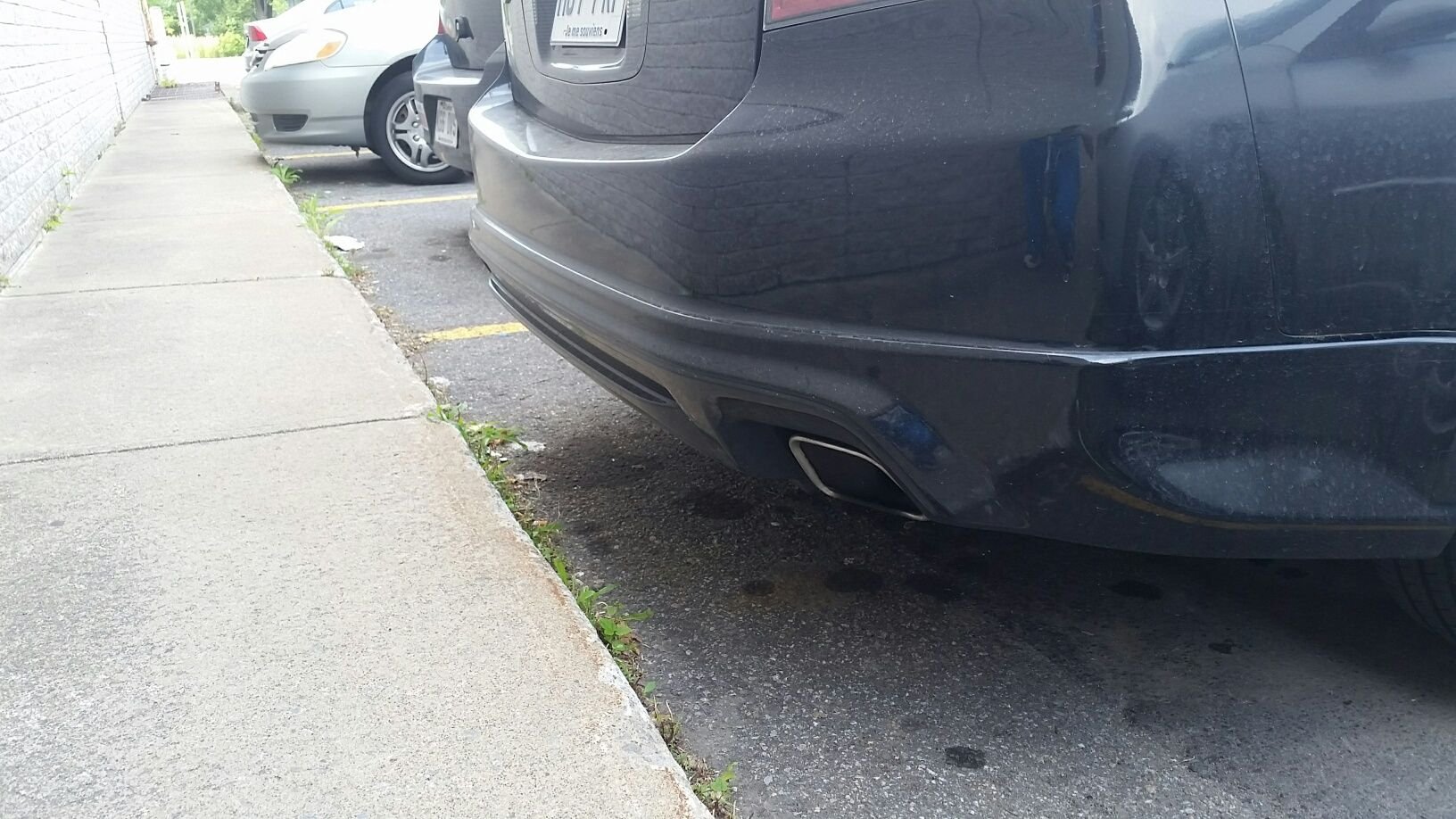

Here you go... sticks in too much IMO...
As for the gaps, i'll go get some good tape and do it myself next wkd... i think i'll need to switch mechanic while i'm at it.
You can get an exhaust shop to cut the tips off (or you can do it yourself) and just clamp on a pipe extension that's about an inch long. Many folks have done it here to fix the issue you have.

Ok the exhaust is sunk in. I agree you may need to get an exhaust shop to fix it. Maybe you can find some Socal tips and weld those on while you are at it?
Old Sep 1, 2015 | 12:13 PM
if stock exhaust and stock kit, it should be a spot on exact fit.
i personally think aspec kit is installed incorrectly, making exhaust tips seem like they are sunk in.
It is, the kit is angled so it's not sitting right where it attaches at the wheel-wells. It's dropped by 1/4 inch by the wheel-well from where it should be

I had the same gap issue. We just worked it far enough back to "3M that sum bitch" some more...
I also have the same exhaust tip issue. Mine look sunk in, too. I'll be doing new quad tips very soon to solve that issue.
