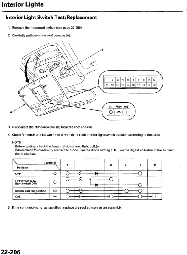

You mean you replaced the roof light switch/console?
Here's the test procedure for it, just for confirmation it's not the problem (unlucky I imagine, but could happen)

thoiboi - That was my plan but I just didn't know what terminals to check thanks to polobunny
