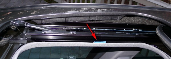

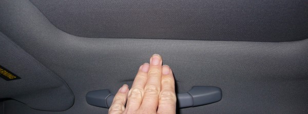

After a frustrating week, I have a little progress to report. First, here's the spot where I can press hard and stop the rattle (passenger side):

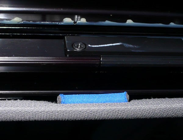

And here's where I jammed the foam rubber (old mouse pad) to try to stop it:
And a close up:
So, the good news is, I know exactly what to 'press' to stop the noise, but the foam rubber is not enough to completely stop it. I then tried to put foam rubber in other areas around the perimeter, but this just ended up making things worse - much worse.
So I'm stuck - I don't know how to fix this.
And a close up:

I noticed that if I push up from inside the car at either of the two front corners around the moonroof opening (the front-right corner being just in front of (to the left of) where my fingers are pressing up in the first picture above), I can cause quite a bit of squeaking. So that's where I tried adding more foam padding. But this caused the roof to squeak like hell over all manner of bumps, so I removed them all. It seems that the headliner will squeak/rattle at the slightest provocation. So at the moment, with just the one piece of foam in place as shown in the picture, the existing rattle is reduced. It still 'ticks' or 'slaps' or 'clicks' over moderate (not severe!) bumps, and only below 40mph, and it's always a 'single sound' - just one 'click', never a sequence.
