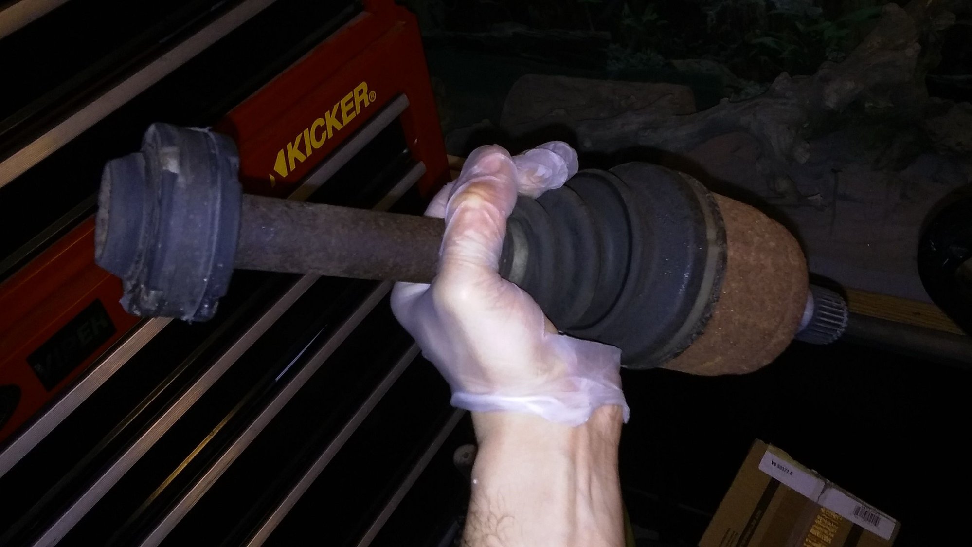

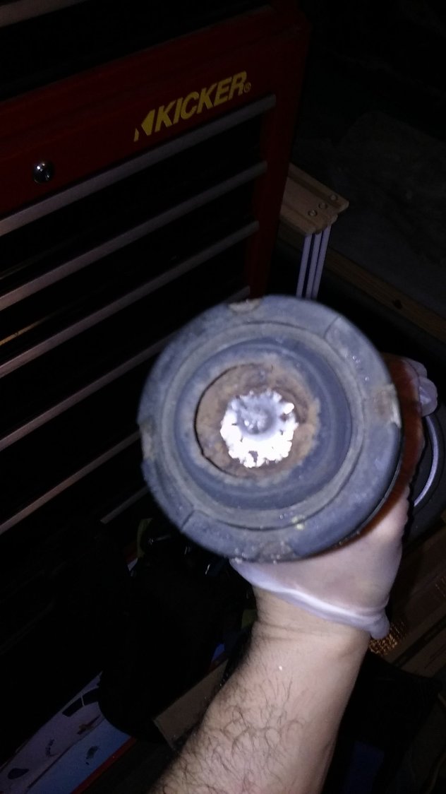

I floored it from a dead stop to make a light and the front driver side axle sheared off at the balancing bushing. I've seen plenty of half shafts break but always at the joint and never at 113k miles, always 200+. Just curious if it's an isolated case or know to happen. Makes me a little nervous about the others.

yes, its some what common for the TL, I guess they need a better material.

There have been a few threads recently with half shafts breaking at that same spot where the rubber balance piece is. I suppose some sand and water must be able to sit there and rot the axle
That axle looks a lot older than the miles you quote. If you're not the original owner, maybe the prior replaced it from a junkyard for a quick fix from a TL with much more mileage?
I bought the car with a salvage title, it had front end damage and was repaired so its very possible that it was a junkyard axle now that you mention it.
