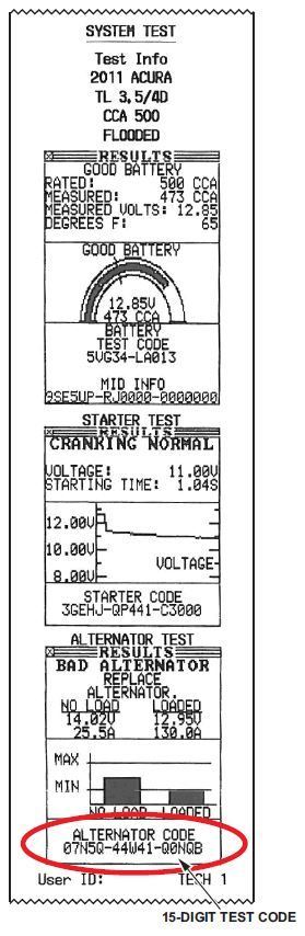

Most of the shops offer testing. Be prepared to pay something around $20. You should get printout similar to this one:
It tests for voltage, charging current, it should be able to determine if any of the diodes are short or open, etc.
Maybe it was defective battery? Sometimes they sit on shelves for years, and shop just slaps new sticker on it.
