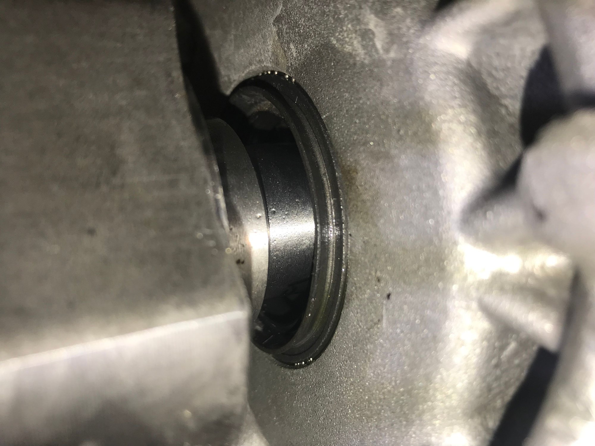

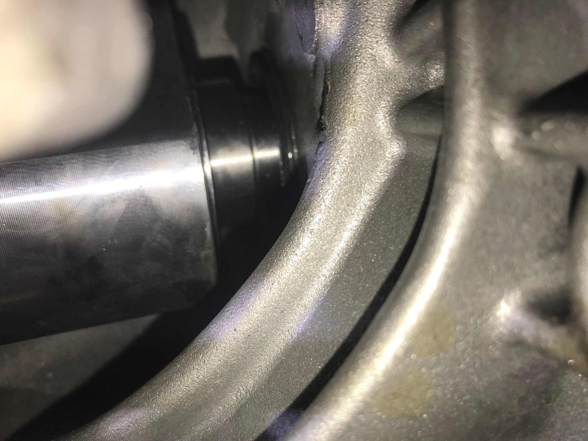

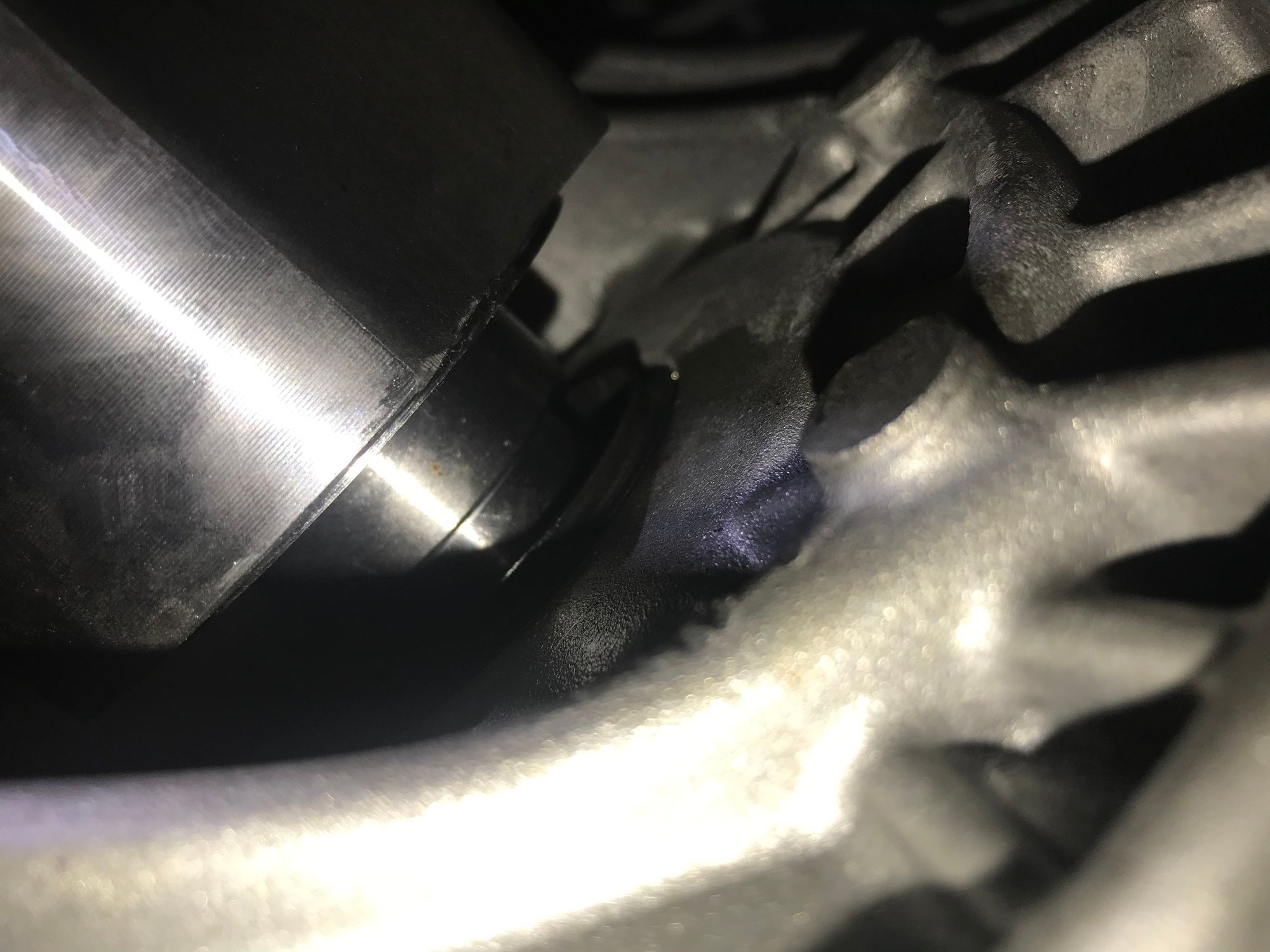

Update:
Finally got the baby down for a nap and had the chance to go out, get the car on stands and take a better look. It did indeed pop out. From the angle I saw it looked good but if you looked from the bottom you could see that it was out just enough. I will be getting the car back on stands tomorrow after work to pull the axle back out and make sure there was no damage done.
As for 5th gear, I am not locked out. I have to be really slow and gentle when going into it because it skips over and goes to the reverse side which is why of course I couldn’t go up.
