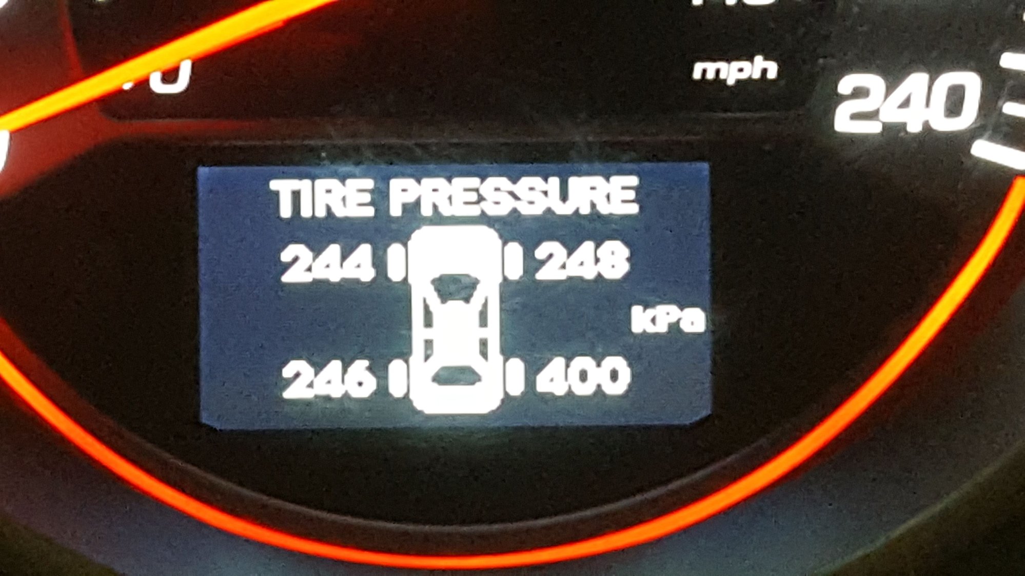

Have a 2008 TL-S original wheels and tires size on it. Driving along the highway I was presented with a TPMS System Error warning in the cluster display. Went into the TPMS menu to display pressures and for each wheel is just displayed (--) see attached for photos. Seems like others have had issues as well but no one seems to post the final repair.

Right rear TPMS sensor is faulty.
scanned it this morning fault code came up right away.

Your MID is showing that afterall. I thought you said it would show TPMS light immediately? in which case you wouldnt see any of the readings.
Your front tires should have ~10 more kPa than the rear

Correct, so in order to get pressures back on MID I had to erase all DTC codes from tpms control unit. Replaced the one sensor performed teach in of new sensor. Everything working as it should once again.
